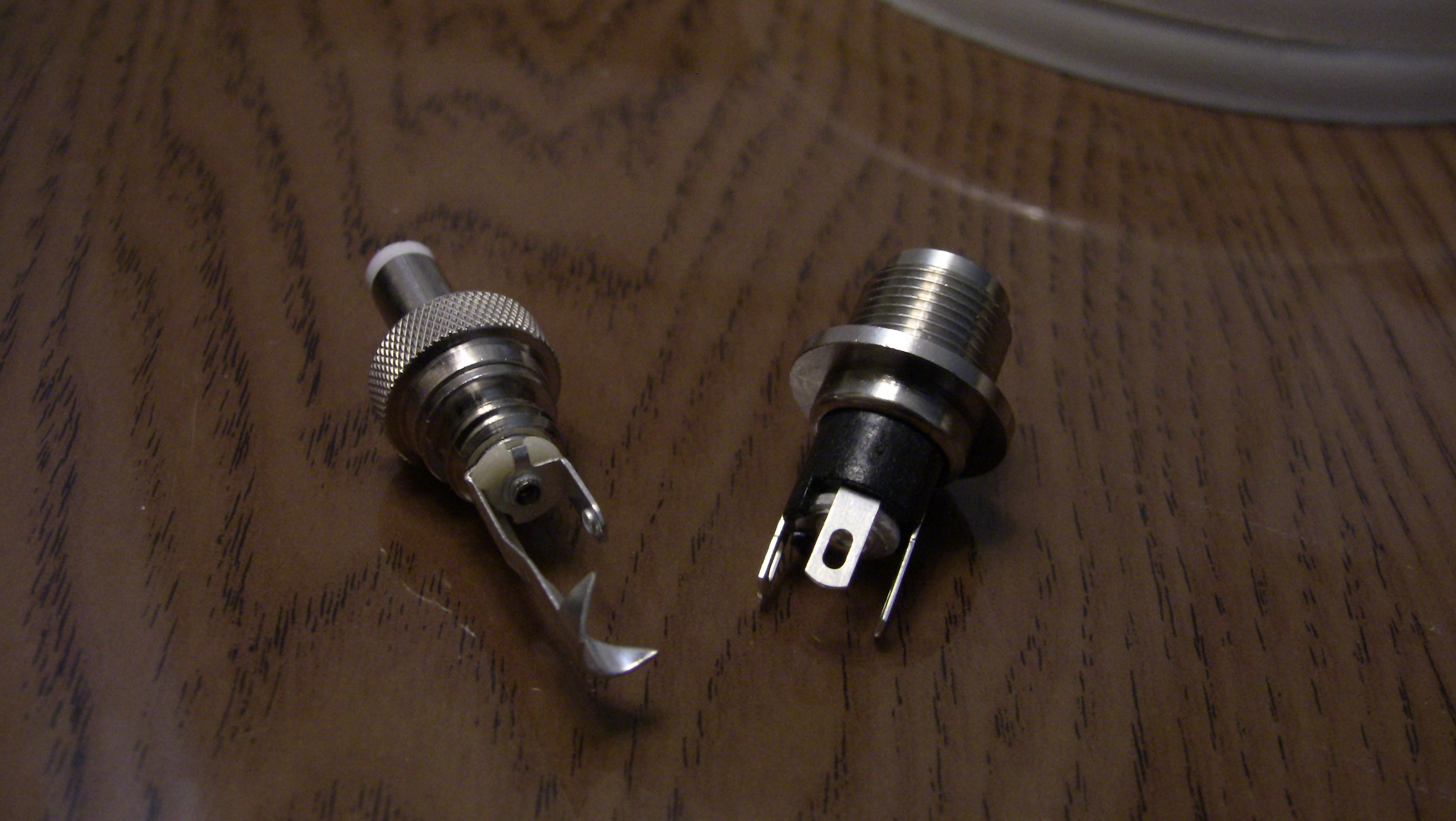

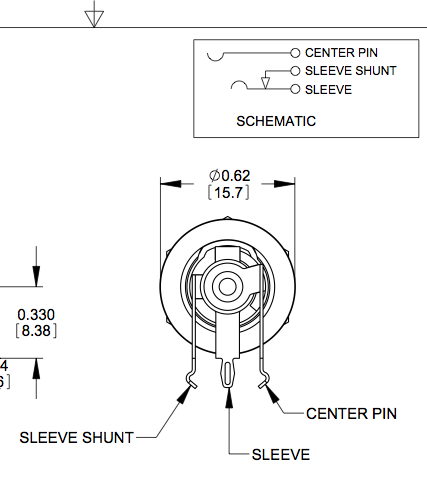

Okay, I received my components in the mail, however, I need to confirm how to hook my positive/negative connections to them and also how to crimp the terminals.
Attached is a photo, and also a cut out of the L722AS datasheet.
For the L722AS (female end), I'm assuming from the datasheet the "sleeve Shunt and sleeve" are connected together, so if I want that to be my negative connection, I just connect both of those together, and the positive connection to the "center pin" ?
As for the male end, I'm just not 100% how you are suppose to secure your wire you attach to it...either by crimping the metal part or doing something else?
In a nut shell, I just need help figuring out how to hook up the positive/negative wires to these two components properly.

I forget (and I frankly don't have the interest at this point to go back and re-read this humungous thread): did you want this connector to switch something in your circuit?
Because if not, then just forget about the "shunt" connector and connect your negative terminal to the sleeve.
If you want something to be disconnected, then use the "shunt" connector as a switch (normally-closed).
Regarding the connector terminals, what you got there, good buddy, are good old solder terminals. Time to fire up your soldering iron. Crimping ain't gonna do it. (You may use that crimp-able tab on the plug sleeve to wrap around the cable to secure it, but you definitely need to solder the wires to the terminals.)
