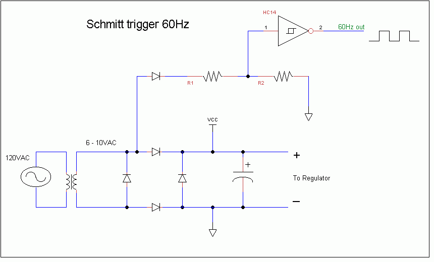

60 Hz zero-crossing detector
Lamct, attached is a basic circuit for getting a 60Hz square wave off the secondary of your power supply transformer. Technically, it's not a true zero-crossing detector, since the nominal switching point of the 74HC14 will be 2.5V with a 5V supply. However, the schmitt trigger will switch at the same point in every 60Hz cycle, and that's what matters if you're just using the output as a timing source. (True zero-crossing detectors usually operate off the AC mains and are used to switch triacs or scrs when no current is flowing).
Notice that you feed the schmitt trigger with a half-wave rectified, NON-filtered waveform that has been scaled down by the resistor divider. The total resistance of R1 + R2 is not critical and can be between 10K - 100K. Pick the divider ratio to keep the peak input voltage to the 74HC14 under the 5V supply rail. The schmitt trigger's output frequency will be 50 or 60Hz, depending on your AC system, but the duty cycle will not be 50%. Again, this shouldn't matter if you're just using the output as a timing source. The 74HC14 could be replaced by a comparator like the 311 as long as you add in some hysteresis circuitry.
- CAL

Laroche, those are some fine ideas you presented. However, your diode bridge is smoke waiting to happen. You swapped the GND and the low side of the secondary connections. I'm sure it's a typo (drawo?).
Good eye Ron, i thought there was something odd about it.
Thanks for the good eye, Ron. I felt queasy about posting that so quickly, and I played with the diodes more than once (I'm going to modify TinyCad to include the standard diagonal 4-diode bridge). I'm new to the board and this is the second good mistake I've made in two days. Mechie caught the last one and had the good grace to fix it. They don't call us "novices" for nothing!
It just proves every reader should go through the logic of posted solutions, and decide whether or not they work. Thinking for yourself is a good thing...
- CAL
