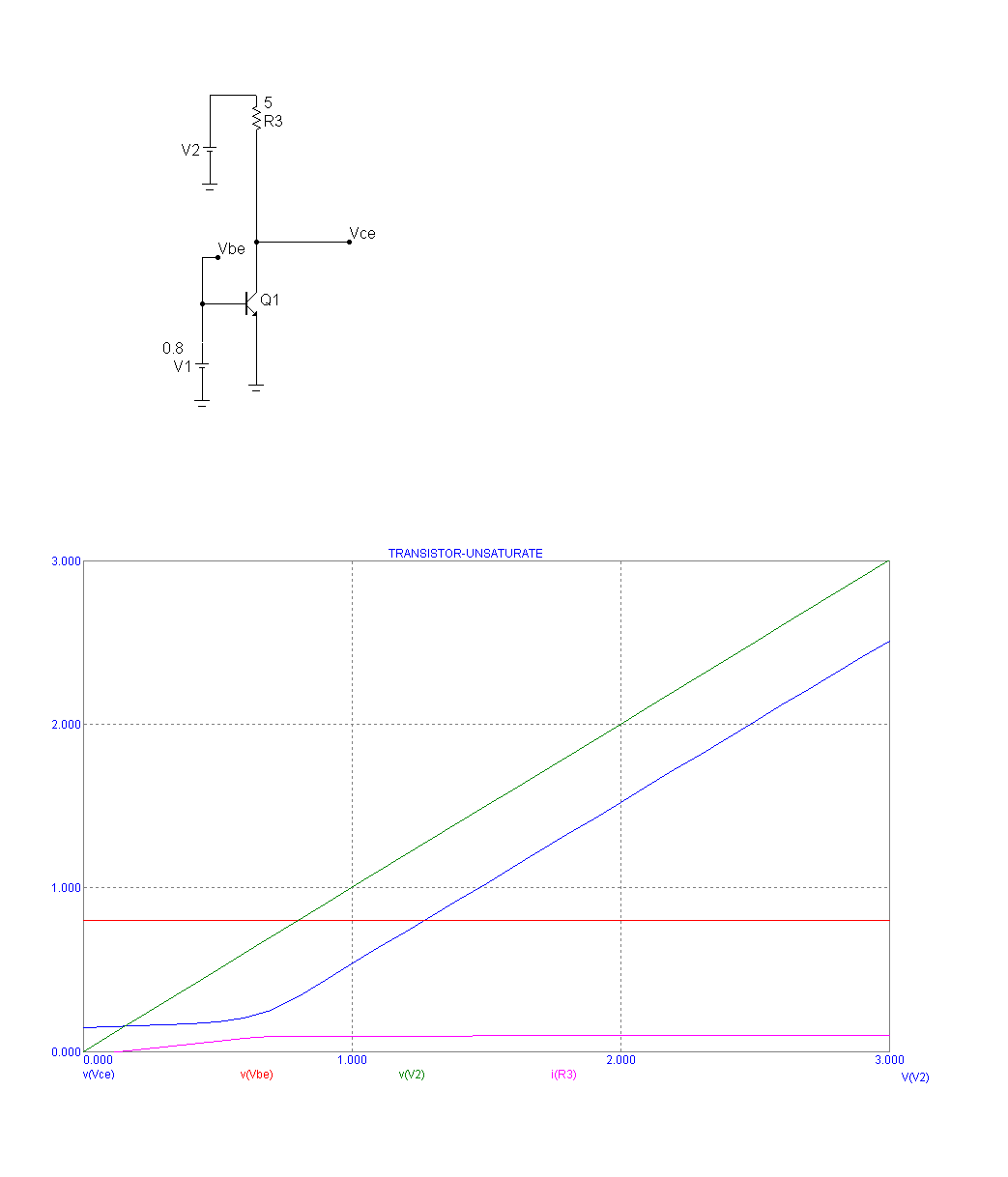

Here's an illustration of how the transistor works in that oscillator boost circuit. In this circuit we test the theory by increasing collector current until something gives. Note we dont even have to think about the oscillator circuit anymore, just pay attention to what is happening to the transistor while the collector current is rising.
Note that blue is the collector emitter voltage, red is base emitter voltage (constant) violet is the current through the collector resistor R3, green is simply the supply voltage.
We increase the supply voltage and watch what happens as the collector voltage rises.
At first, Vce stays low, a few tenths of a volt, which is typical for a bipolar in saturation as the collector current rises a little. Vce rises too but only a little before the knee.
Now as we approach the knee, the Vce starts to rise more sharply, until it rises quite a bit and this is where it comes out of saturation. Note after the knee Vce rises following V2 (the supply voltage). Note this change is gradual, however with an inductor in place of R3 this change is more abrupt, and so the voltage rises more sharply.
So it's the collector current that causes the transistor to pull out of saturation and that circuit shows that this is of course what happens.

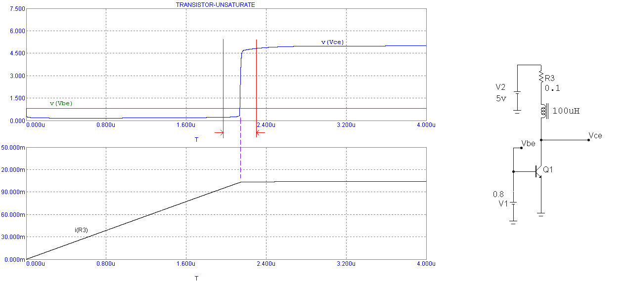

This next circuit is the same as the circuit in my previous post, only this time i've replaced the collector resistor with an inductor with series resistance equal to 0.1 ohms (R3) as shown in the attached diagram. The source voltage (V2) is now fixed at +5vdc.
We concentrate on the region between the two red arrows as on the diagram. Note how the current levels off AFTER the transistor comes out of saturation (see dashed violet line indicating time sync), and note how fast the transistor comes out of sat using an inductor with low esr, and note that that speed happens even with a linear inductor (L1) while in practice it might be even faster as the inductor goes into saturation. Note however that the inductor doesnt really even have to enter saturation, it just has to have low esr.
Also note that again we are driving the transistor with a fixed Vbe.
The sequence of events for this experiment is as follows:
Turn V1 on and wait for it to stabilize, then later turn on V2. Note the time it takes for the transistor to pull out of saturation after V2 is turned on (about 2.2us).
This clearly illustrates the control of the transistor using the collector current, not Vbe or related.
The plot had me scratching my head because the x and y axes were not labeled. However, I understand what you are try to aver.
Again, the back voltage of the coil is preventing the V2 voltage from reaching the collector, so the transistor stays in saturation because it has no c-b reverse bias. When the coil's back voltage lowers enough, more voltage is applied to the collector and brings the transistor out of saturation. The increase in current did not break the saturation, the establishment of a c-b reverse bias did.
The y-axis are not labeled, and the numbers in the y-axis are cut off. Does 30.000m mean milliamps or microamps? Does u mean microseconds in the x-axis? Why is the i(R3) curve so straight at the beginning? It should show a exponential charge curve with a L/R time constant. Better check your plotting program.
The y-axis are not labeled, and the numbers in the y-axis are cut off. Does 30.000m mean milliamps or microamps? Does u mean microseconds in the x-axis? Why is the i(R3) curve so straight at the beginning? It should show a expontential charge curve with a L/R time constant. Better check your plotting program.
Ratch
Hello again,
You can not get an increase in Vcb without more current through the coil!
30.000m means milliamps, 3u means microunits, and these are electrical standards.
3u on the plot x axis (time) stands for 3 microseconds.
i(R3) is exponential but if you knew what was happening here you would realize that
'exponential' has a relatively constant increase toward the beginning. You seem to
put your own 'knowledge' higher than the $2000 dollar circuit simulator. At the
very least, you should investigate.
The back voltage of the coil decreases but only as the transistor comes out of saturation.
You need to look at the simulation to see that. The voltage across Vce does not simply
appear for no reason at all, and the coil voltage does not fall for no reason at all, and we
can keep the coil voltage higher if we bias the transistor harder. That's how we can get
more output too.
When the current increases then and only then does the Vce rise.
