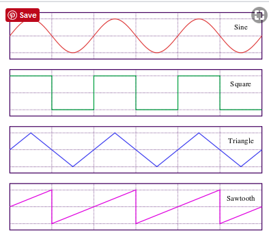

Gary,
There are several ways to achieve electronic oscillations: some that require an LC circuit and some that don't.
Typically, these oscillations are divided into 4 general "shape" categories, as indicated.
An LC circuit is required to produce an analog Sine Wave (digitally produced sine waves do not). As the frequency desired is increased, the actual physical size of the "L" (inductor) and the "C" (capacitor) decreases (as a rule). At GHz ranges of oscillations, the L component is quite small and may even appear as no bigger that a single conductor trace (on PCBs), as JimB noted above. And the C component is, of course, equally small.
In this case of cell phone usage, less transmission power is required for successful communication because transmission distances are quite short (nearest "tower", i.e., generally "line-of-sight comms). This also allows for significant reductions in component sizing, particularly with capacitors.
As for the other wave shapes, you can google them for the various methods for producing those shapes, if you choose. They are not, as a rule, used as a carrier wave in radio transmission(s).

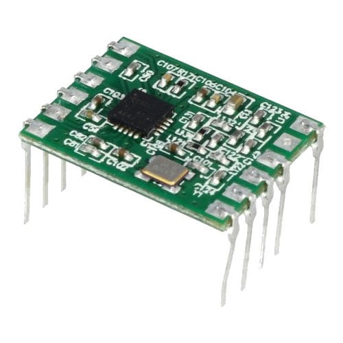

I did a design for Silicon Labs. (cell phone IC) My part was to make the phone pick up FM radio. This IC is what we used. I put a FM band pass simple filter on the input but after that it was all software. There is a number of ICs that are exactly the same but only the program is different. You can program it for AM or short wave or FM stereo. The DSP inside has software filters. It is hard to think of decoding stereo using software.
Inside there are two micros. The 50mips 8051 is used to talk the knobs and do I/O. There is a very fast DSP that looks at the RF and decodes the audio.
