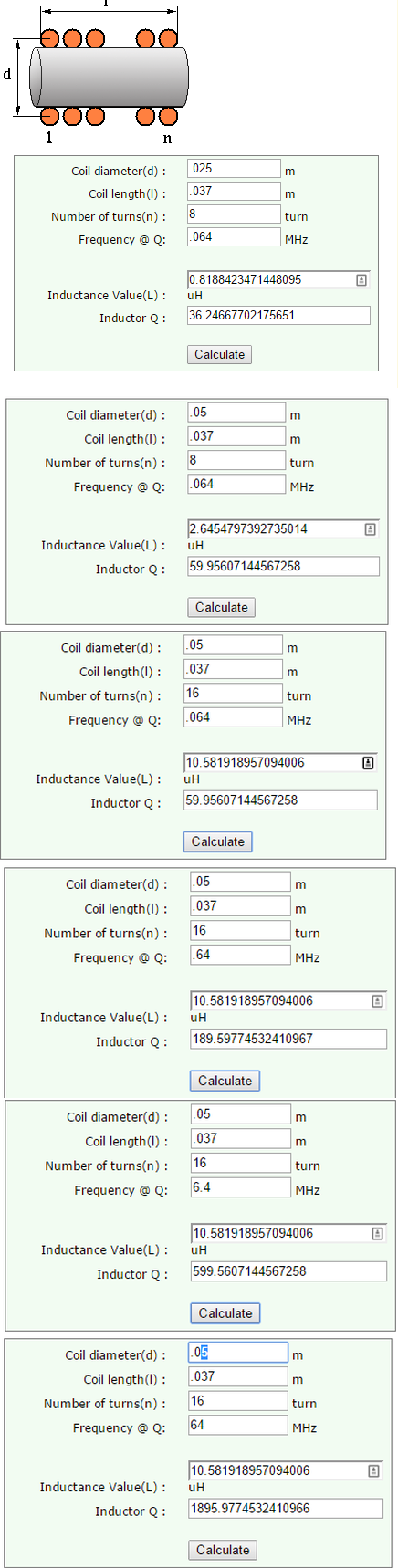

Without the iron core you should get a Q of several hundred 500 tops. But frequency will drop when loaded with iron more significantly, which is why a fixed drive frequency at the loaded L rather than free air L is better than a self resonant circuit one as Q amplifies the voltage and may exceed the cap ratings. A VCO with pushpull complementary bridge driver IC will do the job for high power than the one being followed. 64kHz is too low Z and drives up conduction losses. Too high may cause eddy current losses and skin effect losses. But increasing at least x10 would be my goal. which may scatter into AM band, which is why license free f of 21? MHz is used for industrial RF power.

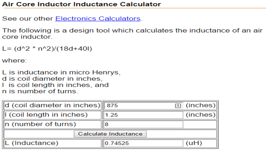

These calculations show how raising the impedance and Q is done by doubling the Coil diameter then raising f by x10 .
1" diam ~ 0.25m ( Usually inner radius is used when skin effect occurs. )
https://www.coolcircuit.com/tools/single_layer_coil_calculator/

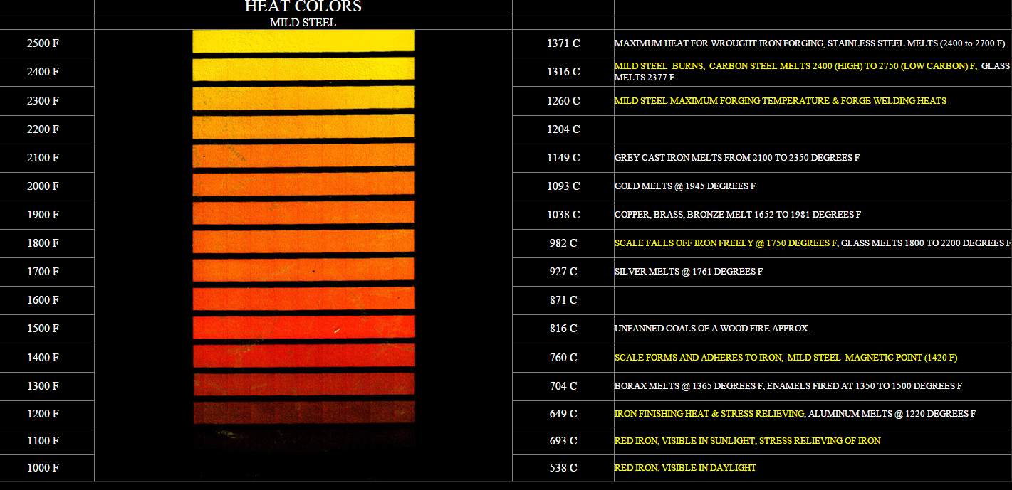

I dont understand why I can not get a hotter part? I need the part to be about 200 degrees hotter. The temperature I have is slightly too low for metal forming.
1) start using metric ('C)
2) which color or how hot was it ( best case)?
3) what do you need?
4) Do you know about Curie Temp for iron is Fe 1043(K) or -272 = 800'C (1400'F) where Relative permeability of iron core drop abruptly then you are relying on eddy current losses in iron core which should be great. ( & hot)

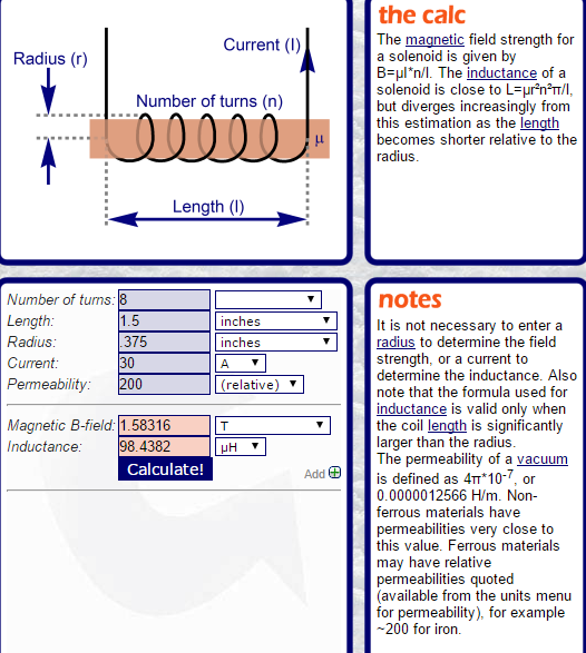

Only cold rolled grain oriented steel (CRGOS) can handle 1.5Tesla without saturating commonly used in power transformers. When it saturates, losses increase up rapidly.
As I was saying around 10 uH would be a sweet spot for me but with 100 uH. @ 30A you can reach 1.5Tesla. With a much higher impedance coil at higher f resonance, you can then get as much higher V across the coil rather than the CM choke and into the iron core.
The 8mH series shunt needs to be bypassed with a large cap and the smaller cap to resonate with coil at least 10x f. or 500kHz Large high V cap but low uF and high V MOSFETs.
As iron reaches Curie point L drops so f must increase otherwise current drops.
https://www.calctool.org/CALC/phys/electromagnetism/solenoid
