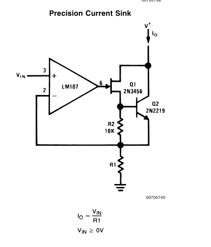

so you want to drive a HBLED with a known constant current and determine the temperature from the T/Vf curve of the LED(i.e. by measuring the forward voltage), correct?
you can drive the transistor with a single-ended op amp current source and provide feedback to the op amp with a current sensing resistor as shown here....

in the circuit i provided, Vin should come from a precision voltage reference. for driving HBLEDs, you only need a 5-10V power supply. for 300mA (assuming a 1W LED) use a 1.2V reference, and R1 will be 4Ω
errrrrr....... a search for a TL1021 turns up an AR-15 handguard removal tool, a lawn mower, a class D monoblock amp, and a radio control mechanical linkage. a search of TI's website comes up blank.
go with an LM431, they're common as dirt.

thank you for reply, my case is little bit different than you mentioned :eek:. i have 7w HB led bulb (7, 1w leds) i don't have any specifications for that single led. i only know the bulb is 7w(as per the manufacture)
so i don't have any T/v graph, so i have to made it my self.
as per your design, R=4Ω and Vref=1.2v the current will be
some thing around 300mA, this is much current than i required. my led bulb already has smps current driver just i want to know what is the junction temperature when it drive with its own current source. for that first i drive with its own current driver for couple of minutes to heat the junction the stop it and supply 10mA like small current to avoid junction heating and measure the voltage drop across leds and determine junction temperature.

another problem why do you use darlington like pair in your design? what is the purpose of Q2 2N2219 transistor
