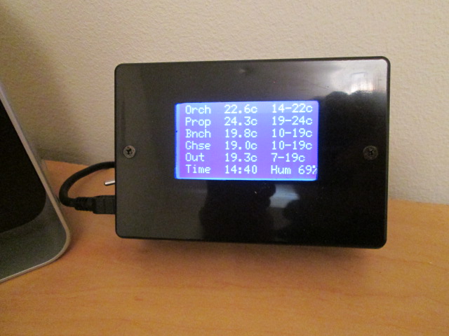

I've just been using a 128x64 with spi to act as a 6 line display and it works fine, though have not yet tired any graphics, but when helping a friend get his spi display working he pointed out as well as the spi lines he also has a D/C connection ?
Seems thats for hardware control of Commands and Data, so expect you need different driver software for that, expect it speeds things up, but not sure if has to have that control to work or is optional ? just one of such mysteries ! :confused:
