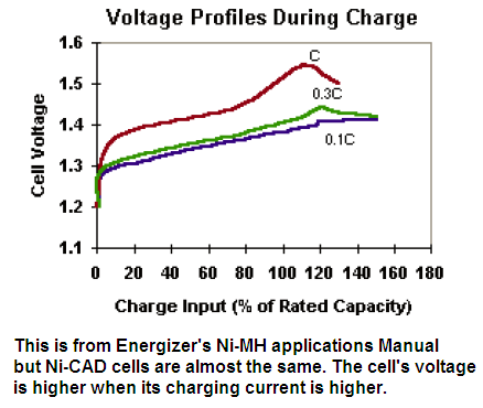

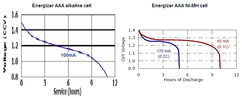

A Ni-Cad or Ni-MH cell is 1.5V when it is fresh out of a high current charger, then the voltage drops quickly to 1.25V.
An alkaline cell is 1.6V when brand new then the voltage drops quickly to 1.2V as it is used, then drops slower to 1.0V when it is almost dead.
Which AAA battery cell (alkaline or Ni-MH) has a higher voltage when its load current is 100mA? Look at my graphs:
I don't mean to be rude, but what does that have to do with how to charge them?
But thanks for the visual aid AG. It's good to see how they differ in how they charge and discharge.
Actually, the ones I have tested will only get up near 1.5V when being charged with high current. Turn off the charge and it will drop to about 1.4V almost immediately. Then it willwander down to about 1.3V but under any load, the nominal is about 1.25V.
