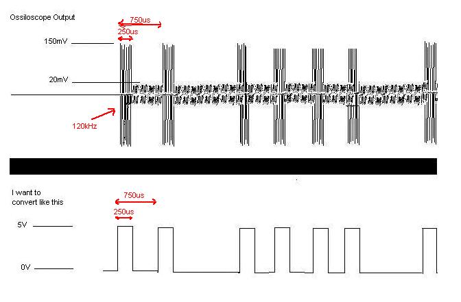

How can I use opamp or any component for my problem ?

hi hero,
The comparator will remove the 'negative component', as its a threshold detector.
Set it for say, +80mV and everything below that value will NOT be output, input signals over +80mV will be above the threshold and will change the state of the comparator output.
The 'spike' component at the output of the compartor will be integrated out by the RC filter.
I dont see any reason to explain it in AM radio terms.
I must point out I have used compartors many times in my products and I have lots of experience in their use.
I still would like an answer from the OP regarding the period times I have asked about.
EDIT: hero,
For reference, I have tested a LM393 comparator using a signal of the same amplitude/polarity and 'noise' as the OP's drawing.
As I still dont know the freq/period of the OP's waveform I have assumed something about 100KHz.
The switching level Vref set at +80mV, with a 10M/10K positive feedback gave a switching threshold of +72/78mVolt[6mV diff]
with a well defined output signal of about +0.2/+4.8v, with a 3K3 pullup to +5V.

ericgibbs said:
Tell me what the 'p1' , 'p2' time periods are, also the frequency of the spikes, refer the gif drawing.
Then I will try to help.

ericgibbs said:
hi hero,
I see that but it'd still switch at the harmonic frequency, so instead of having one pulse on the output per input pulse in you'll get lots of pulses and whether the comparator can keep up is another matter altogether
Are you talking about putting the RC filter on the output of the comparator?
That would certainly make sense but wouldn't another comparator after it be a good idea to square it up?
i just added timings.

This attached circuit works using a LM393 comparator.
If the signal output from the 1st half of the LM393 isn't 'square' enough after the R1/C1 filter, use the 2nd half of the LM393 to square it up.
Lets know how it goes.
EDIT: Added 2nd LM393 stage.

i m just building it.
