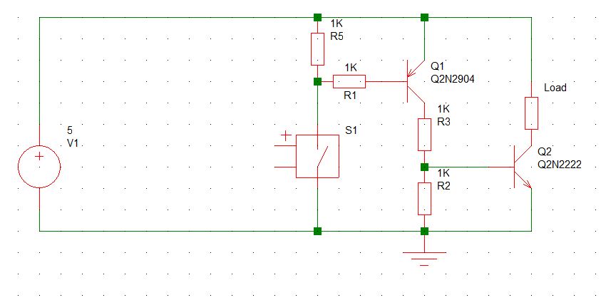

I may be wrong but I don't think this circuit works.
When Q1 is turned on you will still have a 0.7V drop across the transistor this will be enough to put Q2 in the linear mode. A resistor on the base of Q2 might fix this, 1K between Q1 collector and Q2 base.

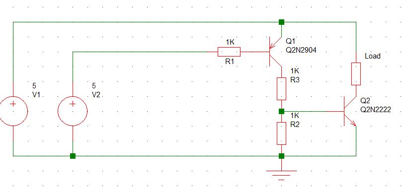

But personally I'd use an PNP transistor like so:
With V2 on, Q1 will be turned off and R2 ensures the base of Q2 is low so Q2 is off. So V2 on turns load off.
With V2 off Q1 will be on turning Q2 on.
What is providing your on/off signal to Q1? For my circuit it would need to have some current sink capability so wouldn't work with a switch for example. but it could be modified a little

In my last drawing R5 should probably be 10K ohms but it will work either way. Also S1 and R5 can be swapped for normal open or normal closed switches.
Yeah, I don't "get it". I wasn't getting updates on this thread either? In the simulation the base of Q2 is going to zero volts and we tried a base to ground resistor on Q2 to make sure it turns off. Yeah, I would replace the load with a 100 or 120 ohm resistor or so and see what the circuit does.

The sensors you mention are 3.3 or 5V but you also mention a 9V power supply.
If you are trying to use the 3.3/5V sensor output to turn on/off a 9V power supply, my circuit wont work as Q1 wont be able to turn off.
If you are using a5 to 9V input on the base of Q1 to turn on/off a 5V supply to your sensors then my circuit will work.

Sorry reloadron i still can't see how the base of Q2 can possibly be below 0.7V with Q1 on. Did your simulation include the correct voltage drop across the transistor? Replacing the transistors with Mosfets would enable this circuit to work correctly.

OMG, I don't believe I did that. I totally omitted the forward voltage drop of Q1. You are absolutely correct. My bad all around on that circuit. Thanks for actually getting me to think.

As the voltage you are trying to turn off and the voltage of the sensor are the same then my circuit should work, although I've thought of a simplification last night see below.
Are you using the analogue or digital output of the sensor? I am concerned that you are using this circuit out of spec and at 12V I wouldn't be surprised if you had fried the IC that I can see on the sensor.
