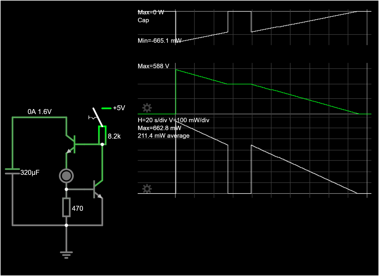

That is pretty nice. I'm guessing this is what Nigel Goodwin meant by an active discharge. I did not think of using a current source for discharging. Thanks for sharing as this is pretty interesting but rjenkinsgb made me realise that the operating temperature range referred to the ambient temperature range rather than the temperature of the thermistor itself in the datasheet so my original thermistor solution would work I think as long as I adequately protect the surrounding components from the thermistor's heat. Also the caps need to be drained in less than 5s.
I wouldn't be able to use your suggested circuit without modifications as the circuit I am designing needs to be able to handle the maximum voltage permanently without being fried. A TO-220 MOSFET/BJT constant current sink would fail pretty quickly if exposed to continuous voltage hence my desire to use a PTC thermistor. Thanks for the idea though I'll keep it in mind if I need to design a similar circuit in the future with less stringent safety requirements.

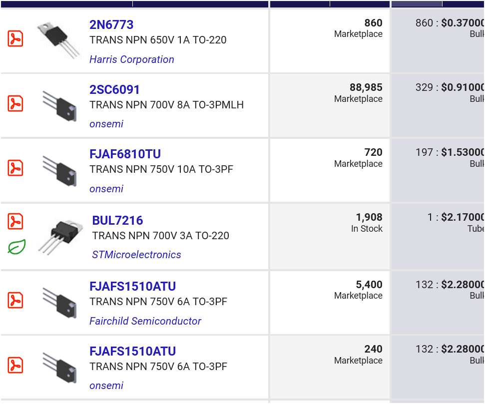

They make transistors and FETs for >850V these days. Shall I find one for you? is the Polyfuse reliable enough for your job? Are you sure?
The drain to source (or collector to emitter) breakdown voltage is not the issue with using a current source for discharge. It's that the circuit is not capable of surviving without damage in the event of a fault where power remains on with the discharge circuit active, which is a requirement for my application. While it may be possible to modify the circuit to do so, the PTCs I am looking at cost a few £ and are as simple as it gets - just one component (apart from the contactor of course which I already have) so I believe such a circuit would fit my use case better than a transistor-based constant current discharge circuit. I nevertheless appreciate you sharing your circuit as I did not think of using such a circuit before for discharging DC bus capacitors and you have shown using falstad that it can indeed work.
Is there any indicator of HV when off?
If you wanted to add an LED,I would choose an ultrabright 5mm white 30 deg 16 Cd and insert between Re=470 and emitter.
I would not rely on a single Polyfuse for human safety but OK for equipment safety. There are lots of Hi_Rel solutions that won't protect from a blunder like, if one overlooks a cut in insulation on HV cables or equiv. which ought to be shielded.
My Professional advice is not a cheap and dirty fix. But if you want to improve reliability of the polyfuses with redundancy, use 4 with 2 in series and 2 in parallel.
By changing the requirements to a few minutes the average drain, iff left on is < 700 mW with a 160 s discharge time with a 1.2 mA CC rate. This is less than the average car leakage current when off.
Total BOM cost < $1 on perf-board with nylon standoffs using 2N6773 with hFE = 20

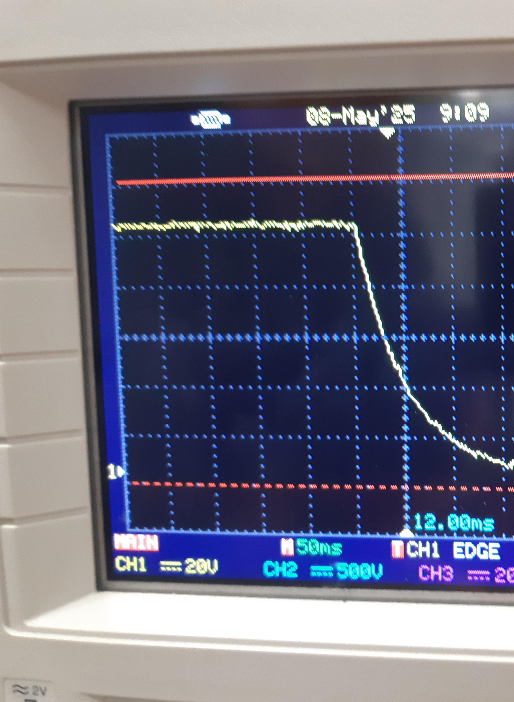

I have tested the thermistor and it worked. Thanks to everyone who helped me in this thread.
Below is the discharge curve (100v starting voltage) of a 75uF capacitor with a PTCEL17R102UxE404 in series.
The discharge time is about what would have been expected with a 1k resistance and a 75uF capacitor. Note that those are the stated values (affected by tolerance) and not the actual measured values. I measured the actual values at some point and they did not differ significantly from the values given here. Once I was certain the thermistor was behaving as expected, I increased the voltage to 600v (the oscilloscope probe is isolated and rated for 1kV) and the circuit performed equally well. After around 7 discharge cycles in quick succession, the temperature rose to around 55 degrees centigrade. The discharge time was not significantly affected which is not a surprise since the temperature stayed well below the datasheet switching temperature of 130-140 degrees.
Additionally, I connected the thermistor to a 600v supply after placing it on one of those silicone mats usually used for soldering and allowed its temperature to stabilise. A thermal imaging camera was used to measure the surface temperature of the device. It stabilised at around 150 degrees which makes sense since it is just above the switching temperature where the resistance starts to rise significantly. The high temperature that may be seen in the event of a sustained fault is potentially problematic but thankfully designing the enclosure for this circuit is somebody else's problem, not mine. Thanks again to all those who replied to this thread originally.
