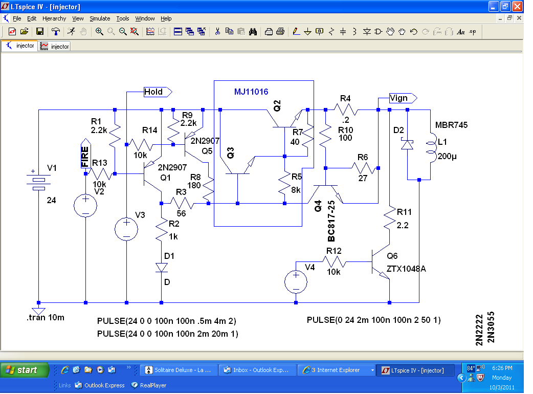

Here is the idea to combine both the fire and hold circuit into one. Sorry it's a little messy. I used the darlington to reduce parts count.
I suspect you got to the circuit you have with some experimentation that we don't have the benefit of, but hopefully your friend can keep you out of trouble.

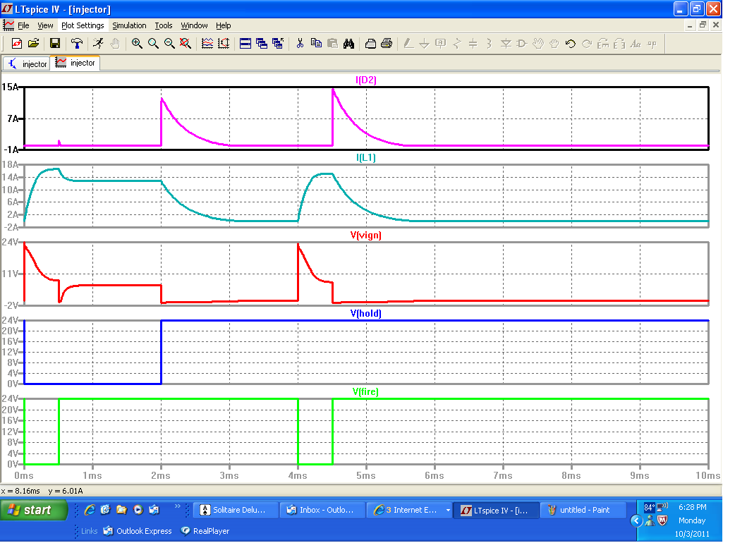

If you look at the simulation you can see that the current thru the coil during turn off is in the same direction as the current that opens it. That current circulates thru the diode. The effect of this is to keep the valve open longer than the pulse width. Don't know if you have this as a problem or not. It looks like the damper pulse may be an attempt to help this.
Basically this circuit just sums the current from fire and hold earlier. I hope I understood the timing of the two pulses. The first pulse in the simulation is fire and hold, the second fire only. I raised the current limit slightly to make sure you can get the full 16 amps. If you think you might build it I would be curious to know the use of the 560 and 1k resistors in your schematic. I might guess they supply just enough current for the valve to function. If so we should keep them.

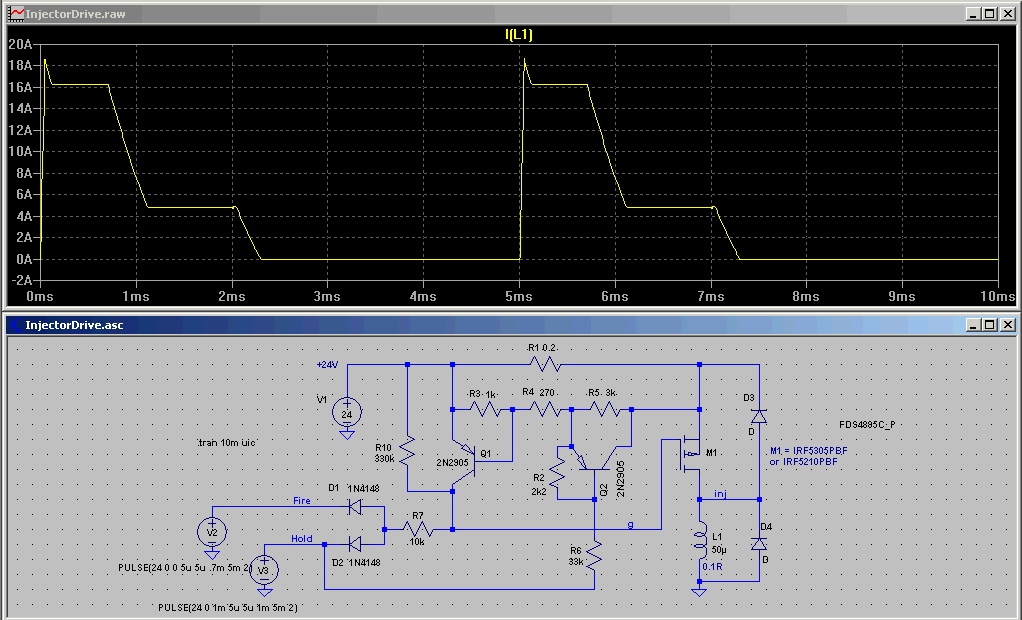

Here's a further simplification, eliminating one igen as suggested above. R4 and R5 can be adjusted to vary respectively the 'hold' current and the 'fire' current.

Nice circuit alec_t. Before I looked past the first page, I promise, I had almost the same circuit, except for the two current levels. Let the 2N2905 control the current and the FET do the switching/regulation.
The other way round. The high brief current opens ferrite in the coil fast, the lower current is left holding it.
I was worried about the Turn Off Current delaying things. My friend showed on the scope that pulse duration was as predicted. But we were not testing with the Coil in place. It's possible we are delaying Closure. But I think not, because if I turn the timer down, I get no Opening ie the whole duration is too short for the thing to act at all, even tho the charge is max.

The 2TX653's are over current protection. If the current goes over 14 amps they turn on and limit the current to about 14 amps.
I made the simulation with fire and hold and fire only as sometimes you run it without the hold current.
If you look at the current thru L1 (the injector) you can see it takes time to build up due to the inductance of the coil. It is also slow to decay because of the diode snubber. There is not much that you can do to speed up the turn on except to use a higher voltage (say 36 instead of 24 volts. The turn off can be improved, if it's a problem, by using a different type of snubber.

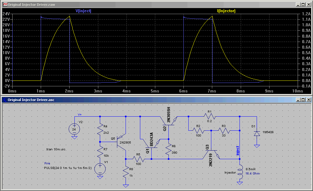

Sorry to be the bearer of bad news but I've spotted that the TI link in post #38 quotes "Fuel injectors appear as 8.5 mH inductor with 16.4 Ω series resistance when running hot."
I note that in post #36 you say "But we were not testing with the Coil in place."
So, unless your fuel injector inductance/resistance are drastically different from those figures I think your friend will find that the circuit as in the post #3 link (and post #4 attachment) won't work as expected when driving a real-world injector.
I've plugged the TI figures into an LTSpice simulation (using approximately equivalent simulated components to those in that circuit) and come up with the attached results. The maximum possible (resistance limited) injector current available from a 24V supply will be 24/16.4 = ~ 1.5A, but with a 1mS 'fire' pulse the current will only reach ~ 1.2A (limited by the inductance), regardless of the variable resistor settings. Decay time at switch-off is ~ 1.5mS.
The only way to get anything like the ~14A that you want is to use an injector of very low inductance and resistance and/or a much higher voltage supply. (Note that in my suggested circuit I assumed L = 50uH, R = 0.1 Ohm).

I assumed L = 50uH, R = 0.1 Ohm.
At the start, several years ago, the inductance was allegedly estimated but I can't find the record. It was "very low". I found this unexpected 'cos of what it did.
But cars don't build high voltages and our destructive examination of the EMU for the injection system didn't suggest otherwise (which we did not copy at all; we started from scratch).
Yet we needed 18 v minimum to get it to Fire. And about 15A in rehearsal without it in place.
