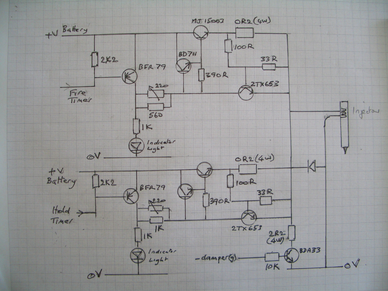

I have an experimental 2-stroke diesel engine. The Delphi injection system operates over less than a millisecond. A pulse of high current (about 16 A) at 24 v is generated and 'fired' with a switching inverter circuit, whose duration can be varied. This is the"accelerator."
I am not in any way an electronics expert (advanced schoolboy physics helps but little).
I published details of our circuit on wordpress.com/malc9141.
It's pretty clumsy and I was told a CMOS circuit would be better for the current generator (igen) segment.
(There are two igens in my circuit, one for Fire, the other for Hold; but if I began to understand a single igen, it would be a great help).
I have two lead-SO4 batteries in series, with a 22000 pf cap, as the source of power. The timer circuit allows a transistor BFR39 to earth (for the timed moment). This activates the igen.
Would it be possible to start discussing how I could build a CMOS igen?

It would help us if you could post the circuit here, or a link direct to the circuit. Forum members will not want to wade through ads and a blog just to find the circuit.
Thanks. Alex
The circuit has three parts, each doubled.
But only the last part, with the injector, matters for the question,.
This last part is (as I've said) "doubled."
1)When the injector is fired, a huge electrical pulse (about half a kW for <millisecond,) opens a ferrite solenoid valve, and the incredible hydraulic pressure (how about 1500 bar, and more!) bangs open the needle valve, squirting in fuel, in a millisecond or so.
2) Having opened the needle valve, the current drops back to a hold value (about 5 A).
This can be found with some fiddling at www.malcolmcochran.wordpress.com.
You might have to look on the "earlier blogs" or similar. Wordpress is a bit weird.
It's under Delphi fuel injection system. It's not "Block Diagram"
which I couldn't load.
Actually that is not a bad circuit if you need the adjustability and the current limit.
It's now attached for others.
I agree, that seems a perfectly fine circuit, although I don't quite see what the preset resistors actually change?.
I don't see how a CMOS circuit would make any difference?, or why anyone would suggest such a thing?.
I was told the CMOS circuit would get rid of the big MJ 15003, using lots of current. We could make it all neater.
I know this circuit works - we started not knowing what was needed - the required charge pulse turned out to be immense. Who would have known (the pots were part of this experimentation) ? Telling me it works is no answer.
But this is what I feared: nothing much that helps.
How could we design a neater circuit, knowing that this does work even if it looks like an octopus?
Unless you are considering a PWM approach to controlling current, a CMOS circuit (i.e. a logic circuit) has no obvious purpose here. Perhaps whoever suggested it intended 'FET'. You could replace the MJ15003 + BD7N + 390R with a FET....not much neater, and any current saving would be minimal.
A CMOS circuit would not be able to run directly from 24V, so that would require additional components to drop the voltage.....hardly a neater solution.
In summary, what you've got looks fine (as stated by others). If it ain't broke why fix it?

As already mentioned by alec_t, there's no 'magic' reason for a CMOS solution to be any better, and it's likely to be more complicated for no advantage.

It's pretty neat already, simple current limited power supplies - the current is limited by the value of the 0.2ohm resistors, and will be roughly 3-4amps.
FET is 'Field Effect Transistor', and isn't likely to be of much help to you.
What IC's fail?, in what way?, and does anything else fail? - bearing in mind there's no IC's shown in the circuit you posted.
I wondered that myself. There does seem to be a way to simplify it though. You have two seperate but identical circuits with their outputs "wire or'd" together. Why not have just one circuit and "wire or" the inputs from the timers?
EDIT: After readingthe link, I realize the two circuits aren't identical after all, though the schematic doens't show the difference.
EDIT2: I see no reason to resistively divide the voltage across the output reisitor. You can eliminate the the 33ohm and 100 ohm reisistors. That might make it a little neeter.
You might make it slightly simpler by swapping out the MJ15003 and BD711 with a darlington like a MJ11016.

It's a bit confusing: I wanted to be able to inject at two points in the cycle, not just one. In modern VWs, Alfas, etc. they inject a tiny bit of fuel (too little to catch fire) long before TDC. This creates perfect atomisation of fuel (essential in diesel) and helps burn the main charge.
So I have two inputs from the crank. Diagram on web but not shown here.
Each of these can "fire" the main igens. These send the charge to the solenoid in the injector. Now forget about that!! :)
@your edit 1. There are 2 igens and number 1 opens the valve, number 2 holds it open. That's what we have here. As the big charge fades the holding current takes over. Total time about 1.5 msec.

Your approach to the design is, I would say, the best in terms of getting something that works reliably. There are some optimizations that can save a few parts, but I'm afraid the effort and risk are more than the rewards. If you decide to go into production and have a developemnt budget, then maybe it would be worth it, but I don't see at this stage any reason to take the risk. Happy motoring :)
