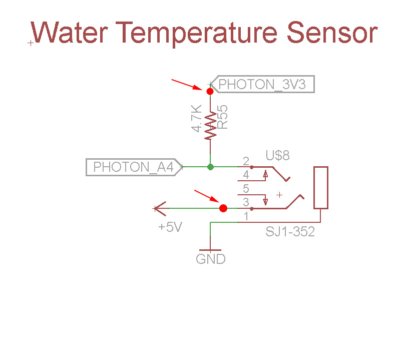

Hey guys,
I have a 3-wire temperature sensor (DS18B20) wired up to a headphone jack. I have the corresponding receptacle on the PCB. If the device is powered off before insertion of the plug, everything is fine.
However, inserting the jack while the device is running causes the device to reset. This is because during the insertion of a headphone jack, there are temporary shorts that occur:
* Sleeve gets shorted to the ring
* Sleeve gets shorted to the tip
* Ring gets shorted to the tip
Once its fully inserted nothing is shorting with one another.
The device is resetting because when a power rail gets shorted to ground, it pulls too much current and the voltage regulators that are upstream shut-down until the high current is removed.
You might be wondering, why not use the version of receptacle/jack that has the built in switches? The switches indicate when the plug is inserted in all the way, at which point I could activate the power and problem solved right? I cannot do this because the user has the option of using an audio extension cable... so plugging/unplugging at the other end of the cable would cause the temporary shorts and the problem would remain.
Another note: I cannot switch to a different style of plug, it has to be a 3 wire stereo audio jack.
I had an idea of using an LDO voltage regulator (such as the "TC1014" which is a 50mA regulator) using this as a current limiter. I was thinking I could use one of these on the 2 red dots I indicated in my schematic. My idea is that when this gets shorted to ground, this will cause an over current situation so the TC1014 will just shutdown and no current will flow.
Would this work? Is there a better solution? I am pretty stuck on this so any help is greatly appreciated, thanks!
Here is a schematic for reference:
In this schematic going from right to left, the rectangular box is the "sleeve", the middle connector is the "ring", and the last connector is the "tip" (in this case, this is the data line that is being pulled high to 3.3V).

If Tip was wired to +5V instead of Ring, then I dont see how 5V can ever get shorted to gnd?
This reminds me of how an aircraft mic jack gets wired. PTT is wired to TIP (it has +14V or +28V through a relay coil resistance on it), Mic is ring, Sleeve is common. No voltage backfeeds to Ring, and the transmitter is not accidently keyed as the plug is inserted...

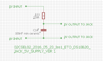

Hy Jattus,
Which State are you at?
Here is an approach that should do your job.
spec
I had the same problem with a project, just swap ring and tip, so long as the sensor connection doesnt mind being grounded.

Hy Jattus,
spec
Thanks again guys for all the help!
I am in Colorado if that is what you are asking.
So the 220 ohm resistor did the trick, couldn't believe it was so simple of a solution.
Is this correct by the way? During a short it will pull only 22mA, and the 220 ohm resistor will dissipate about 0.113 watts?

No probs Jattus,
Yes that what I was asking- it is interesting to know where people are. It also helps with mains supplies safety standard and access to components.
Sometimes solutions are simple, other times not so simple. :nailbiting:
Your calculations are correct.
The capacitor is for decoupling and can be any ceramic capacitor 100nF or larger, but not the very small surface mount types.
spec
Spec beat me to it with the resistor idea. The operating current of the DS18B20 is only 1.5mA max, so you could use a higher value of resistance if you're concerned with it's power dissipation. Just as long as the voltage at the part is at least 3V. But don't forget to add some margin for the resistance of the unknown cable length.
And while we're talking cable length, if the total cable length is more that a few feet (or inches, for many parts,) then the cap should be close to the DS18B20. Or better yet, one at the jack and one at the sensor.
