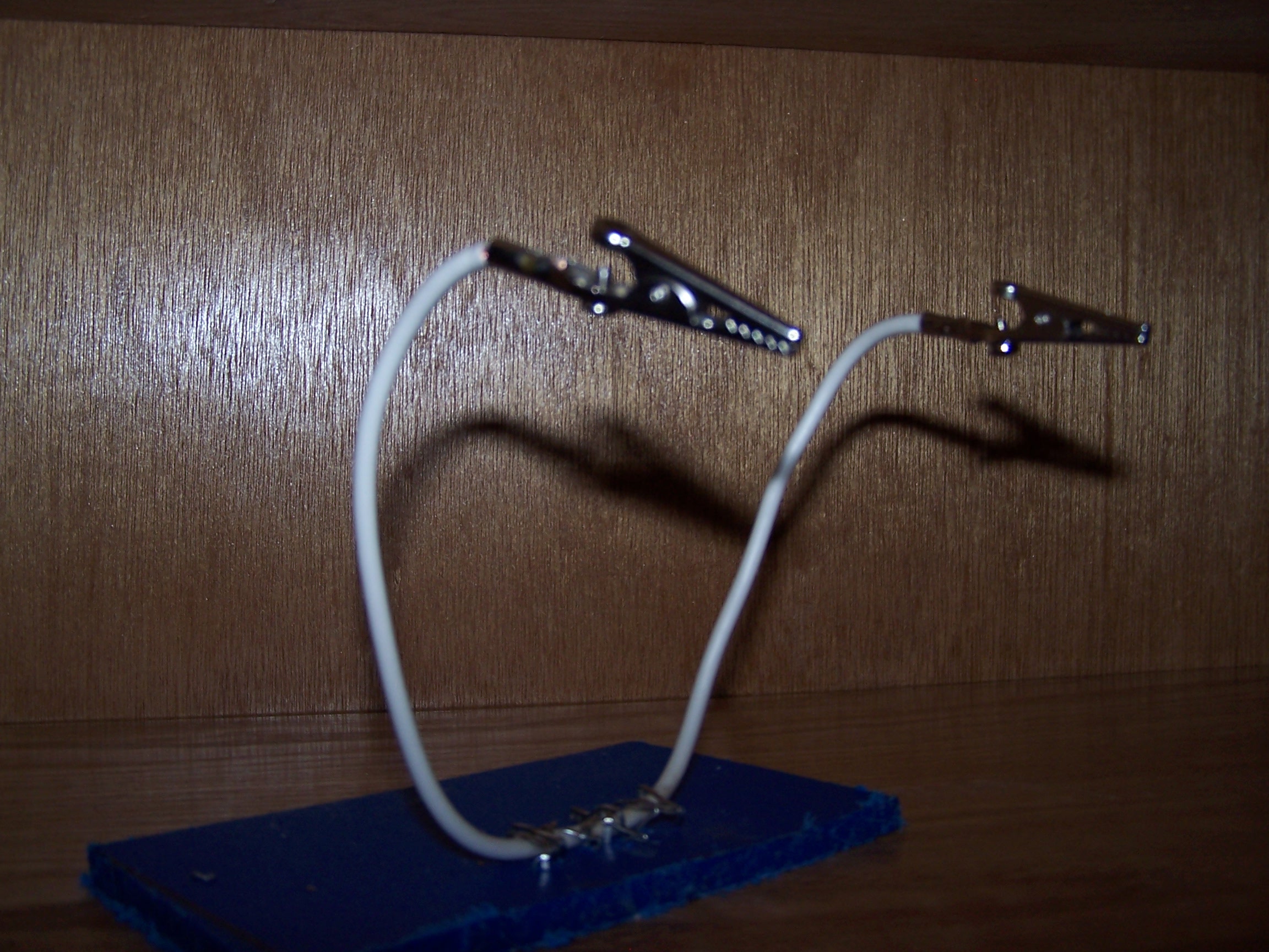

This is an easy way to make yourself your own pair of helping hands. Helping hands (or 3rd hand) is a simple mechanism that holds the part(s) that you are soldering together, aka a PCB Board, wires, etc. Very handy (ha ha) and you will love yourself for making one! Mine cost only $2!

Step 1: Strip about 1/2 inch (1.5cm) off each end of the wire.
Step 2. Staple the middle of the Wire to the Block of wood or your weight. Make sure you put a bunch in there to hold it down well.
Step 3: Put the alligator clips on each end.
Step 4: Clamp the alligator clips very hard on the wire, so it holds down well.
This is a cheap way of making very effective helping hands. You could put anything you want on the end of the wires, and even add more arms if you want to (I made myself the octupus, a 8 legged helping hands). Be careful!
Another way that you can do it is to cut the wire into 2 seprate peices, and put each end on a round hole socket, like for bolts in the center. You then bolt that onto your wood thing or whatever. That also works well. I am going to build another helping hands thing, except with 22 gauge wire and build a ton of hands for it (a new octupus). Let me know how your coming along on it, and if its working out for you.

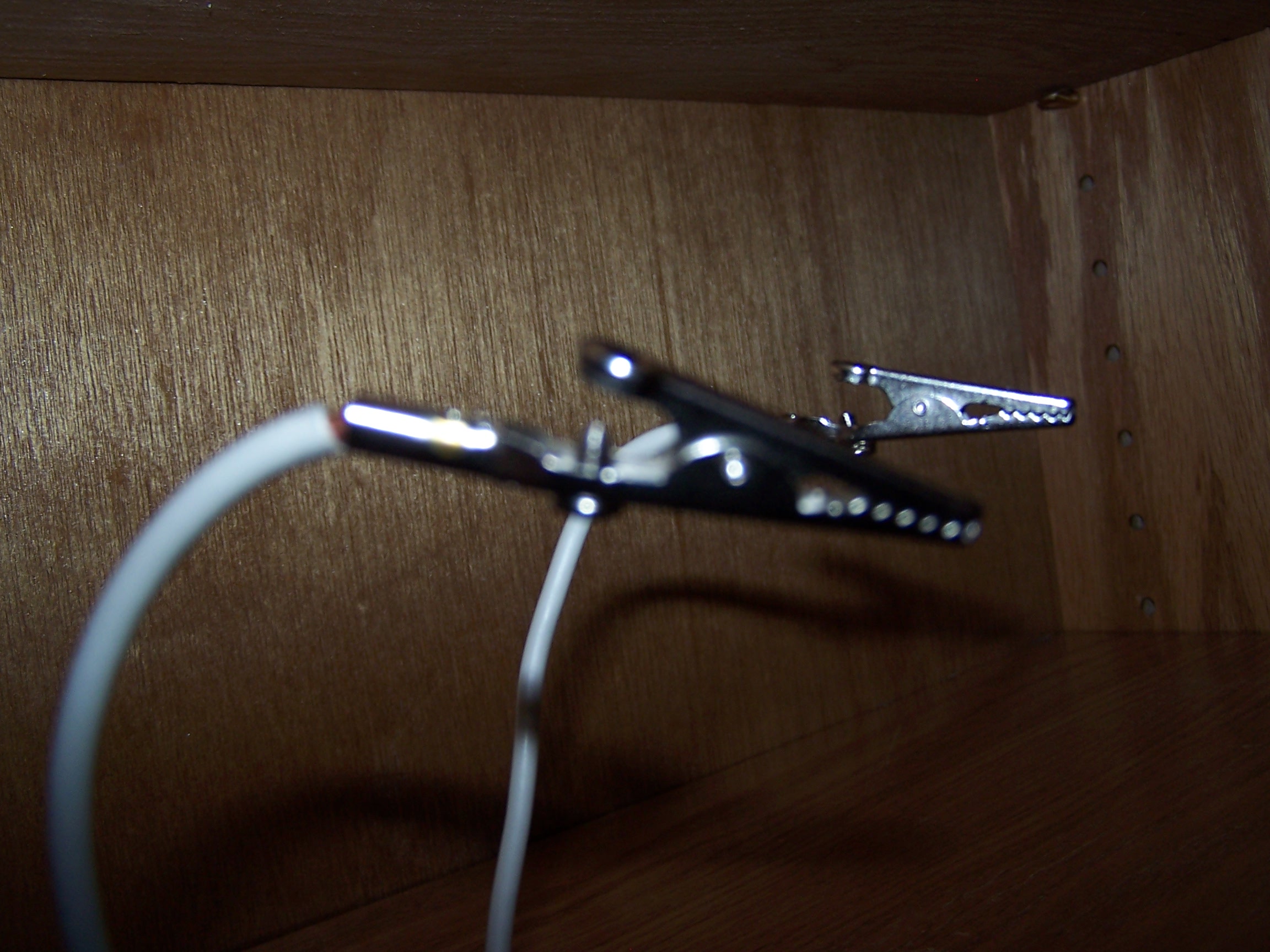

You dont need to solder anything; just a good strong pair of pliers to crimp them on to the wire.
Help 1 shows a general overview of the Helping hands. I mounted it to PVC board instead of wood, because I couldnt find a peice.
Help 2 shows a closeup of one claw.
Just crimp it on there.
