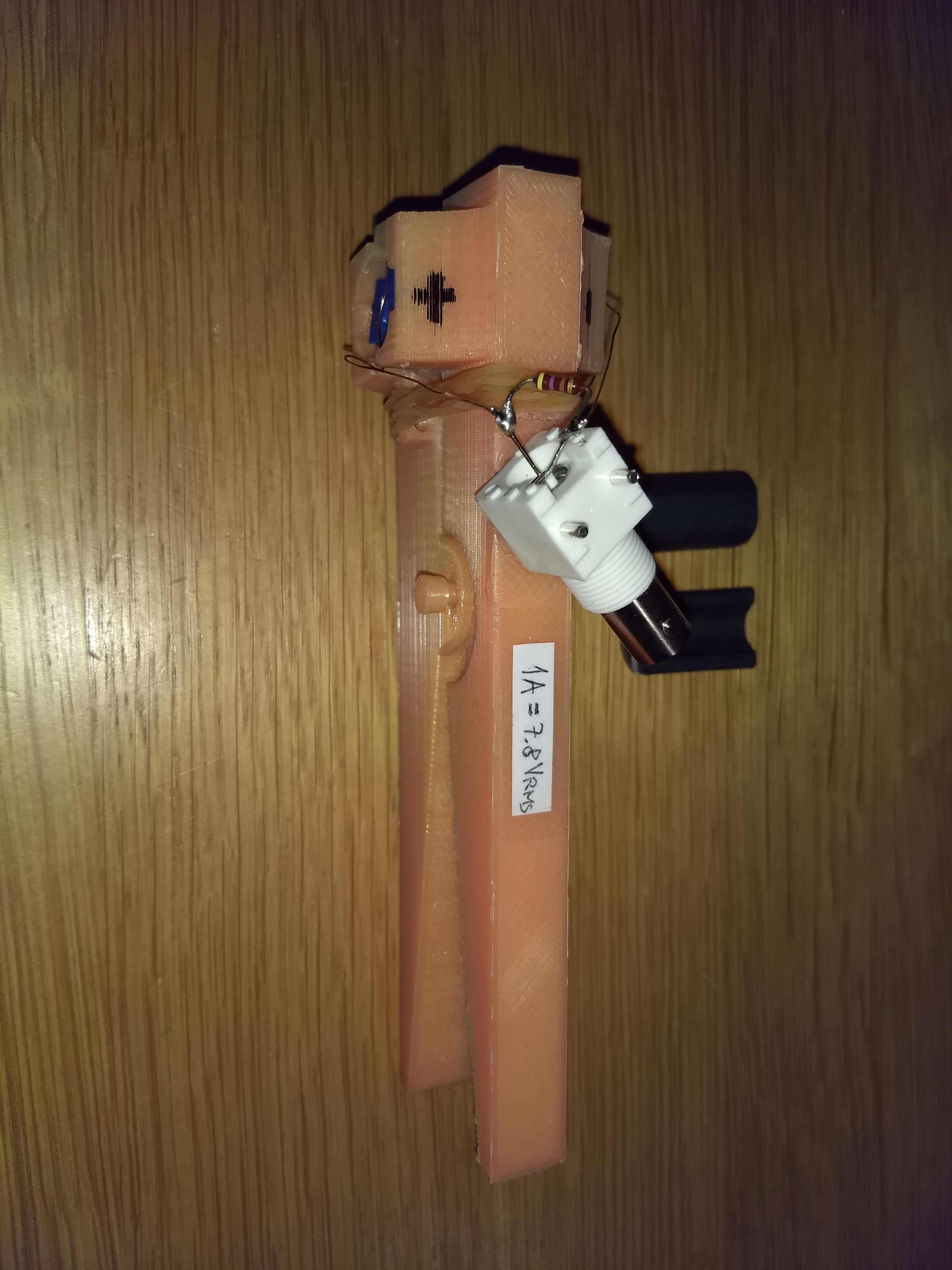

Hi guys,
recently I made a current probe with the idea to measure the current coming out of my homebuilt power amplifier on my oscilloscope. I have a dummy load
and can measure the voltage to deduce the current, but for learning purposes I also wanted to build a current probe to sense it directly. The probe is essentially a
split-core current transformer with a single turn primary and a 50 turn secondary, with a 470 Ohm resistor across the secondary. The transformer is clamped around
the cable and a BNC plug goes across the resistor to the scope. The frequency of interest is in the 100kHz range. When I measure the voltage across a purely resistive
50 ohm load and compare to the current measured with the current probe, for some reason i see a large phase-shift (something like 40deg). Does anybody with
more knowledge know why this is and how it can be corrected? I tried putting a capacitor across the secondary to cancel the inductive reactance and thereby set a
"0 degree" point to which I could compare loads that have an inductive or capacitive component, but that only works for a single frequency. I'd appreciate any input. Thanks

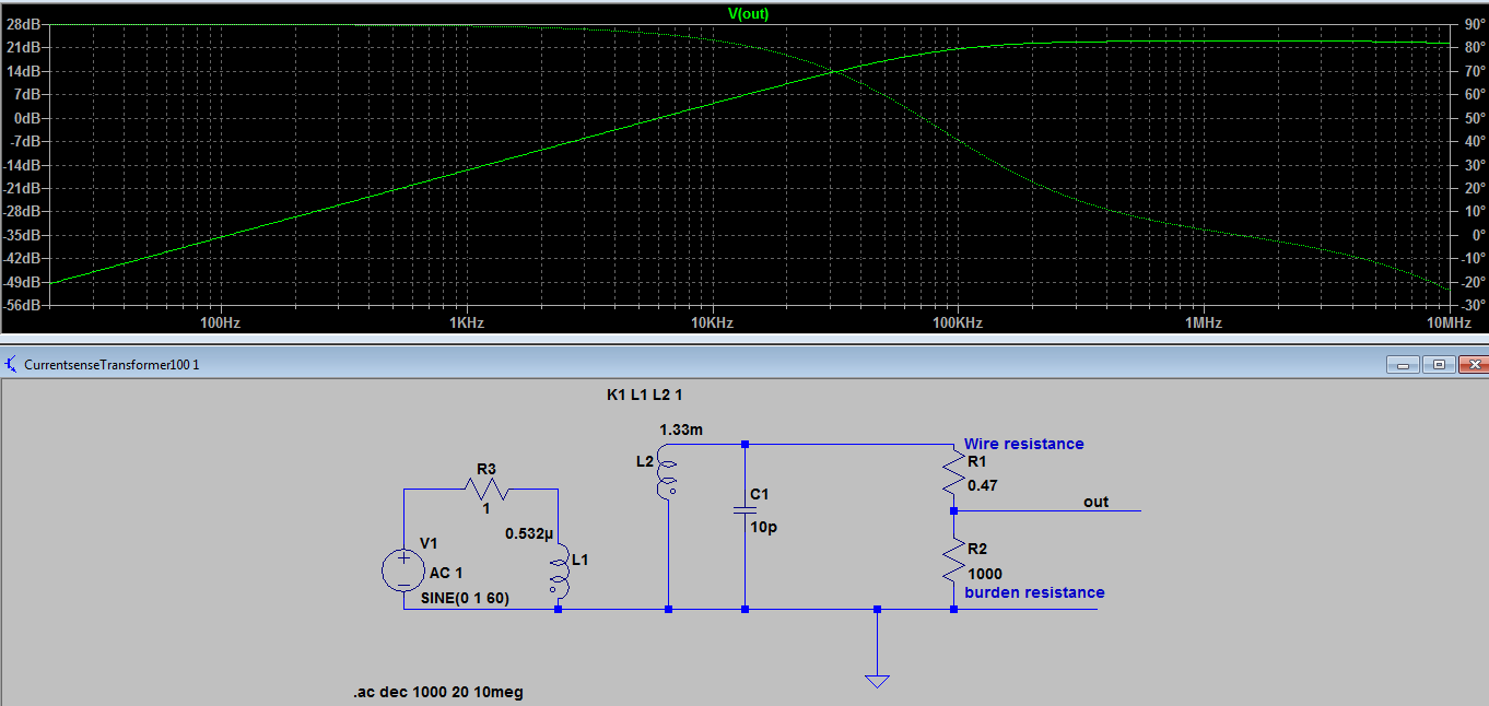

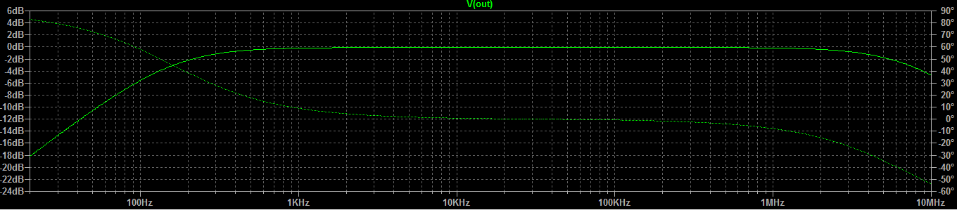

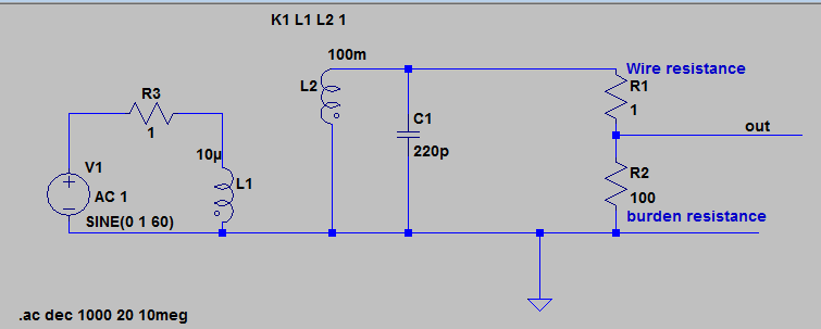

I have some 100:1 CTs that ate something like this:
The low end frequency response and phase shift is a function of R2 and the secondary inductance. (R2_R1)
The high end frequency responce and phase shift is a function of the secondary inductance and C1 (inter-winding capacitance). (or the self resonance frequency of the CT)
Some of my projects have a 3 way switch. (1,000 ohm, 100 ohm, 10 ohm)
The 1000 ohm has bad low end response but can measure low current.
The 100 ohms is per the transformer maker's specification.
The 10 ohms is very good at low frequency and high current. (Because the wire resistance causes some errors I needed to use 11 or 12 ohms)

Hi guys, thanks for all the input.
unclejed613 the reference for the phase angle is the voltage across the dummy load connected to the output of my amplifier. This already gives me the current because i know the load resistance, but the whole idea is to make a current probe and measure it directly :)

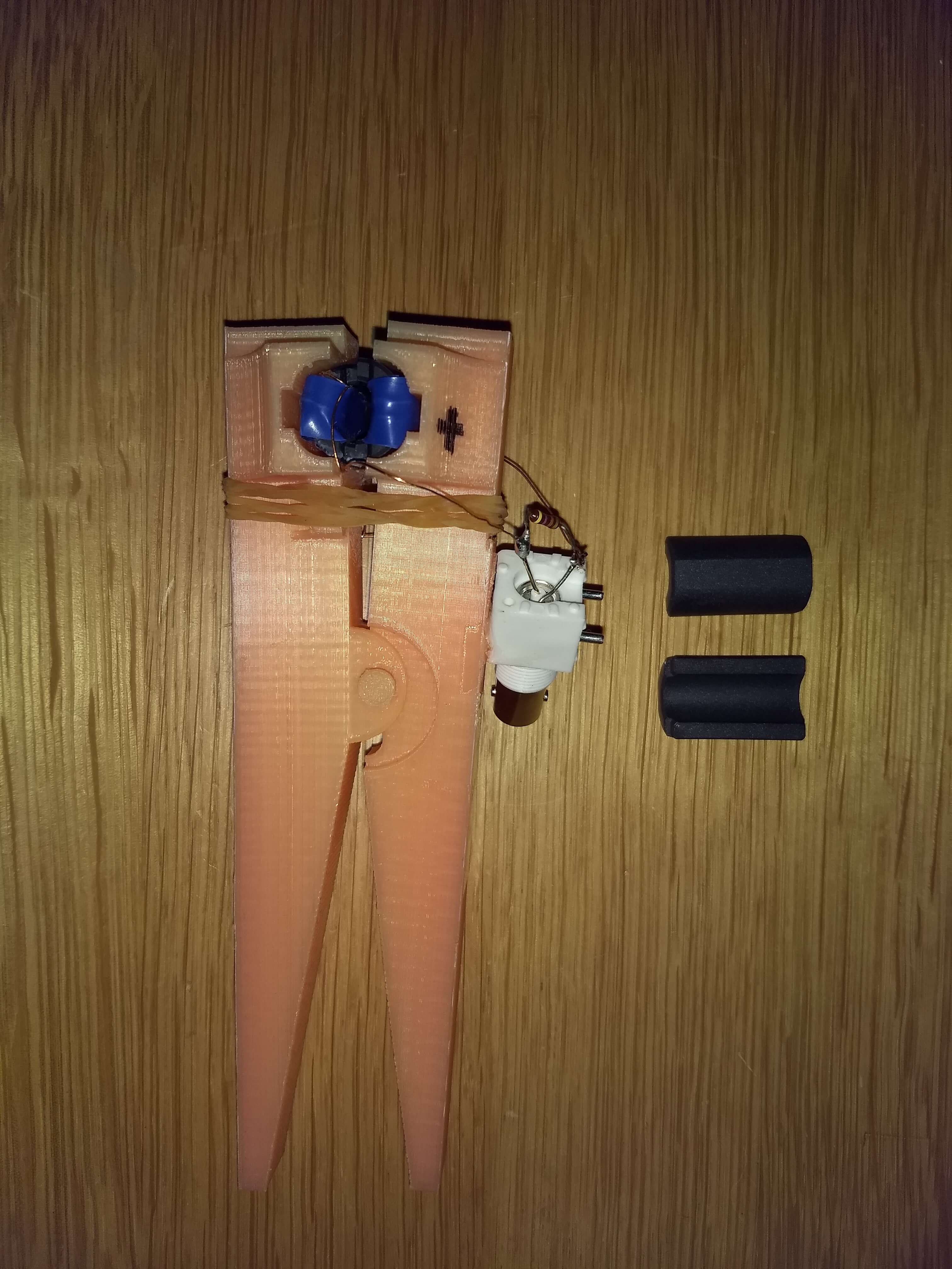

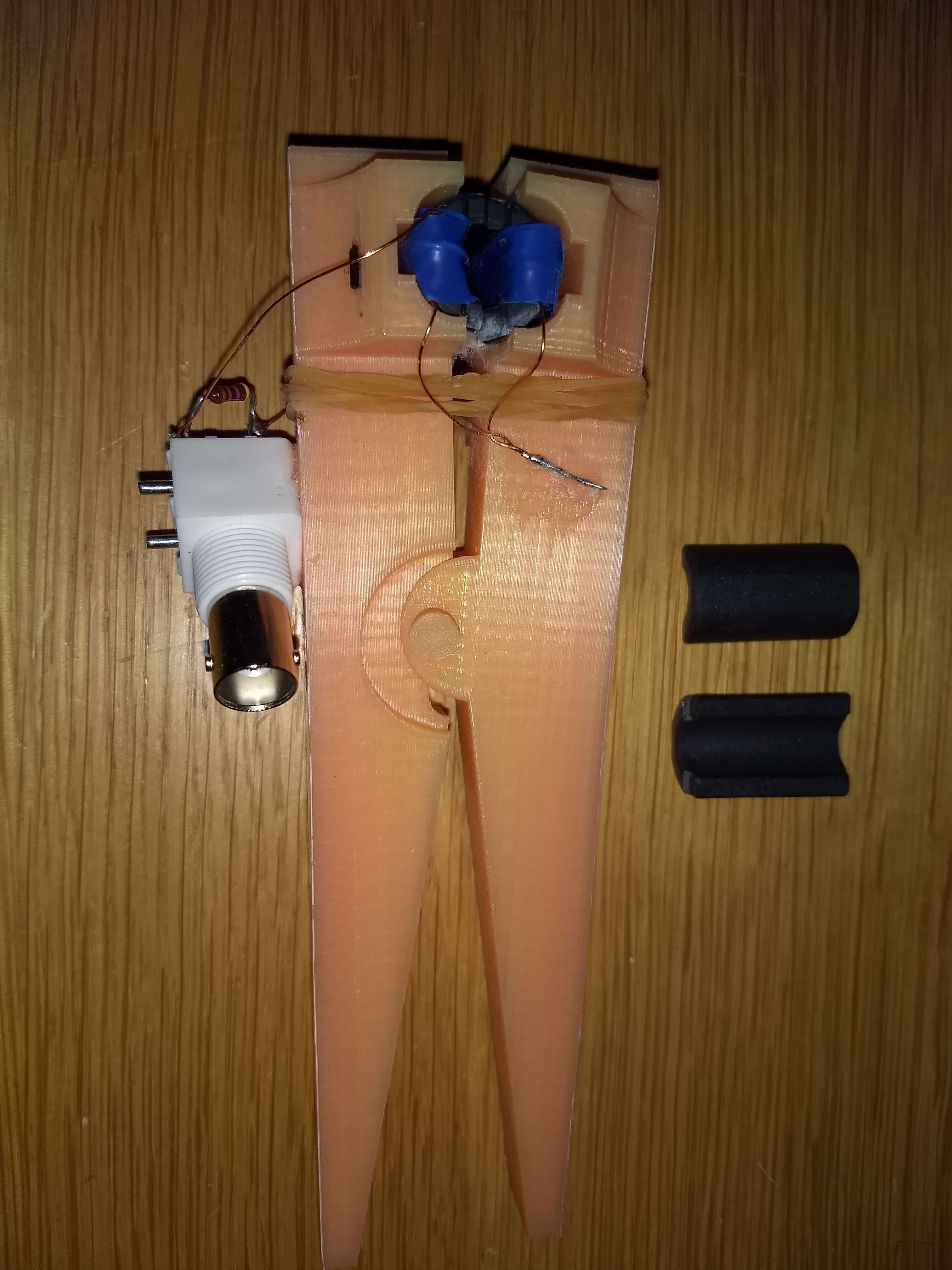

ronsimpson The open-circuit inductance of the secondary is 1.33 mH, and the series resistance of the secondary is 0.74 Ohm. A few pics of the probe
are shown below - the split core I used was a cheap clamp-on ferrite for spike suppression. In your schematic I see your secondary
inductance is much higher relative to your primary, compared to my case, and that you also have lower R2 values compared to me, except
in the 1000 Ohm case. I'm looking to measure current of several hundred mA to maybe 2-3 A. So, does this mean that I should increase
the secondary windings, lower R2, and settle for a lower voltage range measured across the resistor?

First, great job on the mechanics. I wish I could do that.
Your inductance is low and the resistance is high so the frequency is -3db at 85khz and the phase is off too much. My guess is that the phase is 40 off at 100khz. f = R/(2 pi L) You can check this by changing to 100 ohms and see if the phase corrects. ( the output voltage will be 1/10)

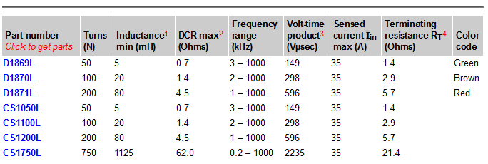

I use these from coilcraft.com and others.
Notice these use very low resistors and the inductance is higher.

ronsimpson thanks Ron, I used my Tevo Tarantula 3D printer for the clamp fabrication. I have some ideas for a nicer design in the future :)
I think I understand now what the problem is with the current probe. I will see if there is enough room to play with the turn number and load
resistance, since I still have a few of the split-cores lying around. If not then I'll look into the coilcraft current transformers, they look quite neat.
Thanks for the help!
I think this one (split core) is designed for 50/60hz and does not work well at 100khz.
I would pay the $9.00 just to get the core and turns. Gut the part and put it in your printed clamp.
If you are shopping for CTs, there are two groups. There are the 50 to 60hz that work through the audio range. There are TCs that are built for PWM at 30k through 1mhz.
