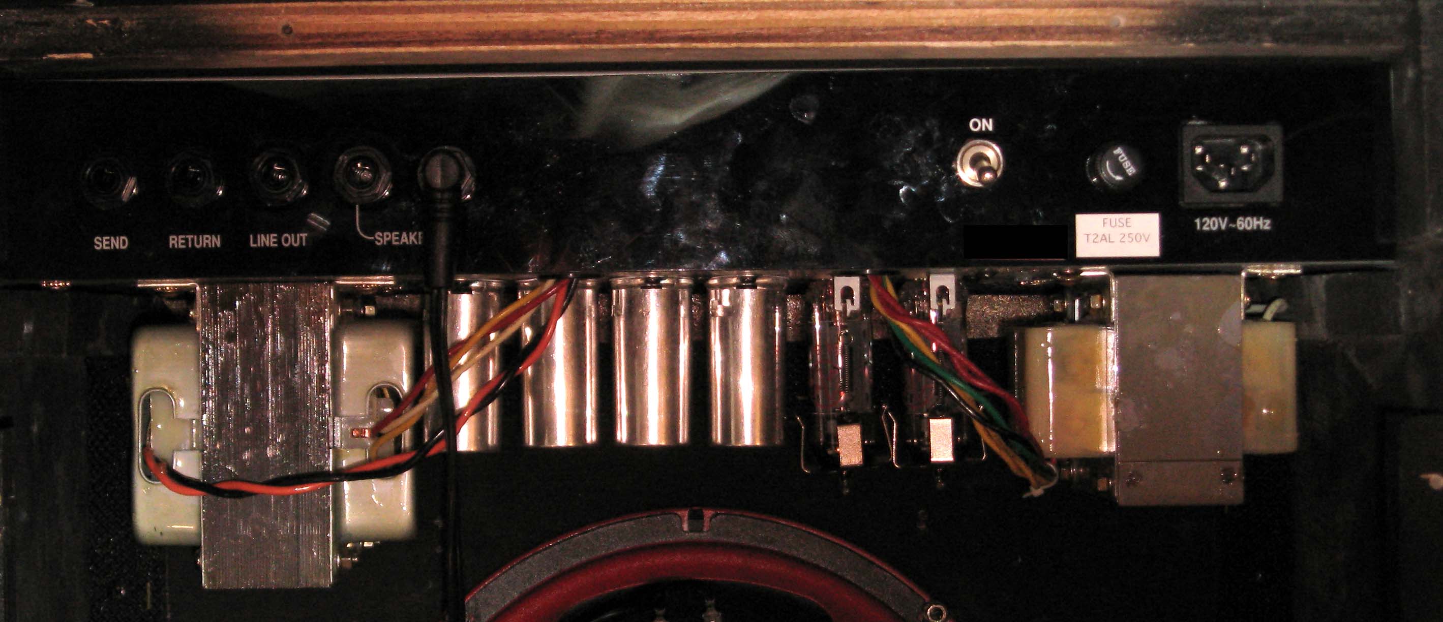

Also shot of back of amp. The OT is now twice the distance seen in photo.
Little more breathing room anyhow.
The last tech said the input was not a shorting jack but I wouldn't put too much into that.

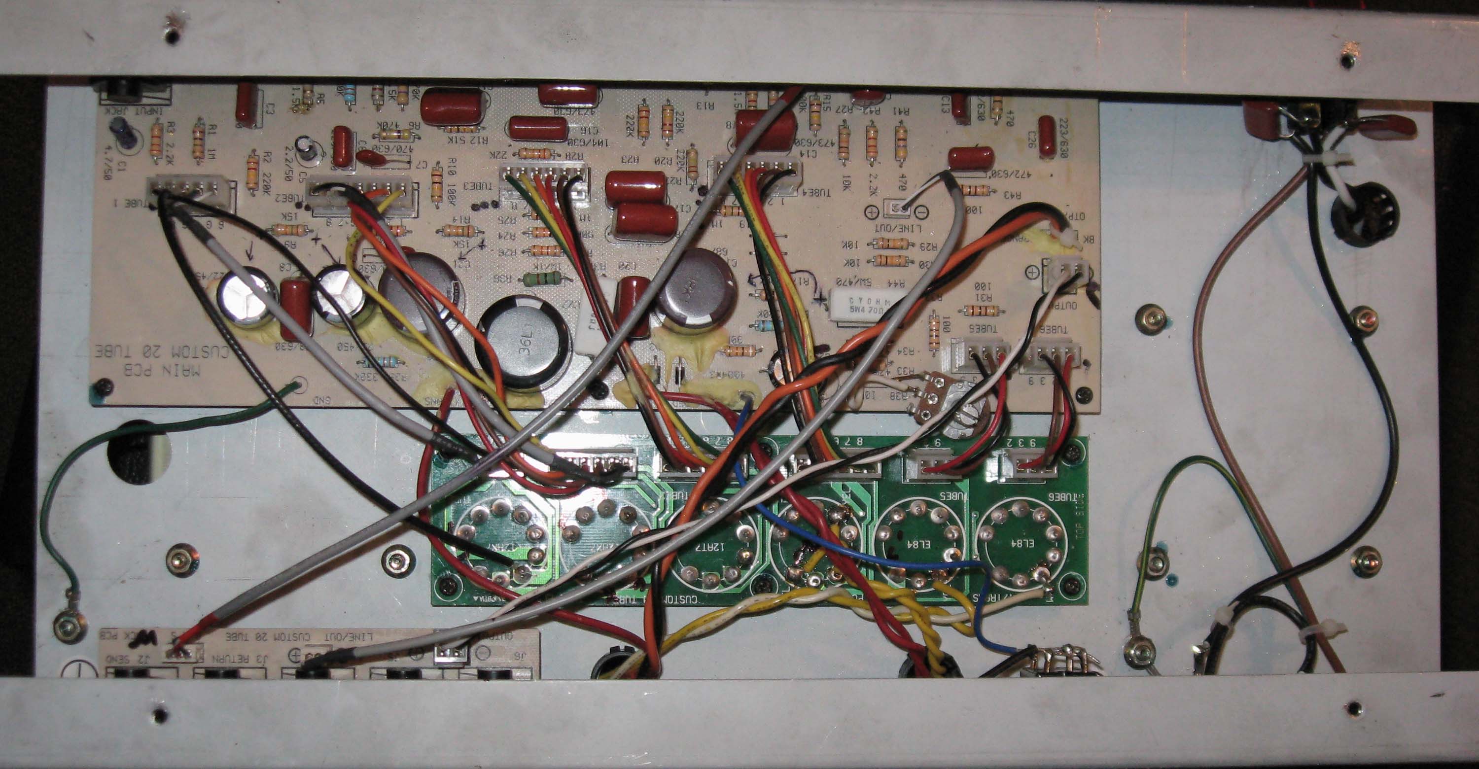

There is a problem with the wiring on tube 2.
There is a grey wire which has a blackwire on one end and a black and white wire on the other. The black wire goes to the Ground on tube 2 and the white to 7.
The ground was on very flimsily. I managed to recrimp it, but I am not getting a
continuity beep when I check the black wires. When I check the black and white I get a beep. Is that normal?
It looks like someone attempted to repair these by soldering but they have come loose.
Don't know if theyy were working properly.
Does this mean there is no ground on tube 2 possible source of hum?
Those gray wires are shielded cables. You should have 1 or maybe 2 conductors that connect at both ends, and an extra conductor that is grounded at 1 end only. You won't see that wire on the other side. That wire grounded on 1 side only is the shield for that cable.
There is a black wire and a white wire coming from the grey sleeve. at the board on tube 2. The black goes to G and the white to
7.
At the tube pcb there is only the black wire.
So it's working properly then? If I touch the multimeter on both black wires I don't get a beep.
If I touch the tube pcb black wire and the white wire I get a beep.

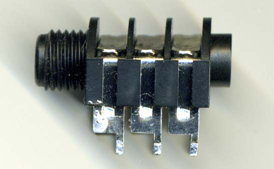

Here's a shot of the odd jack Hiwatt used.
It was not easy getting it out.
It's a reverse L-leg of some kind. Stereo Jack?
I've never seen this anywhere.
Anyone ever see this jack anywhere?
The Fender L-leg I don't believe will fit.
It ends up being too short for the screw.
Hopefully the Marshall PC Mount will fit.

That's a standard stereo 1/4 inch jack socket pcb mount type
I haven't been able to find one exactly like it though.
The legs are a little odd with the l in the back.
I was told this isn't a shorting jack.
I have a Marshall s-h504 pcb mount jack coming in which I think will fit.
Is a cliff switching jack the same as a shorting jack?

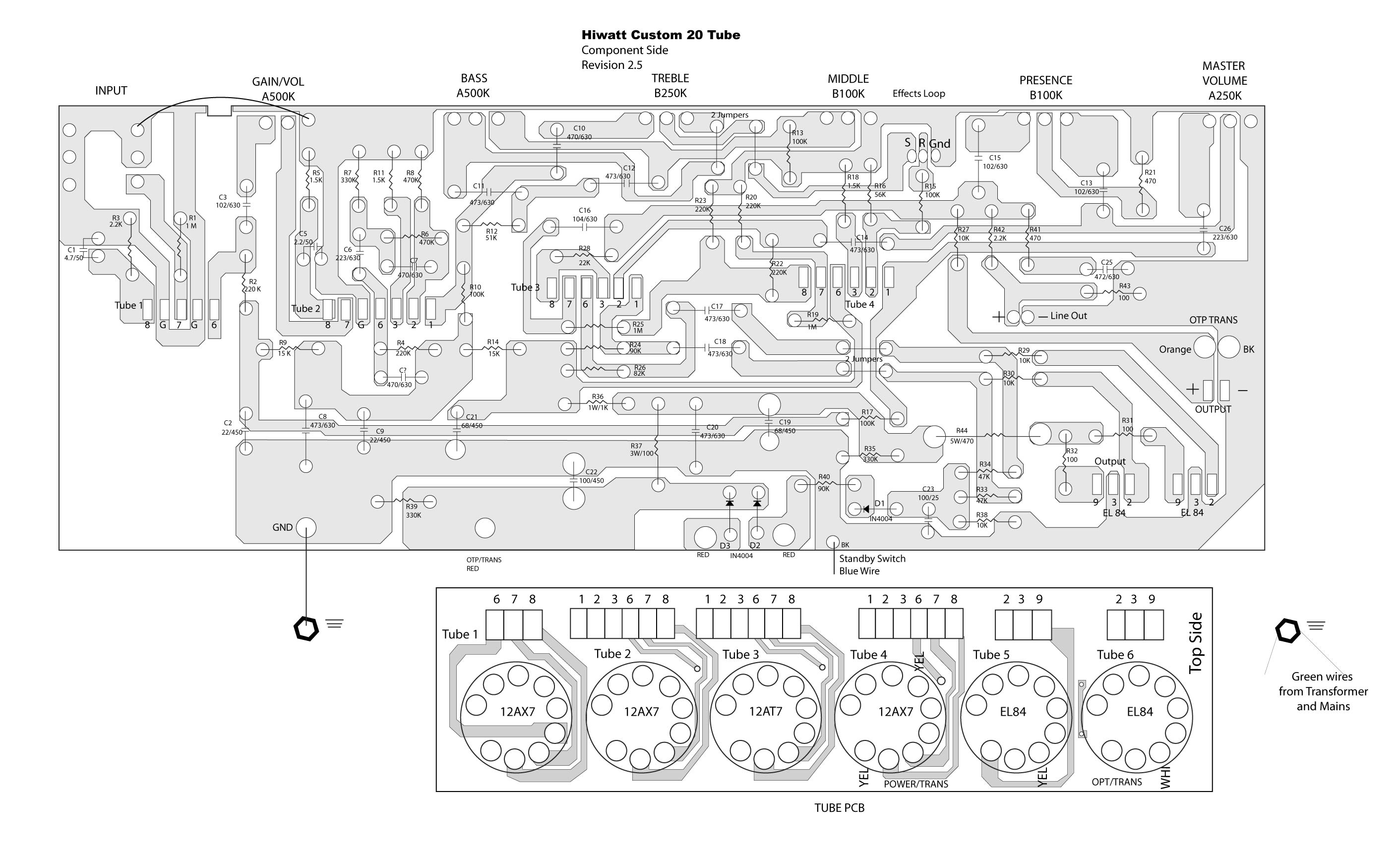

Here's an updated drawing of the board.
I added the tube pcb.
I'm still waiting for some parts.
If I wanted to try a 68k grid resistor, where would I put it?
On the tube pcb , tube 1 pin 6 and 7?
