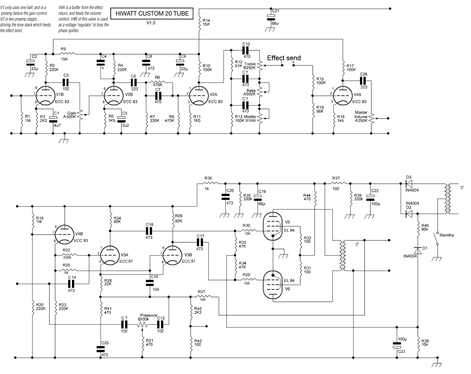

Okay, here's Nigel's schematic with a few corrections and just for fun, squiggly resistor lines.:)
It's not final, as I would need the amp to put in the remaining capacitor numbers.
I put in the tube socket numbers and pin numbers.
There were one or two errors on my layout so I'm going to post that later. Just one or two values were off. On the phase splitter I corrected a value(220k) that was a goof on my layout. Also put some of Nigel's comments in the top left corner.

He added a pot in place of the 10k resistor at R38 for the bias.
C23 was replaced with a higher voltage cap.
He told me it's not a cathode biased amp and that the original bias of -14 was too low,
and that it's class ab. Does that make sense?
What exactly is going on here? Is it still cathode biased or not or what was it originally?
I might tell him to put it back the way it was and to hell with it. Not sure what to do.
No its grid biased, the cathodes are tied to 0v, the method of biassing the valves is achieved by applying a negative voltage to them which is what the diode and resistors are doing...The cap voltage increase has nothing to do with the bias voltage which is set by R38.....
To set the grid bias correctly requires the anode current to be monitored with a milliameter...
If the biassing is set incorrectly you could end up overdriving the valves causing them to overheat the anodes...( look for a red glow! ) or just poorly performing...

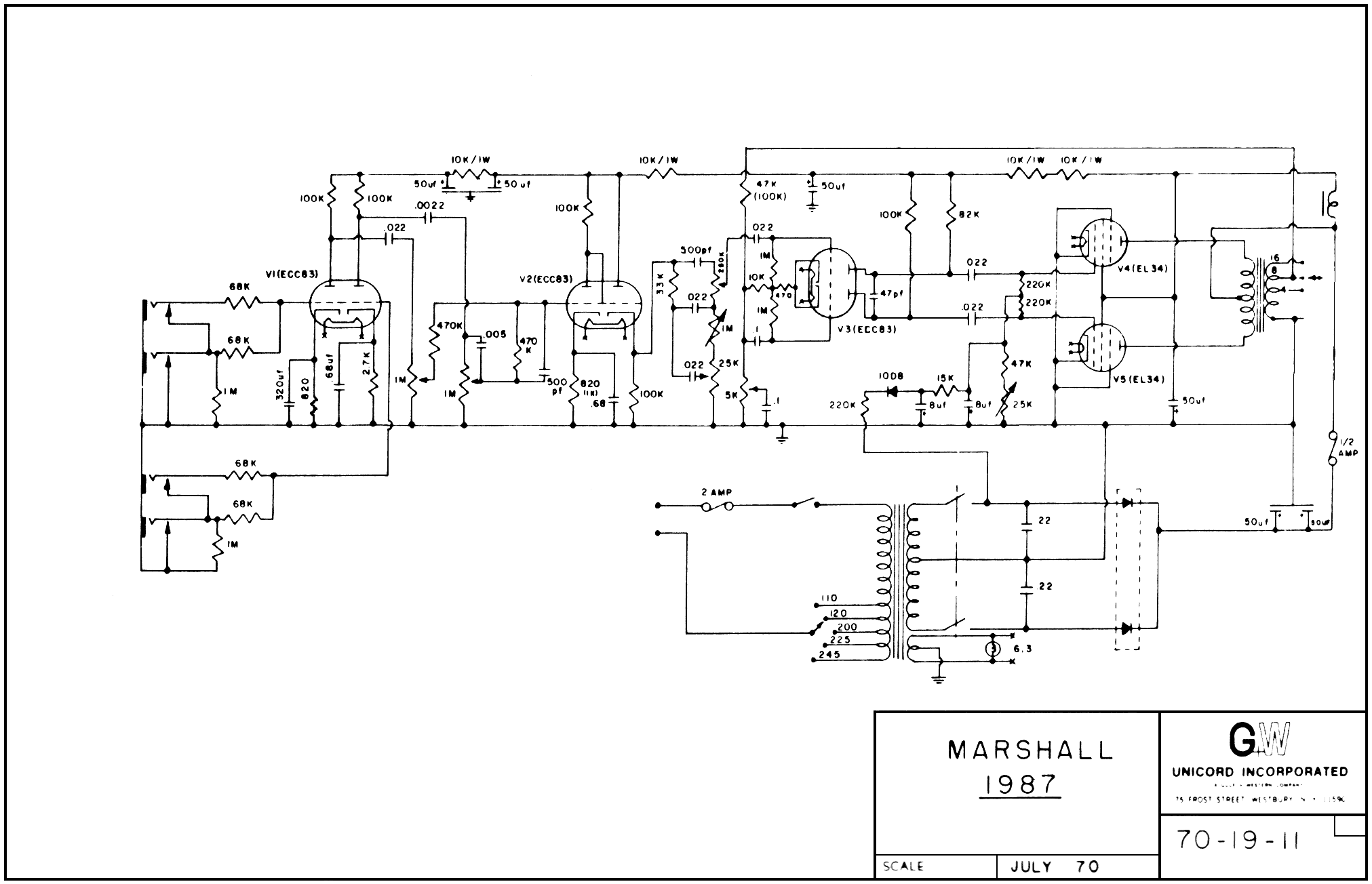

Output stages sometimes use a similar method, but it has the disadvantage that you lose power across the cathode resistor - so they often revert to the far older method of grid bias - where you apply a negative voltage to the grid, and adjust the voltage for the current you want. This has the disadvantage though that current though the valve will change as it ages, and be considerably different everytime you replace a valve. Because of this it's usual to have adjustments, either just one, or a seperate one for each valve - meaning you need to adjust it, using a meter, every time you change a valve.
Here's a circuit of a Marshall amp that has adjustable bias https://www.drtube.com/schematics/marshall/1987u.gif
Is the Hiwatt a fixed bias amp?

The bias setting ought to be fixed ( I didnt see a preset on the pcb layout you posted) ...or at least the maximum setting should be that the valves arent overrun to the point of excessive dissipation..
"I have seen some guides where -24 is considered okay for el84." It depends on the HT voltage....Like I said before, the setting is a function of anode current without over stressing the valves..
