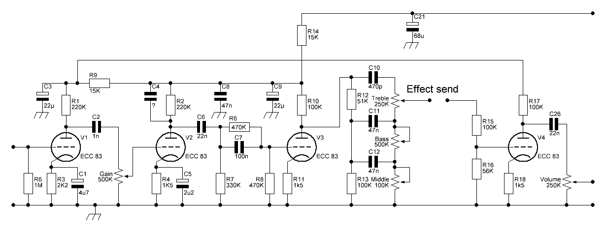

There is no schematic as far as I know, only the layout I drew.

How tough would it be to do a schematic from the layout I drew?
Pretty tough, because of the completely bizarre method of connecting to the valves - but from the actual unit it wouldn't take long at all.

I've had a bit of spare time today, so I've been drawing the preamp circuit, the first valve only uses one half, the other half isn't used, and is a preamp before the gain control.
The next valve is two preamp stages, driving the tone stack which feeds the effect send.
The last valve shown is a buffer from the effect return, and feeds the volume control. The second part of this valve is used as a voltage 'regulator' to bias the phase splitter.
BTW, ignore the value of C7, it should be 470pF.
Wow Nigel! You're a life saver!:)
This is tremendous work!
I can't thank you enough!
Is V3 actually V2A?
If you can finish it you'd be a real Christmas Angel!
This is exactly what these techs need.
By the way Merry Christmas!
