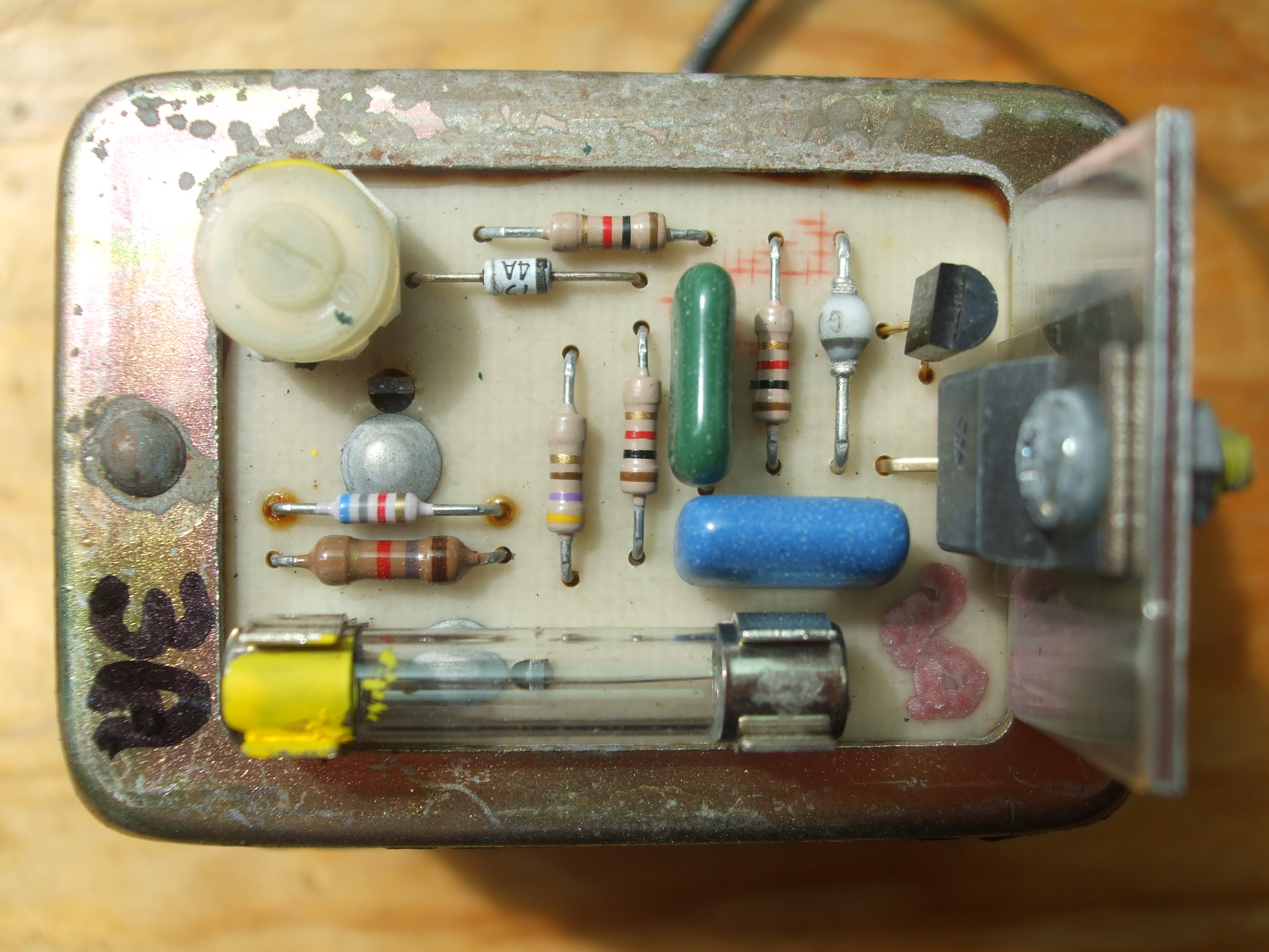

Here is one you can purchase.
**broken link removed**has a lot of alternator/VR parts.

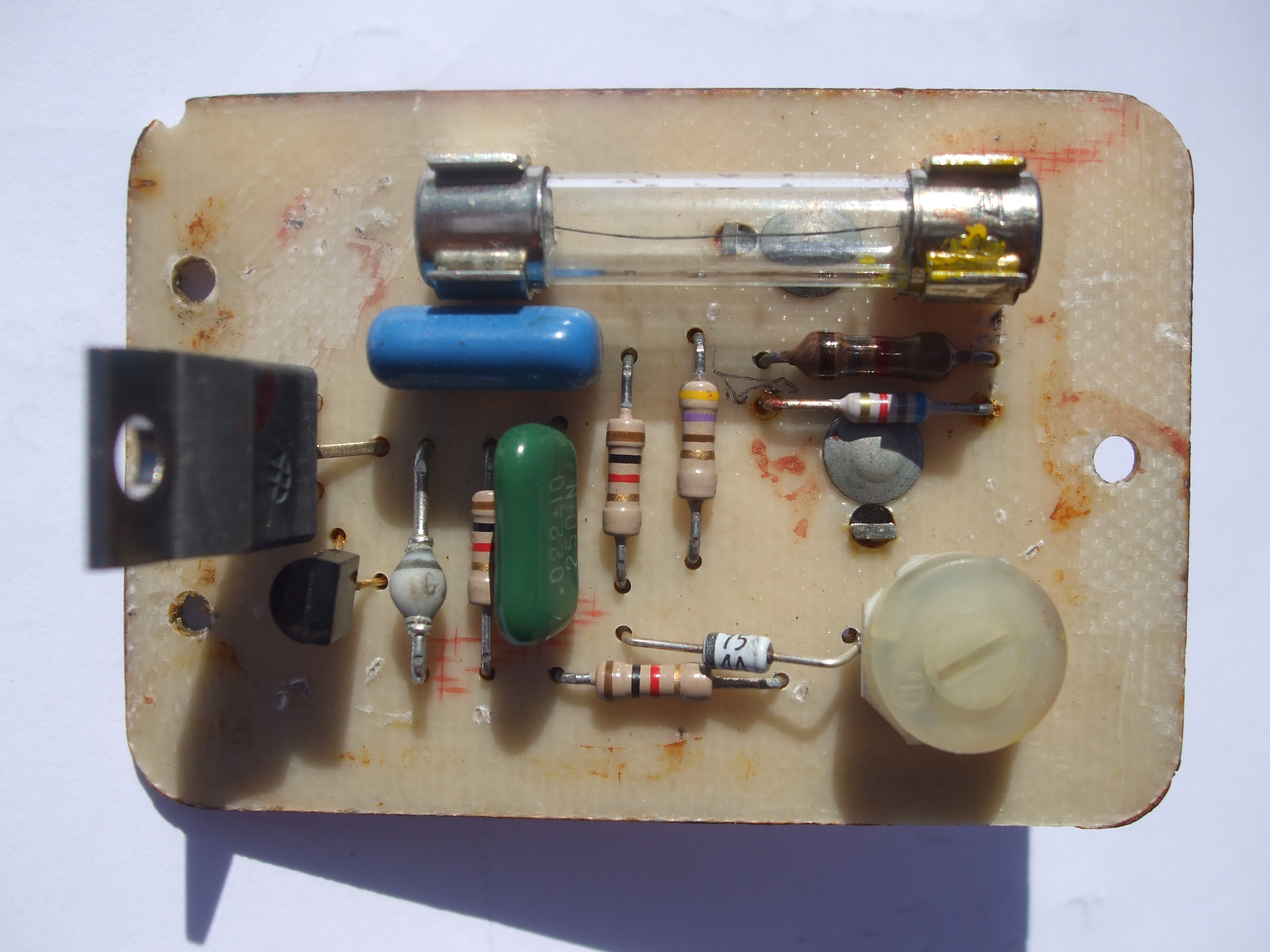

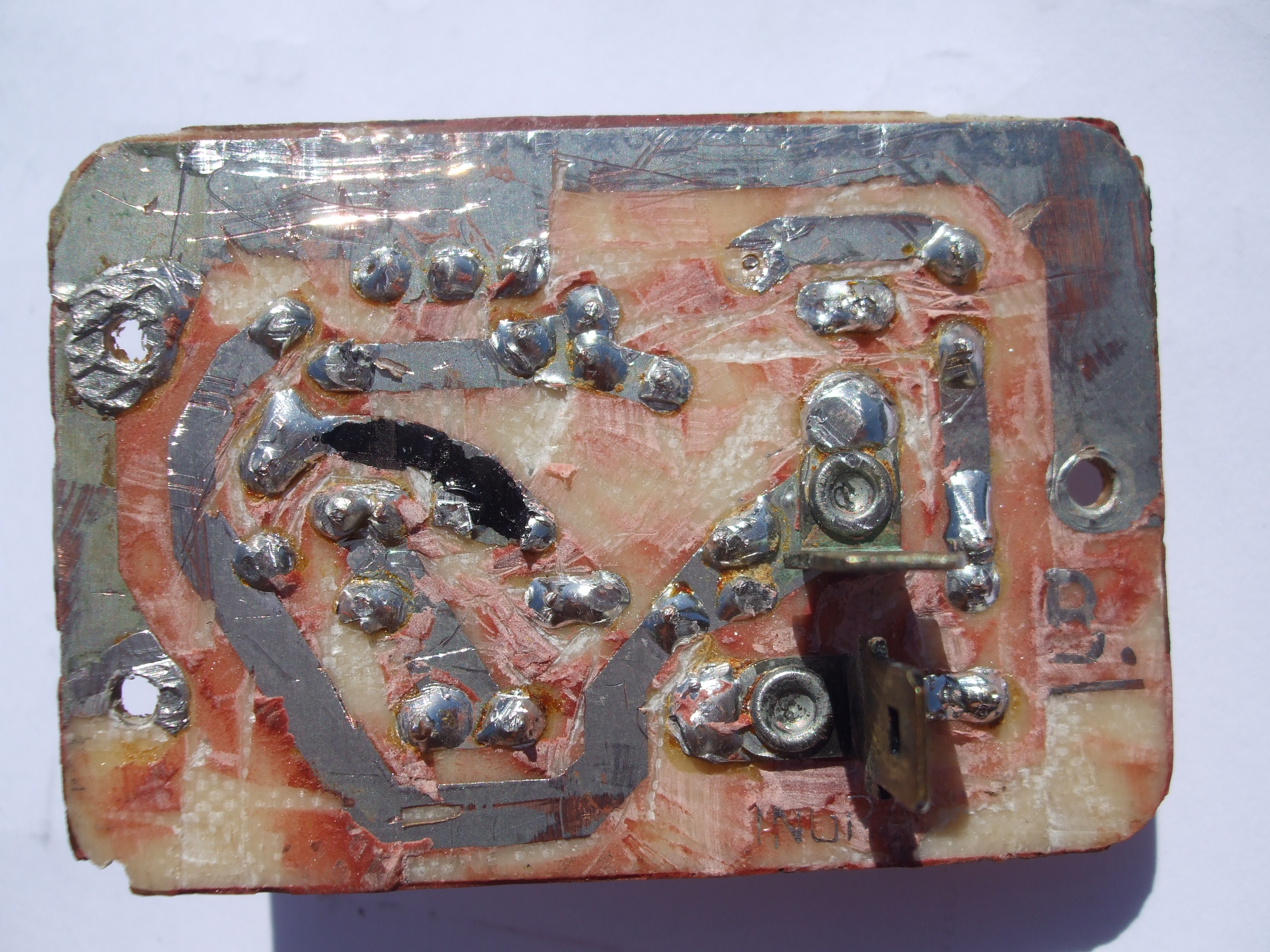

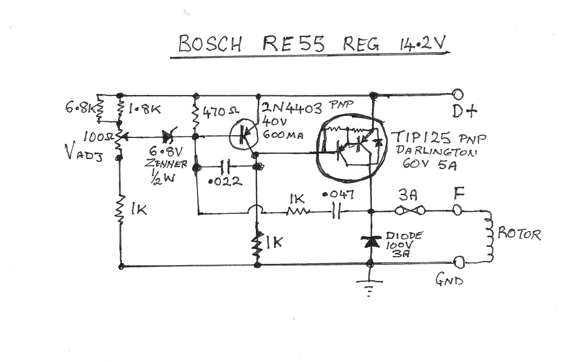

This is the reverse engineered adj reg which is quite easy to construct & work quite well. I rev engineered it as they were no longer available & I needed another one.

Very nice photos, that explains a lot. I'll have to look that over and think about this.

That side of the board was covered in resin, & yes it had to be chiselled off to reveal the traks.
