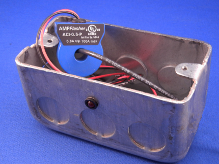

Explore the applicability of this :
Very nice. Needs no power!
I tried to make some of these but my cores were too small. I could only get 0.6 volts and that will not light a LED.
So if a 1 inch core is too big then probably all current transformers will not fit.
I like the CT idea and have tried that. My little cores need a amplifier and a power source, which makes thing big again.

Have requested info about ZMCT103C 5A/ 5mA Precision Micro Current Transformer Sensor Module
