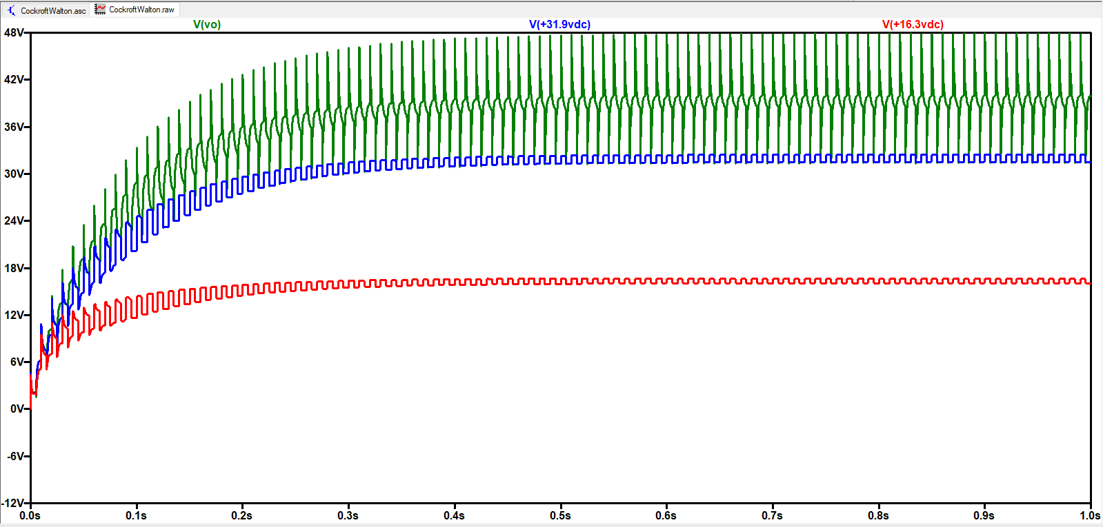

I was wondering if people could help me to understand the voltage doubler Colkroft Walton, because I'm not sure what even I'm dealing with as it even as a black box.
So if anyone can help me with these questions, I would be better off at knowing how good it is, if I swap over to it.
* is the output of a voltage doubler, ac, dc or pulsed dc? - by the look of the graph of PapaBravo, it actually looks pulsed?
* Can I supply a resistor on the output, and what would that do to the output of the machine?
If people are thinking I've got my sim readings wrong and it not actually functional, I dont blame u, my video explanation leaves alot to be desired sorry. Just a quick sorta confusing overview only!
. here I simmed it.
So it seems you can pass any resistance to it (on the output) and it doesnt affect it - works at infinite resistance.
