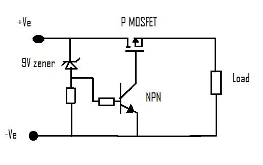

Hi All,
made a high side switch but it does not work quite how i want. I want a "snap" action from the switch. When the zener conducts the switch should be closed and when its not conducting open.
The circuit does this but its not very accurate. I am using a 9.1V zener but the switch actually works at around 9.6 to 9.7V. I want it to work as close to 9V as possible.
Can anyone suggest some improvments?

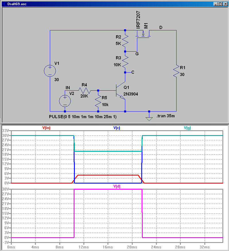

The P-MOSFET is connected backwards so power will flow through the parasitic diode all the time.
There is not pull-up resistor on the gate so even if it were connected correctly it would always be on due to the leakage current through the BJT.
Here is how I would do it. The source and drain are interchanged in your diagram.
Note the voltage divider R2/R3 and how it controls the source to gate voltage, keeping it less than what would otherwise blow the gate.
Note how I cause the small signal NPN to switch at ~2.5V, as if it were being driven from a logic signal.

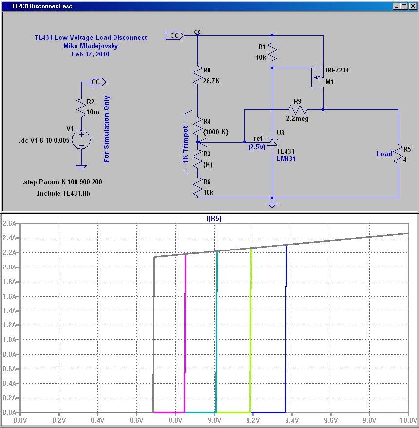

I missed the requirement that this be a voltage dependent switch such as would be used to disconnect a load from a battery as the battery discharges. I though that the OP just wanted a high-side switch, but I see now that he wants more.
Here is revised circuit. This one has hysteresis and snap-action. It is adjustable as shown.
Thanks for the replies. Yes my circuit is wrong, I drew it in a rush. I actually do have a gate source resistor in the circuit but I just never drew it. Regardless of how I've drew my circuit believe me it works. My problem is getting the thing to switch as soon as the Zener conducts. Where does the inaccuracy come from?
The Vbe of the NPN is ~0.65V, and it adds to the Zener voltage.
Ah yes, that makes sense. So I need 9v for Zener to conduct but also an aditional 0.7 for the vbe.
