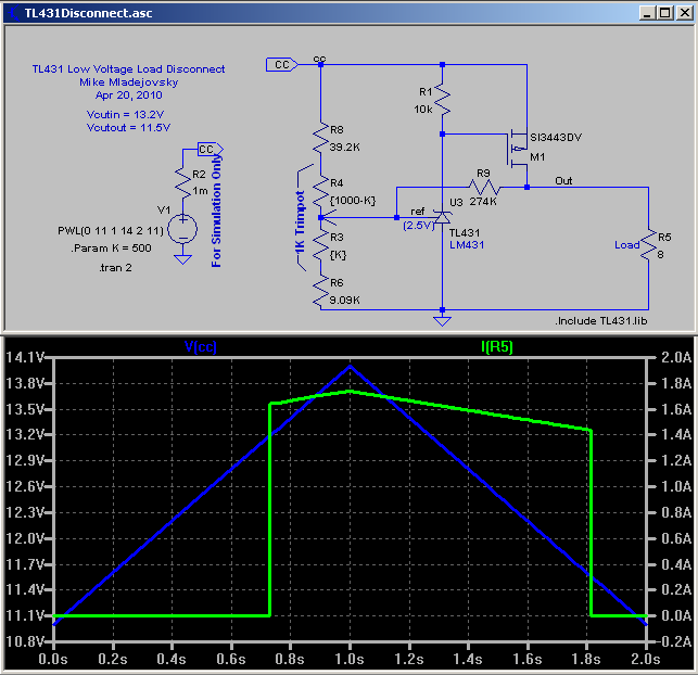

Yes. I recomputed the resistor values for a 12V SLA battery. Cutin at 13.2V, Cutout at 11.5V. I tried to use 5% resistor values. See attached:

Thank you!! How would I adjust if I want to cut in at a lower voltage, say between 12 and 12.5?
I need to be able to cut in earlier so that my pieces can angle themselves for charging once they do start to get some light in the morning. Fry's doesn't have any p-channel mosfets so I will buy everything i can and look for those at the one other electronics shop in town tomorrow.

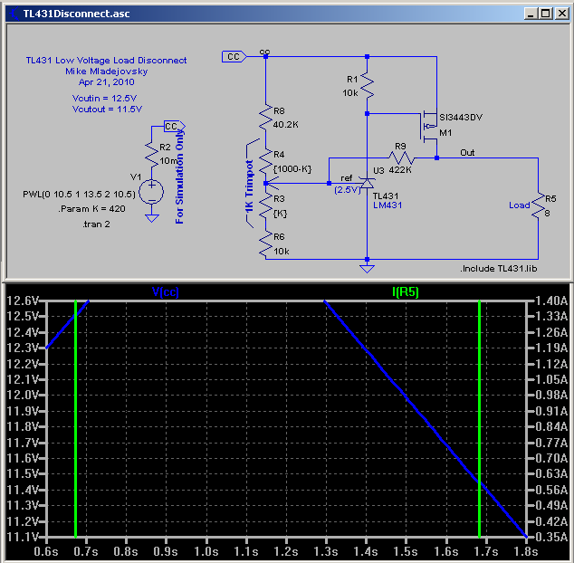

Would I lower R9 to lower the reconnect threshold?
Reducing R8 will reduce the both Cutin and Cutout together. Increasing R9 will decrease the hysteresis between Cutin and Cutout. I did that in the following sim. Starting from standard resistor values, setting the 1kpot at 42% of the way from the bottom gets the trip points to 12.5 and 11.5, respectively.

Fantastic. Bought most of the parts last night and found the mosfets this a.m. I should be able to fit the whole thing on a little board the size of a postage stamp... Haven't used mosfets before, very impressed they can pass 20 amps or whatever in a little TO220 package. I have some small heatsinks that will fit these. Most of the time these won't be handling more than 3 or 4 amps and occasionally ~8A or so for maybe 3 seconds, so these will be I think pretty robust in my application.
