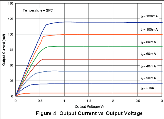

From the graph below a typical part will need 0.5 to 1V to regulate at 100mA.

You should allow for 2.5 V for each LED, as that is the maximum Vf quoted in the data sheet. On top of that you need to allow around 1 V for the IC, because it won't regulate to 100 mA at anything less. That gives you 26 V for 10 LEDs. Depending on what power supply you chose, you might need to allow for that to change a bit, but for now I'll assume that you can get 26 V exactly.
The typical value for the LED voltage is 1.7 V, so the voltage drop across the IC would end up as 26 - (10 * 1.7 ) = 9 V. With a total of 800 mA, you would get 7.2 W dissipated in the IC. The IC is quoted as having a thermal resistance of 31.8 °C/W, so you would get a temperature rise of 229 °C which would take you way beyond the maximum junction temperature.
You could reduce the voltage, and aim for the typical Vf for the LED, with a small margin on top. That would give you say 1.9 V per LED allowed for, 1.7 V typical. The voltage supply would then be 20 V, with a 3 V drop across the IC. Power would be 2.4 W, and temperature rise would be 76 °C, which would be on the hot side but probably OK if you are always keeping the electronics somewhere near room temperature. That runs the risk that it you get some or all of your LEDs that have a higher voltage, and so end up dimmer. It probably wouldn't be acceptable in production, unless the LEDs were tested first.

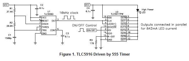

I don't know if you saw this, but there is just a Appnote describing how to run the part without a micro-controller. See appnote SLVA346–July 2009.
Here is a Snippet from the app note.

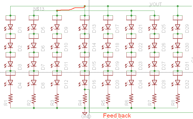

Here is part of a schematic I built a while back. This is 5VDC to LEDs. So I am boosting 5 volts to some voltage. (maybe 10V)
Note "Vout" and "N$13" are connected together.
There are 8 strings of 4 LEDs.
I used a resistor in each string. If one of the strings pulls too much current then the voltage across that resistor goes up and reduced the voltage on that string. It helps share current.
At the bottom you will see a line called "feedback". This goes to the PWM that is making the voltage. So Vout goes up until Fout=0.5 volts. Then Vout holds at that voltage, keeping the current constant.
I could have used 8 resistors to average the voltage across R1-R8 and fed that back to the PWM. (not much room on the board) So I just watched the current in one string and hoped the others are the same.

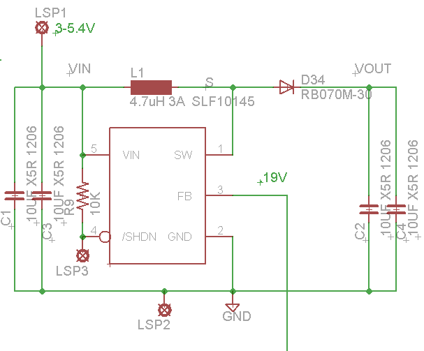

You could use one of the cheap step up regulators from Ebay with Ron's design (Post #12) They can be modified to provide a constant current source like this.
As you would have 8 chains of 10 LEDs the regulator would be providing about 19.25 volts (18 for the LED chain and 1,25 across the current sense resistor.) As you require 100 mA through each chain the resistors (R1 to R8) would need to be 12.5 ohms. (12 ohm resistors would be OK) The feedback wire from Ron's circuit would connect to the bottom of R2 in my circuit. (R3 and R4 would not be used.) The step up regulator could be fed with any voltage between about 9 volts and 17 volts so a 12 volt battery would be a suitable power source.

In the link Les Jones gave, the second schematic, is what I did (close). The schematic shows 300mA so you could use three if these. I think each will drive 3 strings of LEDs just fine.
I used a little FAN5333.
Hi Ron,
I've not seen that chip before. I like the low reference voltage so less power is wasted in the sense resistor. The ready built units from ebay are cheaper than I could buy the switching regulator chip. I have to admit that the added zenner diode was fitted AFTER one of the LEDs in the chain went open circuit and the regulator attempted to supply the set current into an open circuit destroying the output capacitor. (I was surprised that the regulator chip was not also destroyed.)
