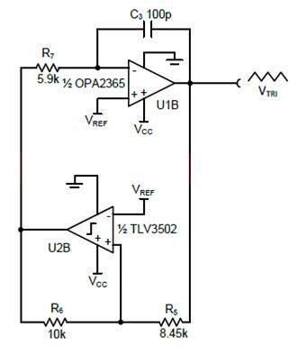

Dear all,
i want to build a very high frequency Triangle Wave generator.. My target is frequency of 36MHz and amplitude from 0V ~ 5V..
initially i want to use a DDS chip like AD9834 which capable of generating triangle wave..
however its max speed was only 75MSPS..
so my idea was to use opamp circuit as in TI documentation slau508 (refer to attached file)
according to my calculation , it needs opamp bandwidth 19 * 36MHz = 684MHz
and slew rate min of 360 V/us..
is my calculation correct?
i'm confused, because my simulation using LTSpice and LT1226 (GBW 1GHz, Slew Rate 400V/us Opamp) , the result was different
it only achieve around 8MHz triangle wave with bad triangle waveform..

I have been doing a lot of work on this recently. You really need a switching npn differential pair with the collector of 1 npn driving a current source of 1/2 the value of the differential pair current source. You need good high frequency transistors for your current sources and differential pair.

38 MHz is the frequency, so the one-cycle period is 26.3 ns. But this is a symmetrical triangle wave, so the slew rate period is 1/2 the cycle period, making the slew rate 10 V / 13.16 ns, or 1 V / 1.316 ns, or 760 V/us.
ak
ak
But the voltage is 5V peak to peak.
In 26nS the voltage goes from 0 to 5 and back to 0. So 10V in 26nS
OR
0 to 5V in 13nS so 5V/13nS
I get 380V/uS. If you want good linearity the speed of the amp needs to be MORE than the speed of the signal.
If you want 0 to 5V output. Then you need a -3V and +7V supply or something below 0 and above 5V. You can't use a R-R output amp. It looks like you need a 12V amp.
Because you are using LTSpice I looked at Linear and they don't have fast amps that will work above 5 volts supply.
I misread an earlier post and thought the requirement was for 10 Vpp. oops. Even at half the slew rate, this smells like a current-feedback opamp application.

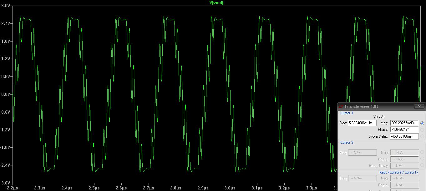

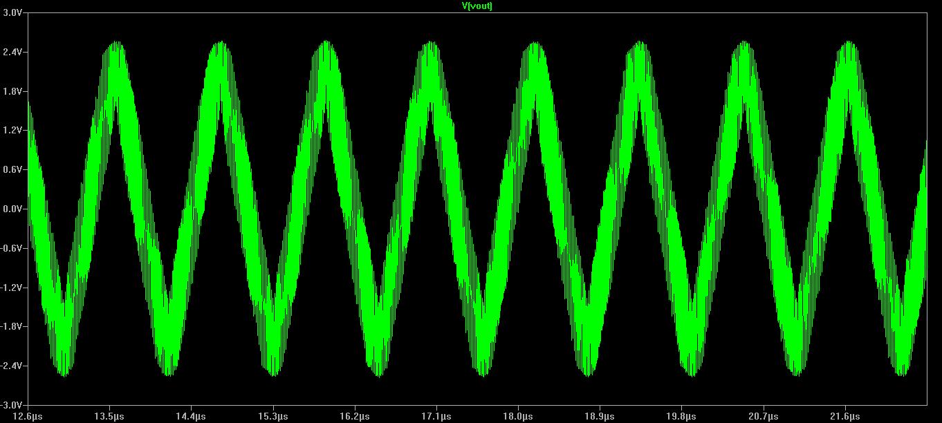

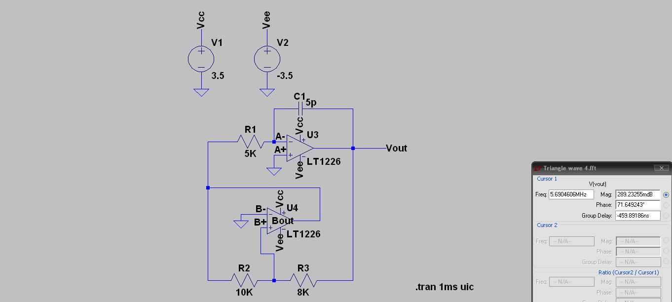

Post your .asc LTspice file.
please refer to attached file for the asc file..
i simulate using LT1226 (Slew Rate 400V/us , GBW 1GHz) , but the result was bad
the triangle signal was contaminated with sine wave.. and the freq of triangle was only below 10MHz

  • Triangle wave 4.asc
