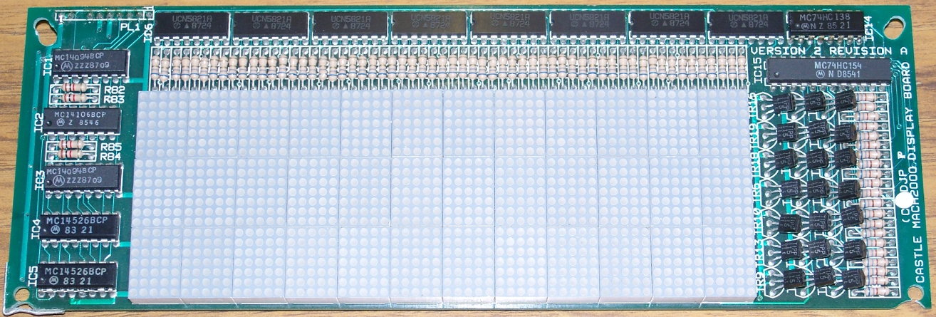

Hello. I have query, if resolve you the problem with draving SP.ACE MATRIX DISPLAY BOARD, about which yourself wrote. I have same board and I don't know how she control. Thank you. I am sorry, my English is not good.:)
I found a neat little display board lying around in the shed which I got from an old Bandit/Fruit machine. It was probably used to create moving pictures as you regularly see on bandits.
It has 3 rows of 12 (36!) dot matrix LED Displays on it. Each LED Display has 5 x 7 LED's segments on it (that's 35 LED's each!) :) The part number written on each LED Display is LTP757R, Also on this PCB are 15 IC's, 21 Transistors, and a load of resistors. There appears to be no micro controller on the board. The PCB has 1 connector/Interface, The connector has only 9 pins.
Now my question is probably one you'll laugh at but I grabbed this sometime ago thinking it might be of some use but to be hoonest although it looks to be a useful little gadget I can't think of a use for it, nor for the life of me can I even begin to think of a way to 'drive' it.
Has anyone got any idea's on what I could use it for? Novelty idea's are welcome.... If I could make it say "Merry Christmas" then change to say "Happy New Year" or something silly, Just so I can put it to some sort of use as a Xmas decoration if nothing else!
I'll be amazed if someone can come up with an idea and a simple enough driver to get this display functioning!
hackableFM..... :D
***EDIT*** Other markings on the PCB are "SP.ACE MATRIX DISPLAY BOARD" and ""VERSION 2 REVISION A"

I would very, very much like to buy it from you if possible please! :) I own a fruit machine that uses these and I've been looking specifically for a Rev2A display board for several years now.
If you'd like to have some fun with it first, I've sussed out how to drive it:
Pinouts:
1. - EN DISP
2. - DATA
3. - STROBE
4. - CLOCK
5. GND
6. PWR GND
7. +5.6V LOGIC
8. PWR GND (no pin / key)
9. +VDISP
10. +VDISP
To illuminate a single line, perform the following steps:
1. Clock in 64 bits for the column selects (bits 57-60 inc. are ignored);
2. Clock in 8 bits to select a row to drive (0x0 = bottom row);
3. Clock in 8 bits to determine the row brightness (0x0 = 100%);
4. Pulse the Strobe;
5. Repeat 1-4 for the next row.
NOTES:
1) All inputs are inverted.
2) Tie ENDISP to ground or you get nothing!
3) The input order of the column data is not what you'd initially expect! ;)
4) The logic and VDISP supplies can be from the same source.
5) Be sure to feed it at least 1 amp @ 5vdc.
6) Do not leave one row on for too long, you may blow a row transistor.
7) I've no idea what the scan frequency should be but a PIC16F960 @ 20MHz does the job nicely.
The guy who designed this board (and the rest of its control system) is one David John Powell (DJP), electronics genius of the fruit machine world. One day I hope to have a chat with him about his work!
Have fun! :)

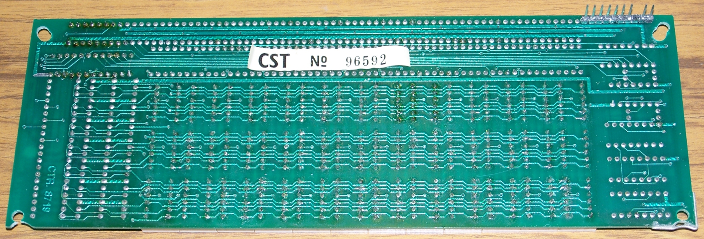

Well, here are the pics of my board, just a bit later than planned!!!
