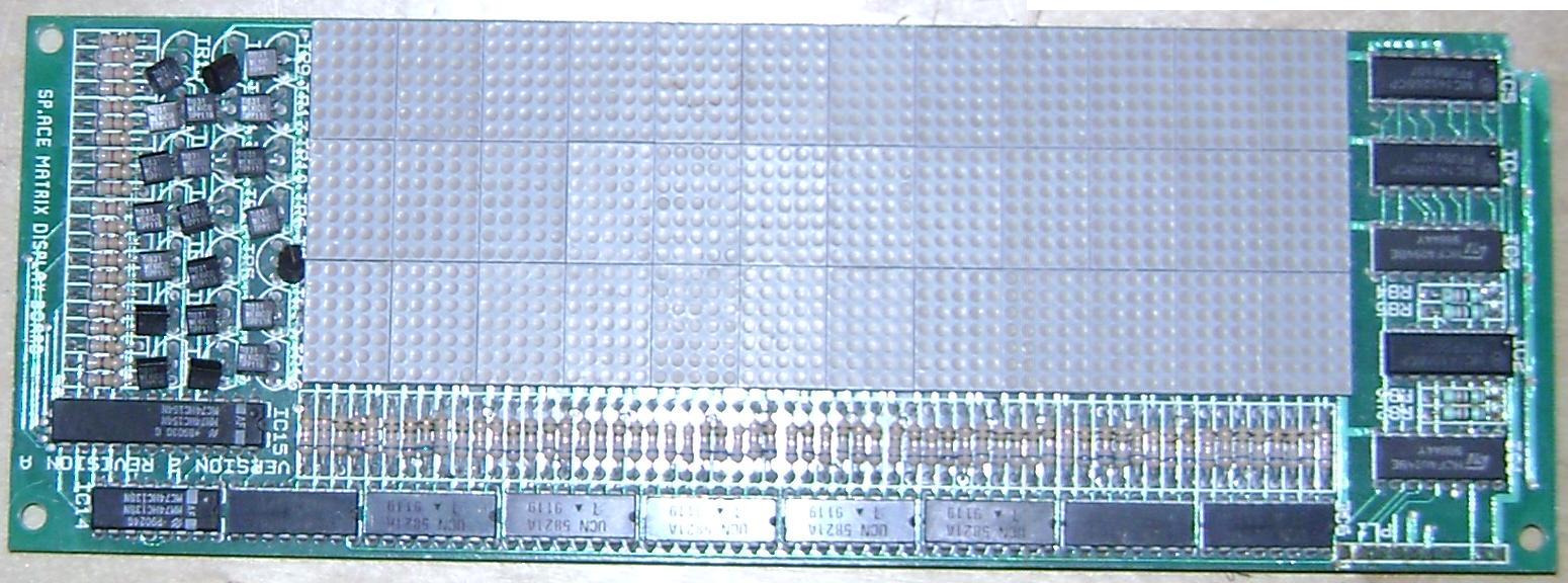

I found a neat little display board lying around in the shed which I got from an old Bandit/Fruit machine. It was probably used to create moving pictures as you regularly see on bandits.
It has 3 rows of 12 (36!) dot matrix LED Displays on it. Each LED Display has 5 x 7 LED's segments on it (that's 35 LED's each!) :) The part number written on each LED Display is LTP757R, Also on this PCB are 15 IC's, 21 Transistors, and a load of resistors. There appears to be no micro controller on the board. The PCB has 1 connector/Interface, The connector has only 9 pins.
Now my question is probably one you'll laugh at but I grabbed this sometime ago thinking it might be of some use but to be hoonest although it looks to be a useful little gadget I can't think of a use for it, nor for the life of me can I even begin to think of a way to 'drive' it.
Has anyone got any idea's on what I could use it for? Novelty idea's are welcome.... If I could make it say "Merry Christmas" then change to say "Happy New Year" or something silly, Just so I can put it to some sort of use as a Xmas decoration if nothing else!

I've attached a picture of it here anyway.

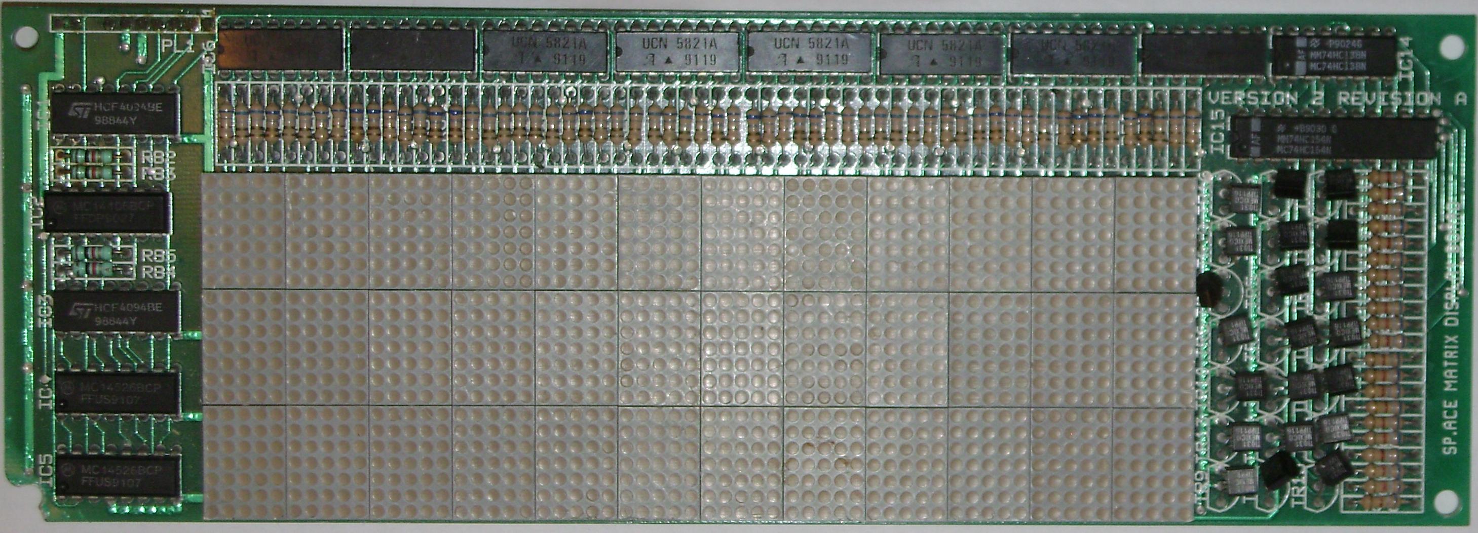

Here's a more detailed picture.
And I'm keeping my fingers crossed.
Thanks.
FM.
The 74HCT4094 at IC3 is clear enough. The rest are indistinct. Zanes says there is (are?) 4526(s) there. Kindly give me the numbers off the ICs and identify which these are by the IC number, i.e., IC1 thru IC5. F'rinstance:
ICs 1,3, and 5 are hct4094, and IC2 and 4 are (HEF?, HCF?)4526.
The 4094s are, like the 8521As across the bottom, chips you load serially and then latch in the info in a parallel fashion. They lack the powerful outputs though, so that suggests that these are actually driving some (all the?) transistors. 'Depends on how many there are. Perhaps the HC154 is used for other things, but my bet is it's driving 16 transistors based on the last 4 bits in the 8521As. We have too many gates here just to drive LEDs. I wonder if this read switches and passed their bit values back to the processor?
Anyways, I notice three heavy traces at the 9 pin connector. These are probably ground, 5V for the ICs, and a slightly higher voltage (6 to 12V?) to power the LEDs. Whatever, whoever, with 21x60 LEDs at 10 to 15 mA each, you will have to provide some serious power to this puppy!

IC1 = HCF4094BE
IC2 = MC14106BCP
IC3 = HCF4094BE
IC4 + 5 = MC14526BCP
IC 6 - 13 = UCN5821A
IC 14 = MM74HC138N
IC 15 = MM74HC154N

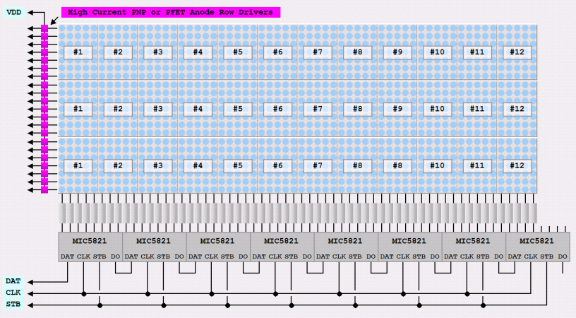

Hey guys,
That hardware looks remarkably similar to some of the designs I've come up with these last couple years and as kenjj has suggested, I suspect "we" could come up with a full schematic with just a little bit more work.
oem-21x60-matrix-small-png.18040
I typically connect the output enable pins and the strobe pins together on all of the MIC5821 chips and drive them with the PWM output pin from the PIC. This provides a simple mechanism for strobing the MIC5821 shift register data onto the output pins and controlling the display brightness and it also allows me to multiplex the interface pins for use as row driver lines during display on time and as DAT lines to load the MIC5821 shift registers in parallel during the display off time. I doubt the manafacturer is doing that here and suspect that the MIC5821 chip DAT lines are daisy-chained. We'll need to determine how those MIC5821 chip lines are wired.
We also need to see if the HC138 and HC154 outputs are indeed connected to the row driver transistors and how the other few chips are connected to the HC138 and HC154 inputs.
All in all, that looks like a nice bit of hardware but if it's set up to scan 1 of 21 rows that's really a pretty low duty cycle and so it means you may need a rather hefty power supply to provide the 'peak' current necessary to light up to 60 LEDs in a single row to decent brightness during a single row scan period.

Nice drawing, Mike.
Yes, at 10 - 15 mA per LED, that's 50mA or more per segment row, 600 or better for all of them. Those transistors don't look terribly beefy, but they probably only operate for 20 to 30 milliseconds (?) at a time, so no harm done. And you're not likely to operate all the LEDs in all segments (LED test, anyone? Fryyy-y-y!), and a character display will have an unused row and column of LEDs to deliniate the character, so 11 LEDs per segment go unused in this case. Still, plan on a one Amp supply, at least 500mA, just considering the displays.
The questions of the hour, for me, are A. do the 138 and 154 drive the row transistors, and, if so, which chips drive them? If not, we have C.: what the H* does drive the transistors?
