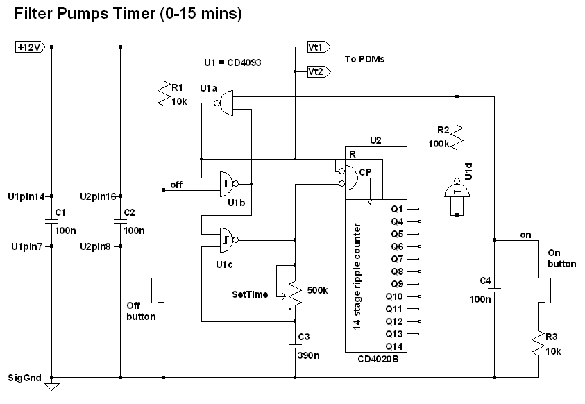

Here's the timers schematic, Joe. I've tried to use components you probably already have in your spares box. Pumps should start up at power-up. Press the 'off' button to start the timer. Time is adjustable ~0-15 mins with the 500k trimmer/pot. I've included an 'on' button too, in case you want to stop the timer prematurely or in case the pumps don't immediately turn on at power-up (which is possible if the time the power supplies take to ramp up exceeds the power-on-reset time I've designed into the timer).
  • FeedTimer.asc
Hey Alec, that timer looks fantastic! I'll have the switch up by the tank where it can't get splashed. A very nice finishing touch, thanks. If the pumps don't immediately turn on at power-up and I do nothing, will they come to life in 15 minutes or so?
First I'm giong to wrap up the battery backup. It looks like only one diode needs switched out-after that a few additions should do it. Thanks a million.
Should do. BTW if you want even longer feed times you can increase the value of C3 (e.g. put another 390nF cap in parallel).
