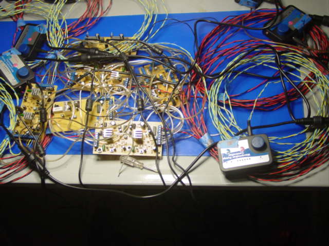

Everything works as planned except we have 24V coming the wrong way through at least one PS backup diode and into the PDM again. I replaced 3 diodes yesterday and checked them before and after installation. This diode is not one of those 3, but I checked all diodes and they all looked good yesterday. Any ideas?

Wow. Are you sure that's not a telephone exhange you've got there?:D. I can see now why KISS was advocating a DIN rail system of interconnected modules.
As for the spurious 24V, logically it seems either a diode is faulty (despite your checking) or your telephone exchange has a crossed line. I can only suggest re-checking.
As crazy as that bird's nest looks, I was methodical about hookups. I am confident there. The two pairs of pumps on tide (flick too!) and two pairs of pumps on wave seem happy to do their thing.

BTW, the gob of wires is not as bad as it looks. The picture includes the 8 full length coils of wire that will be used when these pumps are in the tank. I wanted the bench test to be realistic. Plus the new controllers won't be near the PDMs and our controllers.

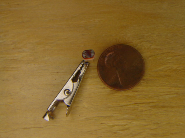

BTW, BTW, the little light sensor https://www.electro-tech-online.com/attachments/tank-011-jpg.73813/ is a variable resistor of sorts-the resistance changes with light intensity. What a neat little thing! A 2K2 resistor in place of the light sensor nicely defeats the night mode.
That's a convenient solution.
