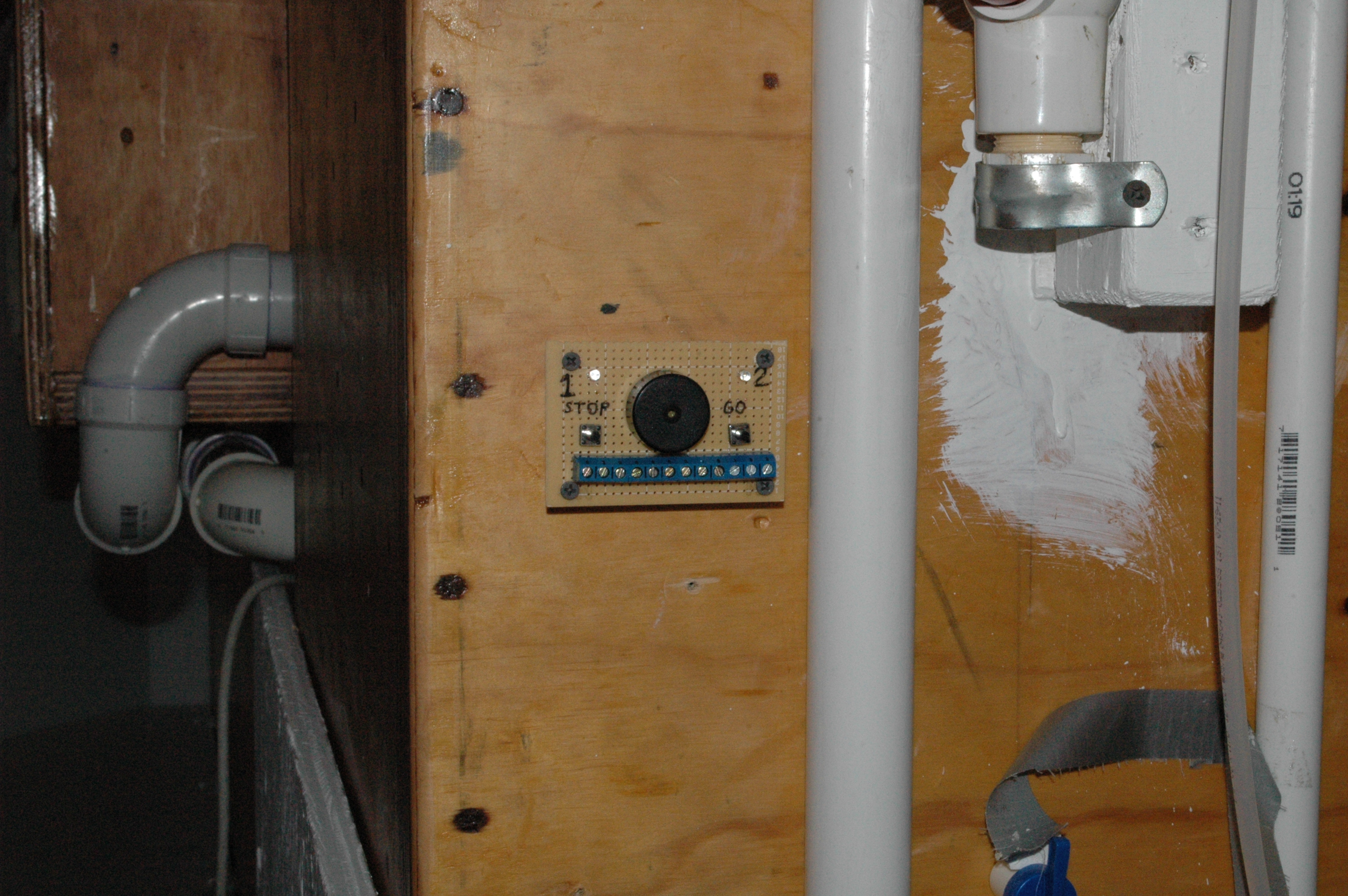

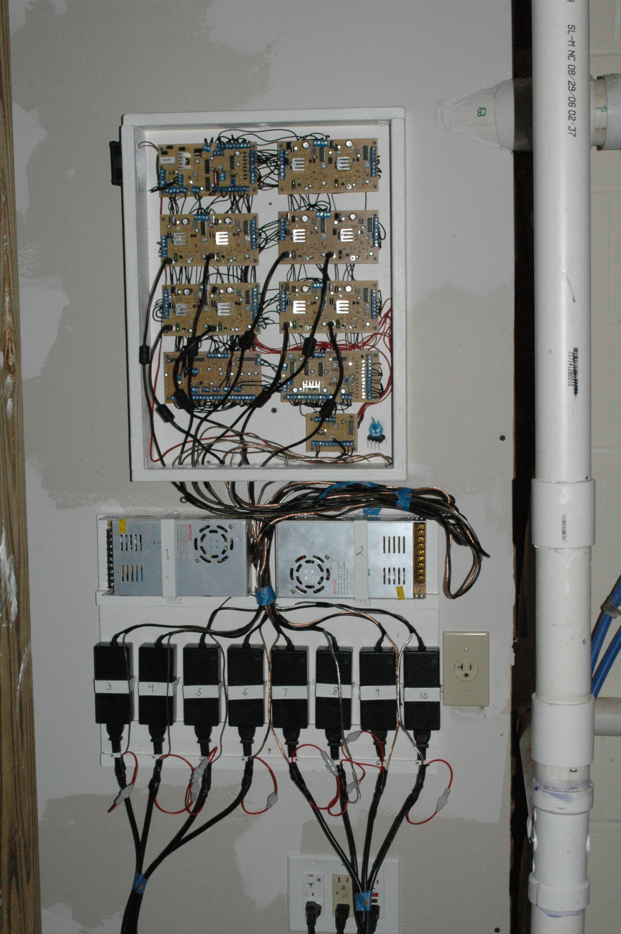

Here's the circuitry and power supplies mounted on the wall in what will be the control room. Just a closet sized room in the basement under the tank. The second pic is the mini board at eye level as you walk into the fish tank room. It's hard to see, but it has a red LED for each filter pump as an alert.
It's not hooked up yet, but I wanted you guys to see the almost final configuration. I made a minor change in the tank/filter plumbing that needs wrapped up before the tank gets refilled.
Thank you guys for helping me put this amazing system together. I really appreciate the nudge you gave me to incorporate the fault sense module, Alec. The FSM is awesome, I love it! When the pumps get fired up, I'll let you guys know how intense the water movement is. Thaks all, from the bottom of my heart, for hanging in there and seeing this through. You are the best!

Nice. A really professional job, Joe. No one would guess this is you first electronics project! I'm sure the tank occupants will appreciate it :).
Thanks Alec-that means an awful lot coming from you!
