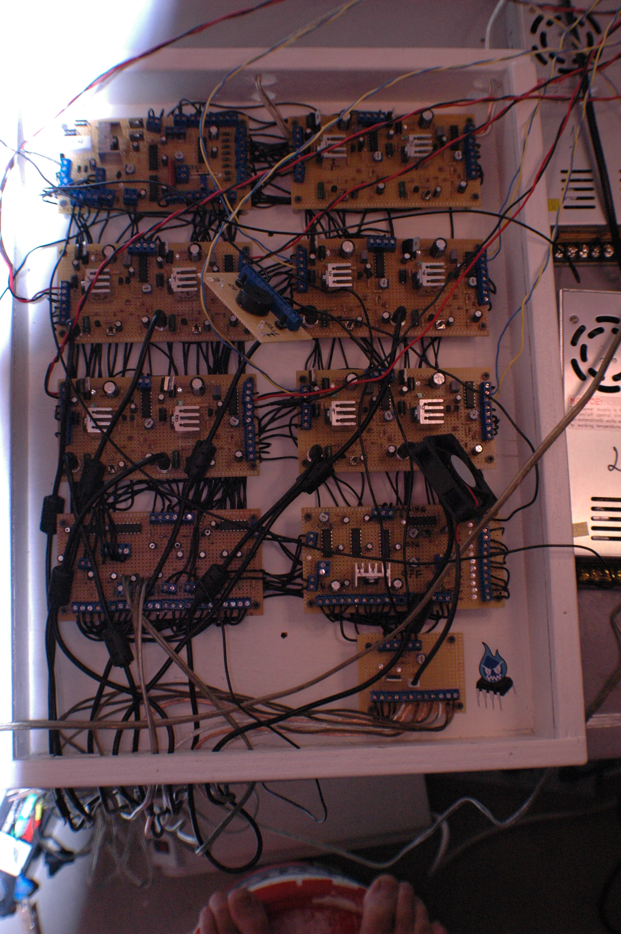

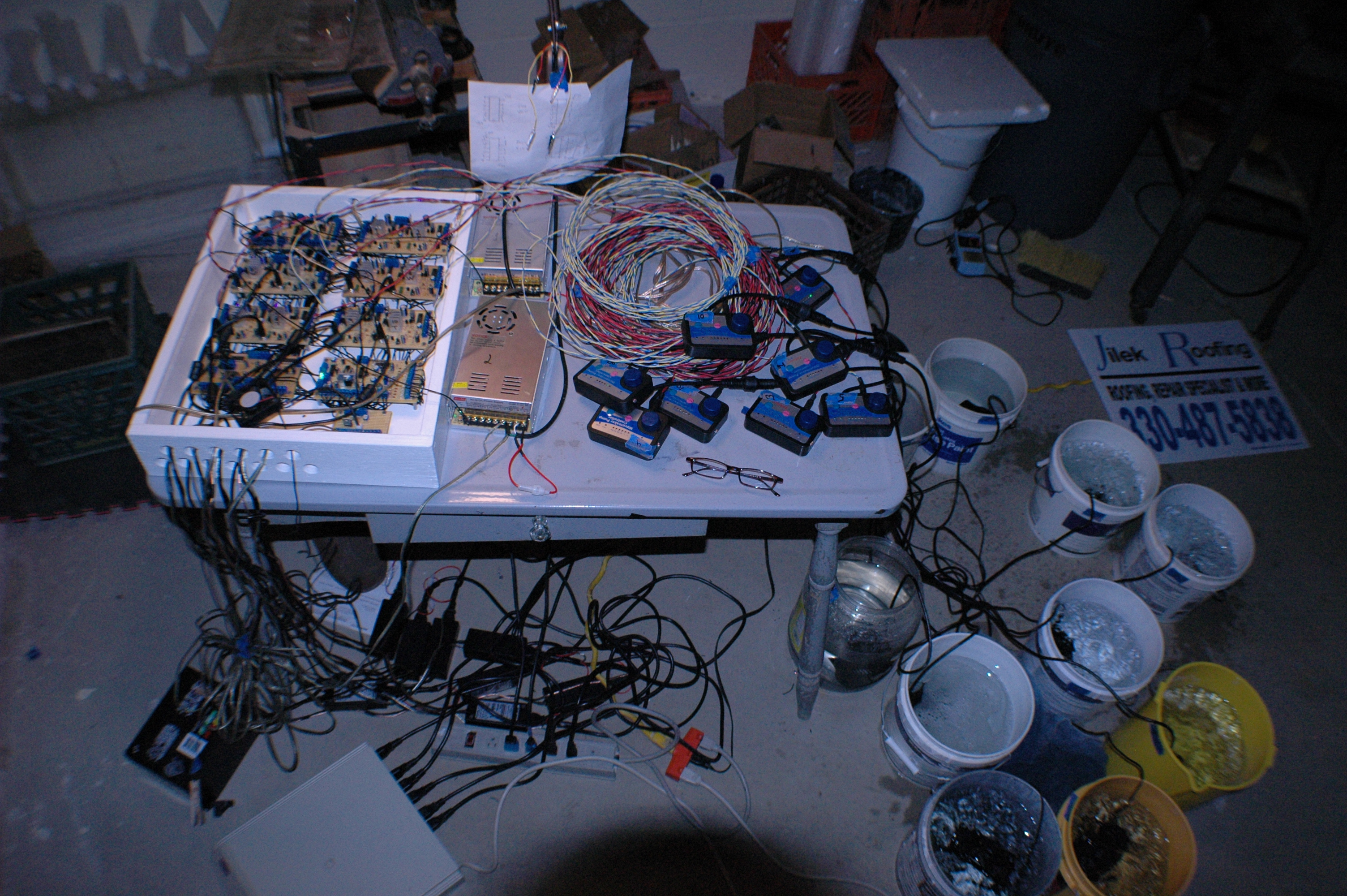

Got this thing all wired up and all systems are go! Flick, wave, tide, battery backup, charging system and fan, fault sense module. It seemed easier to hook up with the circuit boards fixed in place. It's still kinda messy because the pump leads are in a temp hook up and the dangling little board will end up in the fishroom and the fan will need to have its' leads lengthened and fastened to blow on the LM317.
One small glitch on one of the tidal PDMs. When the trip is pushed for the alarm, the pump and pump LED turn off and the alarm sounds. The red red warning LED lights up, but as soon as the alarm button is released the pump LED and pump go back on. Meanwhile, the alarm and red LED stay on for the normal 30 seconds or so. The Pizo has a broken chattering sound on this PDM. The pump toggleslike it's supposed to so I don't know if taking the PDM apart at this point is worth the risk. I checked the ground and it looks good. Speaking of ground, thank you Alec for the grounding diagrams. They were absolutely invaluable. This entire system is a masterpiece. I can't thank you enough. Also, thank you KISS for hanging in there with us. Your troubleshooting skills and insights were a tremendous help. RonV and anyone else who contributed, thank you one and all.
Once this is mounted to the wall, I'll get a final pic posted. I can hardly wait to see how the system moves the water.

Good work, Joe! Be sure to have a backup of all the schematics and of this lengthy thread!
Check D4 in the PDM, and the connections from U1a output to D4/D10.

D4 and D10 both look good. The cathodes of D4/D10 are connected to pins 2 and 4 of U1a, and I could not find any debris or anything, so IDK what the deal is with that PDM. I'm prettyy sure that PDM tested good before I set it aside, is it possible that a glitch in the FSM or something else is to blame? Could a tiny bit of water be stuck inside the IC, from when I washed them? I can live with one pump not being protected, just wondering.
