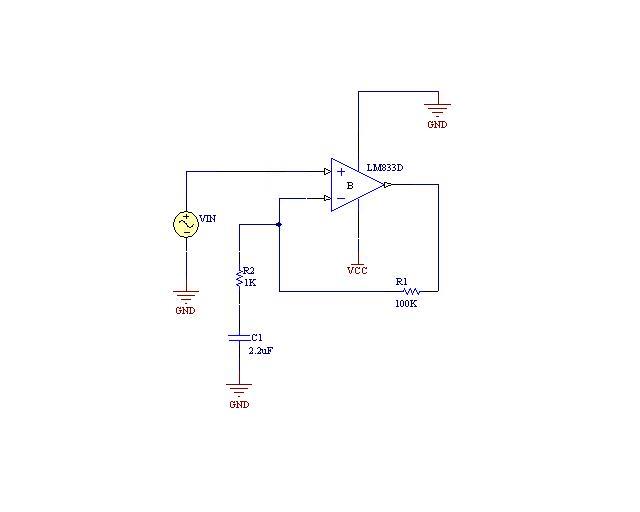

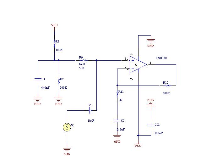

Here are the schematics for the first stage (first attachment) and second & third stages (2nd attachment) The overall gain according to the schematics is a million but I'll be reducing that by changing the feedback resistor in the second and 3rd stages.

The datasheet for the LM833 shows a minimum supply of 10V but yours is only 5V so of course it doesn't work properly.
Your second and third opamp stages have no DC input voltage reference (at half the supply voltage) so of course they don't work.

It looks like your circuit would work but you have to raise the supply voltage to more than 5v, like at least 10v or even 15v to get it to work right. The reason is because the op amp you chose does not work correctly at that low voltage. If you really need to use a supply of only 5v then you do need to select another op amp that can work down that low, and if you need rail to rail output then you need to make sure the op amp can do that too.
Try raising the voltage to 10v and see if it works better.
I'm a bit confused. Doesn't it say on the LM833 data sheet I attached that the supply voltage can be ±2.5 to ±15V under "operating conditions"? So as long as the difference between the two supplies is atleast 5V and no more than 30V it should operate correctly?
Also the reason why there's no DC bias required for the second and 3rd stages, is because the output of the first stage is already biased at Vcc/2 (i.e. there's no decoupling cap between each stage)

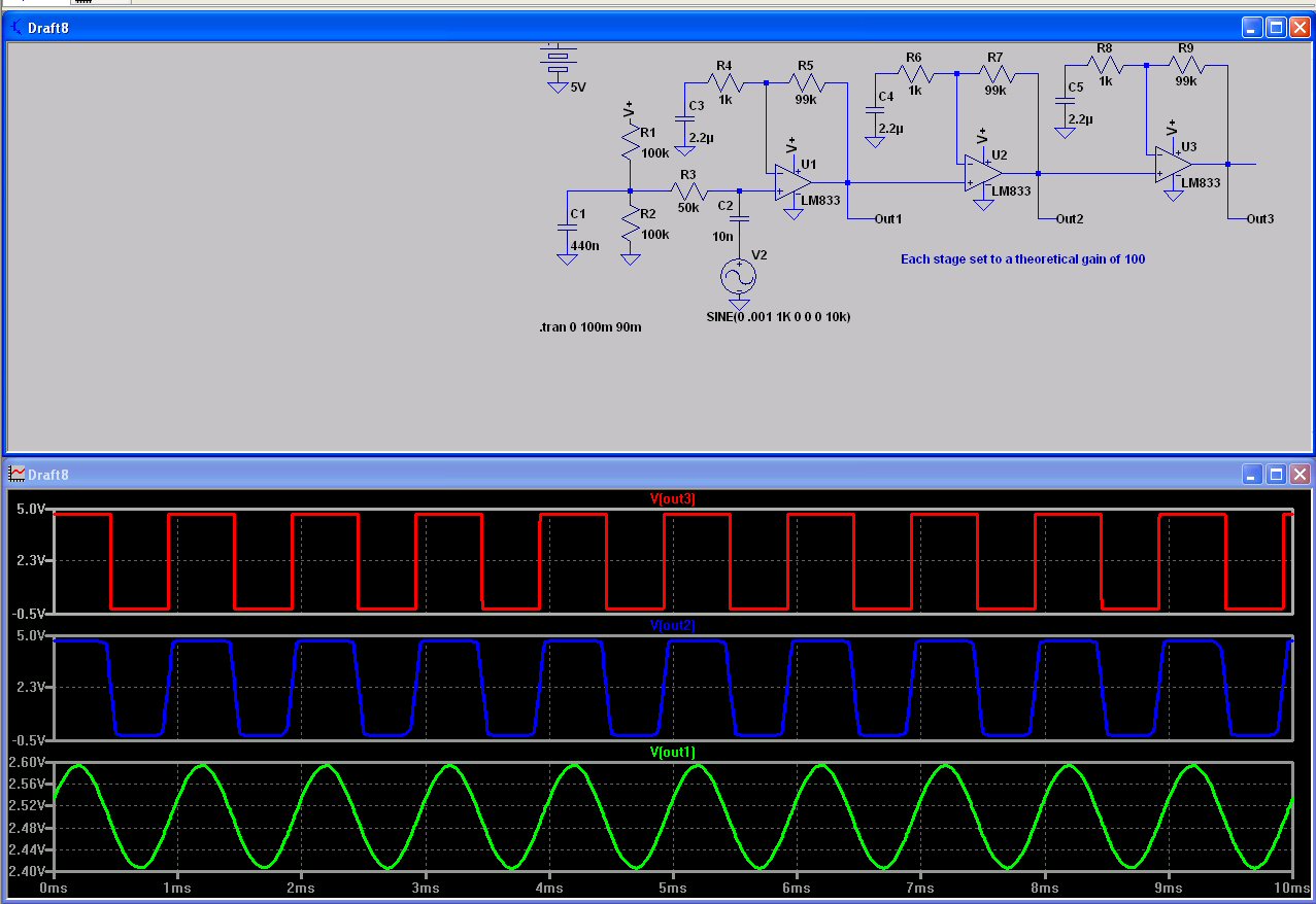

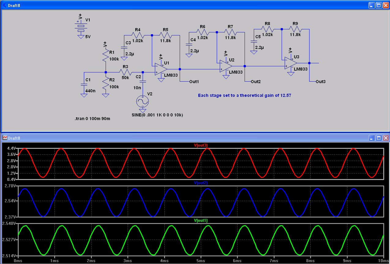

Don't be confused. The ST datasheet is correct. OnSemi & National's datasheets do not list the range of Vcc. To double check, I ran a sim with the LM833 (Cadence motolib model) with Vcc at both 5V & 10V with 1mv peak input and both came out with a gain of 93.71 in the same configuration you posted for the first amp with a gain of 100. You are correct in your thought that +/-2.5V is equilivant to Vcc=5V with Vee at ground and a pseudo-ground of 2.5V.
Your second statement is also true as you can see in the attachments posted below. The only thing is, if you must have three stages, I would suggest you distribute the gain over all three stages rather than trying to get the lion's share up front. With Vcc limited to 5V, you are set at around a gain of 12.6 per stage before clipping begins at the third stage with an input of 1mv peak. Perhaps it would be cheaper to go to two stages with a gain of ~44.7 each to reach the max gain of 2k at 1mv peak input. Or what ever you need as you left certain parameters out of your description of what it is you are trying to accomplish.
Anyway, and to answer your initial question, I would go with the LM833, which is a very close match to the MC33078 I have often used in designs and a proven stable amp. it may not be a total rail-to-rail amp but it does work fine if not overdriven.
