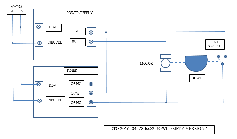

NOTES
(1) Mount the limit switch so that, in the vertical position, the bowl actuates the limit switch to take up the state shown in the schematic (12V not connected to the motor)
(2) As the minimum timer switch operation is 1 minute, the bowl will rotate for 1 minute before coming to rest in the vertical position. This will help ensure that the bowl is clear of debris, but if this is a problem a simple addition can provide one revolution only.
(3) A battery version could be configured. The battery would not need to be recharged for over a year, but a battery operated timer would need to be found. If push came to shove, a modified digital alarm clock would do the job.
(4) For safety, connect the 0V terminal of the power supply to earth.
(5) It should not be necessary, but if the bowl overruns a braking resistor/diode can be added.

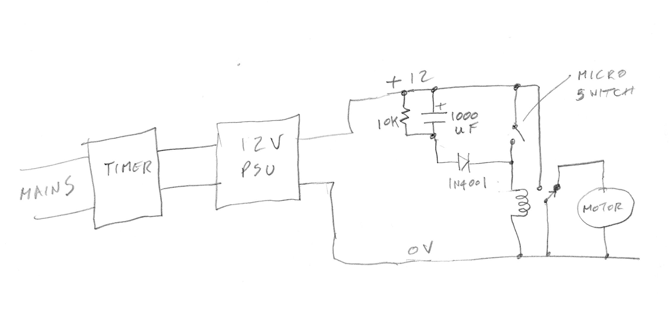

Hi John,
Here is yet another circuit.
This incorporates KISS's suggestion of providing braking to stop the motor more quickly. The value of the capacitor may need to be changed depending on the relay coil resistance and the length of pulse required to get over the notch. (I have assumed a relay coil resistance of about 700 ohms which is typical for a small relay.) One other suggestion would be to repeat the sequence twice to wash the bowl. So the timer setting would be something like this. 07:00 motor timer switches on. 07:02 motor timer switches off. 07:03 water timer switches on. 07:04 water timer switches off. (Assuming one minute to fill bowl.) 07:05 Motor timer switches on. o7:07 motor timer switches off. o7:08 water timer switches on. 07:09 water timer switches off.

Hy Les,
How would the motor ever run- a slight change to relay wiring should do the job. :)

Hi spec,
The motor is only shorted out (By the NC contact.) when the relay is de energised. The relay is pulsed on by the capacitor and diode and held on by the micro switch. If the OP new someone that could program a PIC or Atmel AVR micro the whole sequence could be programmed in. The software would not need to know the real time. It could just repeat every 24 hours. There could be a button to initially set the time of the first sequence.

Hy Les,
I understand your circuit and about the braking. But at the moment the motor would never get powered and when the relay is energized it will short the 12V supply.:)

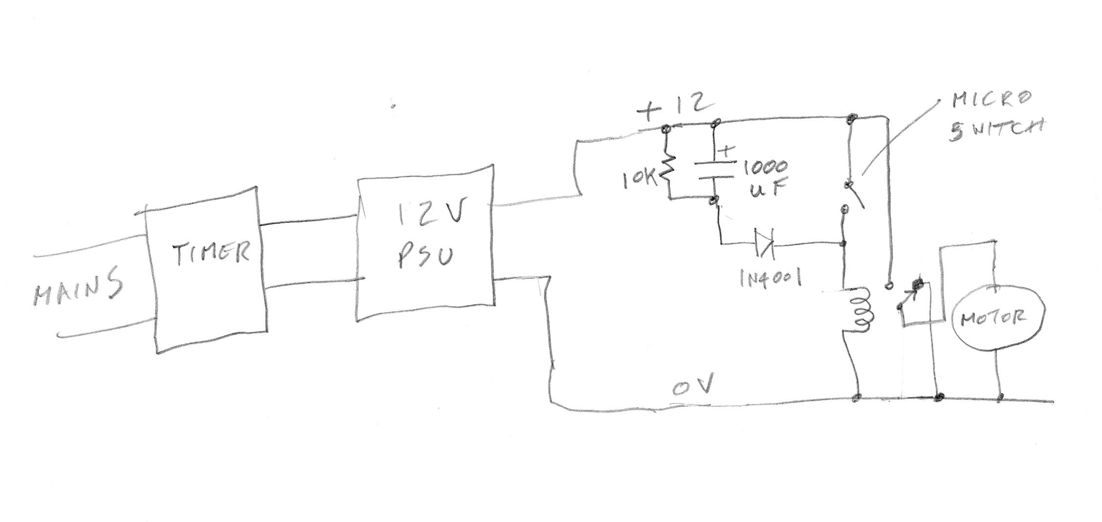

Hi spec,
You are correct. I have drawn the circuit with the common and NC connections on the relay swapped over. The common should connect to the motor and the NC to ground. I will edit the circuit. It is drawn in pencil so it will be easy. Thanks for spotting the error before John tried to build it.
This is the corrected version of the schematic.
Les.
Looks great. Ha like I would know any better :) I understand the PSU is power supply unit, but what is 10k, 1000 uf, IN4001. Sorry but as you know by now I'm illiterate to that these sorts of things but am learning quickly. I want to build it but just want to be sure I get the right stuff.

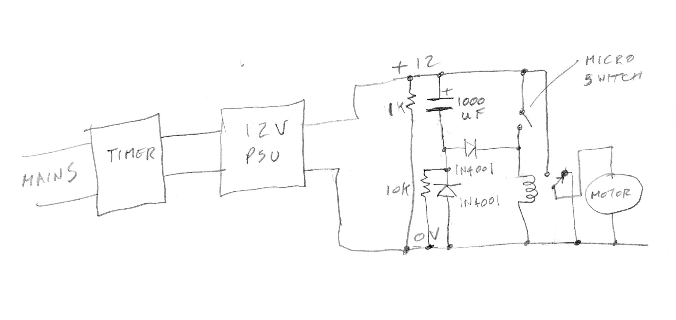

Hi John & spec,
I have just thought of another possible problem with the circuit. The problem is that the capacitor will start to be discharged as soon as the contacts on the micro switch close. It may have discharged enough by the time the full revolution has completed to hold the relay in. (Thus initiating another revolution.) I have made another change to the circuit so the capacitor is only discharged when the power is removed.
The 1K resistor across the 12 volt power supply is to discharge the capacitors in the power supply and to provide a discharge path for the 1000 uF capacitor.
