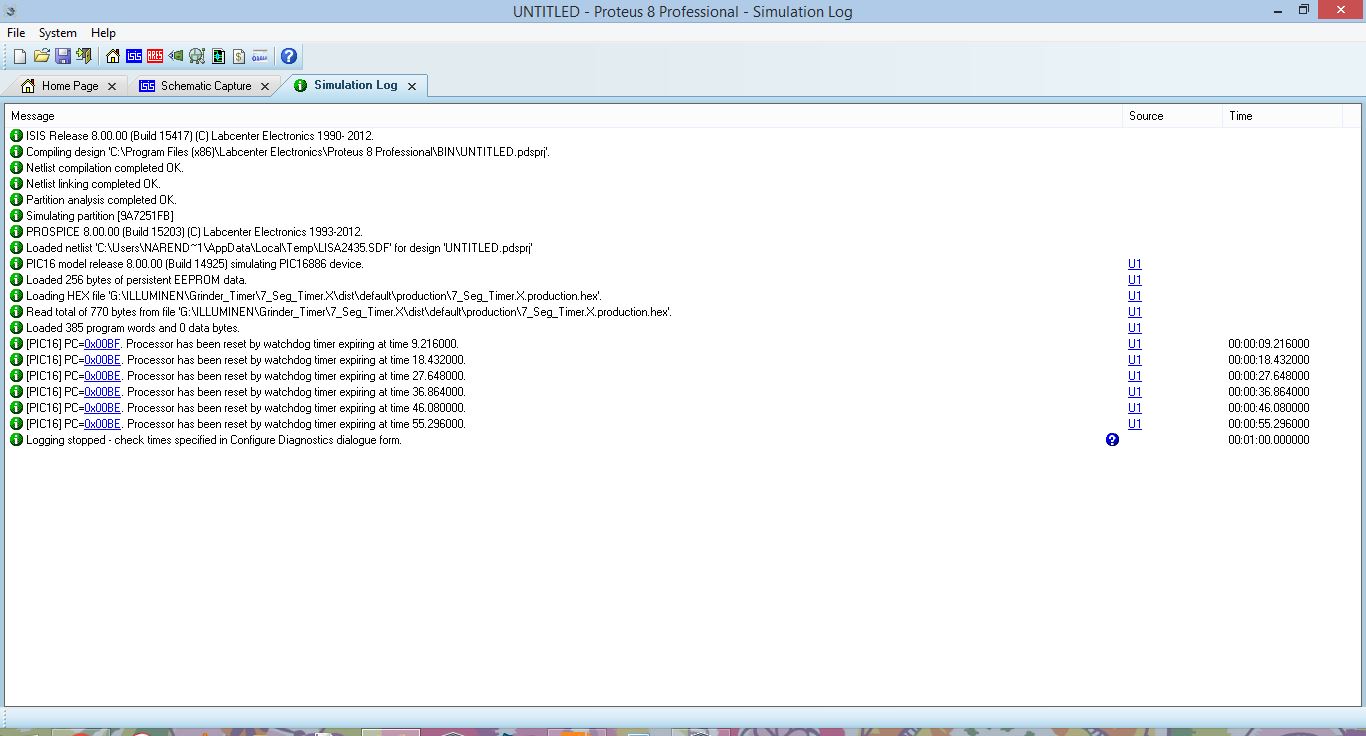

Hi guys I have a doubt with Timer 0 of PIC16F886 or moreover with Watchdog Timer ,I'm Changing the value on a 7 segment for every seconds using Timer_0
What my Problem is Watchdog is Initially Disabled in 886 , but my controller is being reset by Watch dog timer. Can anyone Point out where i have made a mistake
I have used 886 before but i haven't got this problem. thank you. I have attached C file and Proteus Error message. Thank you

You don't appear to have any config settings which is where you would disable the WDT. Either add config setting or put a clrwdt instruction in you display routine.
actually I was working before without Config Settings and it was working good, i have attached a c file which i used to increment and Decrement value on 7 segment using 886 without config register. it is working good.
And What i read from data sheet(if I'm right) , Watchdog timer is disabled initially

I dont use simulators so can't help but I do know that the wdt is setup in config registers.

Likewise, I don't use simulators (if you're doing electronics how does playing a computer game help? - particularly when it has only a passing resemblance to real life) , but in any PIC program it's absolutely essential that you set the config fuses correctly, the default settings are usually absolutely useless - and as far as I'm aware the default setting for the WDT is ON.

I love these kind of threads.... The watchdog is obviously causing your issue.... ISIS is showing you this in your first post...
