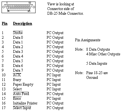

I have found this image (attached) and I have fould that the parallel port on computers can send an output to power say an LED light but the web page doesen't tell me how to connect the LED to the computer. I only have a year 10 basic knowledge of electrical circuts and need to know where the positive and negetive terminals on this port would be.
I also need to know if there is any danger (or damage that could occur) in say connecting flood light to the port. How do I change the voltage.
The last thing I need help with is a quiestion "Is the male port the ones with the pins sticking out or the ones with holes?"
Thanks guys. (This is my first post ever)

Connect the led like with a microcontroller. Connect it directly from data pinouts to ground (pin 18 - 25) via a resistor. Recommends to use 470 Ohm.

Pins 18 - 25 are ground, This is where the kathode of the led must be connected to, then any one of the dataoutputs (pins 2 - 9) should go to the anode of the led through a resistor (330 ohm or so)...
If you then make your software output to the parallel port (usually 0x378 in the cpu's IO space) the corresponding led will light
pin 2 is the LSB of the data you send, pin 9 the MSB

You'll need to do more then change the voltage, the pc's parallel port can never drive a load like a floodlight. Buffer the parallel ports output with a transistor to drive a relay, the relay would then be capable of switching the floodlight...
Yes, but you only need one data pin. For example only pin 2 from the parallel port should go to the led, and the other side of the led to ground (pin 18 ).... with a resistor in series
Each of the pins 2 - 9 represents a diffirent bit of the byte on the port. So you can run 8 diffirent leds.

The port can only supply 5V, at low current - so you would require some kind of interface, which would also need to be isolated. Probably the simplest way would be to use a driver transistor and relay, or an opto-isolater feeding a triac.
Be aware that the parallel port is fairly easily damaged, and as modern ones are part of the motherboard, you would need to replace the motherboard if you kill it!.
