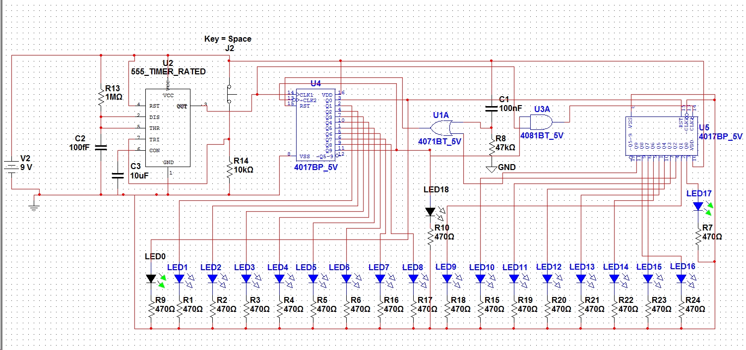

so i found that the circuit would reset if i ground out pin 6 of the 555 through the 10uf cap. i couldnt get that 18 led model to work. i have led17 and 18 in there for a visual reference ( was trying to figure out what was going on) anyway i thought i would attach the file it seems like that might be more useful since its being weird.

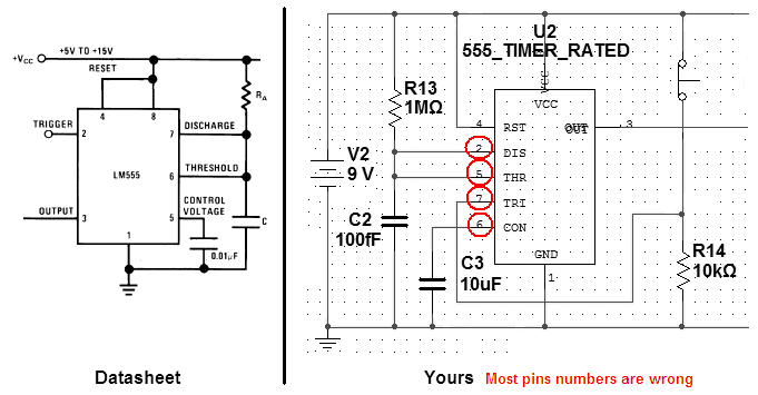

Your latest schematic has a few pin numbers wrong on the 555 timer.
hmm? i havent changed any of the pins. on the 555 i just changed the viewing options so that it displays the pin numbers

i did add the grounded pin 6 through the cap, but that seemed to fix the reset problem
i think the footprint with regards to the pin numbers is wrong in MultiSim if i plug the stuff using the pin numbers as a guide it doesnt work at all.

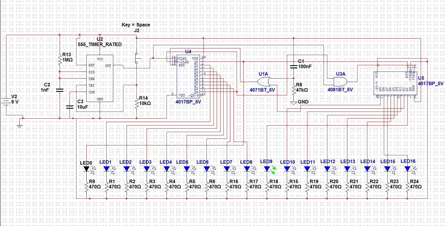

ok so i think i managed to fix it. i changed the value of C2 coming out of the 555. does this seem like a reasonable change. there is no pause when it switches from U4 to U5 now.

The value of C2 determines the amount of waiting time until you can push the button again. Before you needed to wait for about 0.1 seconds and now the waiting time is only 0.001 seconds.
Didn't you want 16 LEDs? Now you have 17. It is easy to remove the last LED and connect its output to reset the left counter.
yeah i just wanted to rule everything out before i took it back down to 16.

i ended up going with a 100pf cap on that one. everything seems solid.

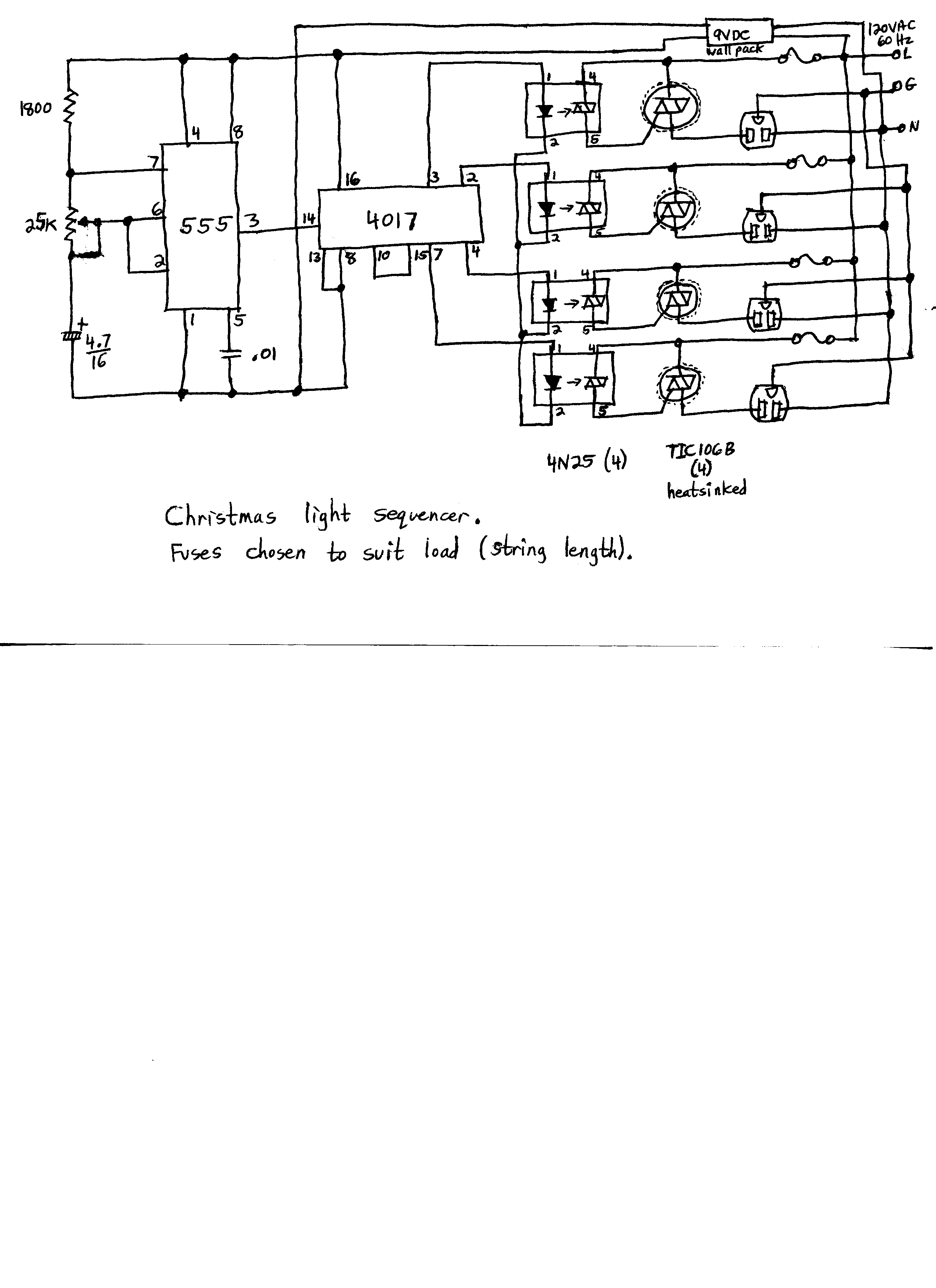

Try this circuit for an automated checker:

Don't try it before you put some current limiting resistors on those gates and LED's!
The LEDs in the opto-isolators are not connected to 0V so they won't do anything.
The typical output current of a CD4017 driving a 1.3V IR LED (in the opto-isolator) from a 9V supply is only 15mA. But the max allowed dissipation in an output transistor in the CD4017 is 100mW and here the dissipation is 7.7V x 15mA= 116mW so current-limiting resistors are needed to share the heat.
