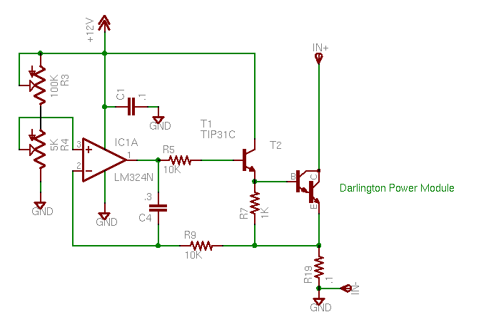

Back from the dead
Hey everyone, bringing this one back from the dead. I had to lay this project down for a while, but now I'm back at it.
I have rebuilt the whole thing to what we were talking about back in the spring. I now have two LM324 driving 6 power darlingtons.
So far I have tested it up to 10v @ 30A and it's behaving extremely well. The only issue so far is this:
Normally the whole thing draws about 50mA at 30A. If the load is turned off or disconnected while R4 is up at all the current consumption jumps to about 1A and slowly increases. The outputs of the opamps jump from about 3V to over 11V and saturate the Tip transistors. The old versions didn't do this so I was looking for reasons why this new version does and also for possible solutions.
EDIT: Or, maybe the old versions did behave like this and I never really noticed. Any way around it?
Thanks!
When you disconnect the load, the darlington becomes two diodes (b-e junctions) between the emitter of T1 and the current sense resistor (R19). T1 tries to drive R19. through these two diodes. In this attempt, the op amp must go to the positive rail in an attempt to provide the base current that T1 needs.
Determine the maximum base current that T2 needs under normal operation, and the base voltage of T1 under the same conditions. Add a resistor in series with the collector of T2 that is as large as possible while not saturating T2 (Vc>Vb by a couple of volts). Then, when the load is removed, the op amp output will still saturate, and so will T2, which should limit the current.
This may or may not be sufficient. I would need to see the entire circuit before I could say definitively whether or not it would work.
You can eleiminate T1 , R7 and direct drive T2 from the op amp. I would change R5,R9 to 1K. Take C4 out of the circuit also. It is possible to go down to 100 ohms on R5,R9 as some MOSFET circuits go this low. Thanks for your latest work.
Thanks for the replies.
Roff, I'll try adding those resistors and see how they affect things. I'm not so worried about the opamp going to a rail as its driving a pretty high impedance, but I don't have room for heatsinks for the TIP31's and under normal operation they dont need them. When they saturate obviously they dissipate a lot more heat. If they still get too warm with the collector resistors I'll figure out something for cooling them.
Power58, I'd love to drive the power modules directly from the LM324, but this condition of the load being removed makes me think I'd be blowing a lot of output stages. When load is removed base drive current of T2 goes from about 15mA to about 150mA.
Is there a reason why you connect the collector of T1 to +12V instead of to the output? That would solve your problem, I believe.
