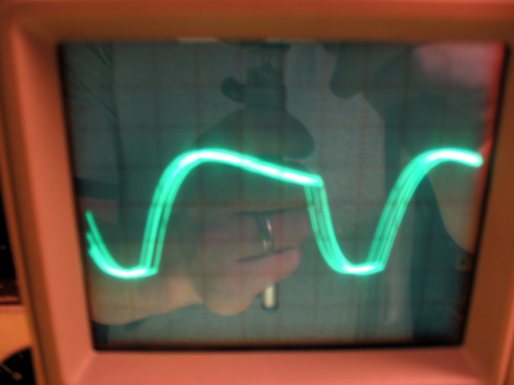

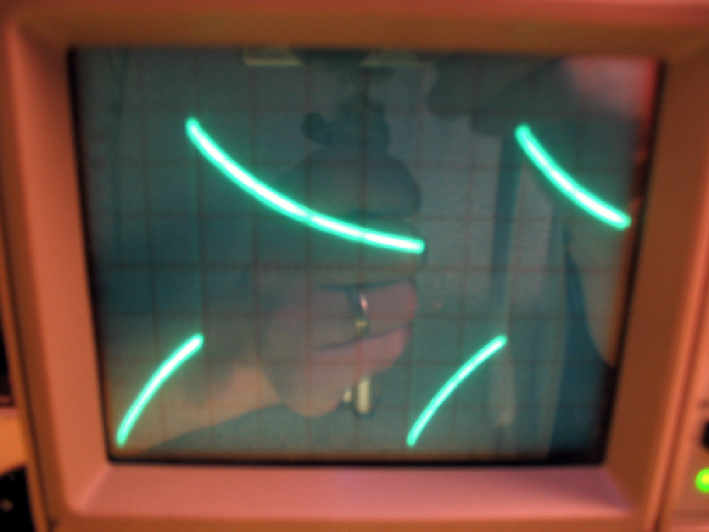

Ok, did a lot to this last night and today. Built a new psu with good regulation and better isolation from the cooling fan. Fixed reference voltage section, and replaced the 100k pot with a 1meg.
The first pic is 6Hz across the sense resistor without compensation.
The second is with .03uF compensation.
Seems like that value is a good compromise, but how far should I go with capacitance here? I found that with enough, it did exactly what a large value should do- squash and flatten the square wave.

Actually, it appears to be fine without compensation. I think the droop is due to either the input coupling capacitance, or having your scope AC-coupled.
If you want to leave in the compensation, It won't hurt anything unless you decide to make the current controlled by an external pulsed voltage source.
Well thats encouraging. I did have the scope on ac coupling. Should I try viewing it on dc?

The problem with DC is you will probably have a small pulse waveform with a large DC offset, making the response hard to see. Try raising the frequency of your test oscillator by a factor of 10 or more, and keep the scope on AC.

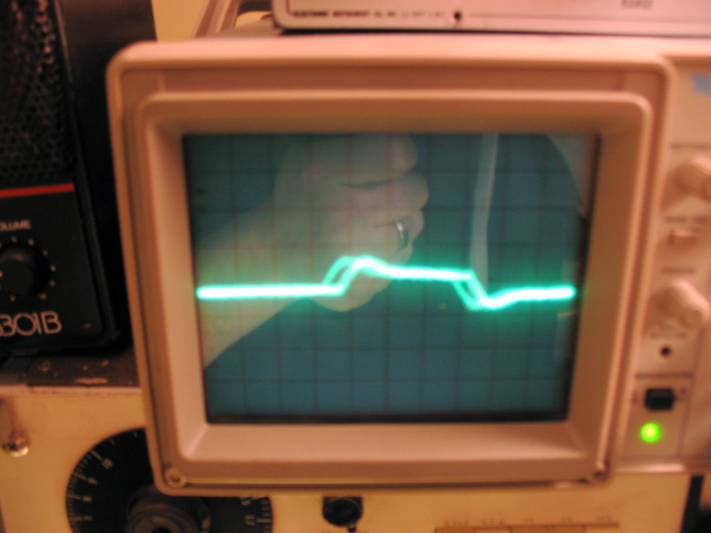

Here's another square wave shot with the power module in. I've got one more vertical range left on 1X if you need more detail.

That looks really good. I hope you mysterious problem is gone.:)
I don't see the noise bursts on this scope photo. What point were you monitoring?
Excellent. Yeah the noise bursts are really low level. They can be seen moving through the waveform but doesn't show in the fuzzy pics. It appears to be related to wiring around the power module as it changes a bit when the long runs are moved around. I'm wondering if it's from the raw 12v ac that runs from the back to front panel power switch. It runs pretty close to the module and sense resistors.

The noise probably is crosstalk, as you surmised. Could the bursts be 8.33ms apart? That would be coming from something that is powered by the mains.
