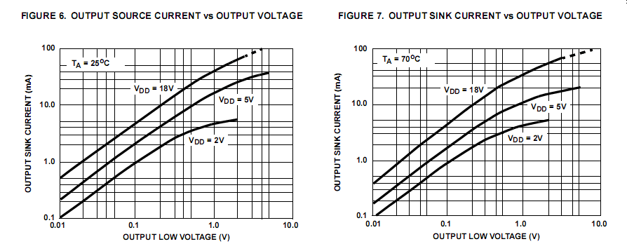

Look at these two images.
The 7555 is a CMOS version of the 555, earlier 555's were TTL.

Hi Eric,
Whose datasheet of the 7555 Cmos timer did you post?
It has an error on the output sourcing left side whene it says output sinking by mistake.
It also has the sourcing current at room temperature where its current is fairly high but its sinking current is at a high temperature where its current is fairly low.
Most Cmos 555's have a max sourcing current of only 10mA and a sinking current of 50mA to 100mA when their supply voltage is at almost max.

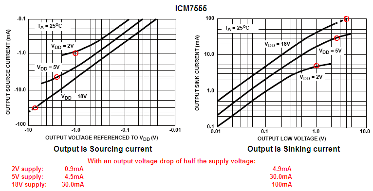

Hi Eric,
You did not post the "sourcing" graph. Here it is with a comparison of the sourcing and sinking output currents when the voltage drop is half the supply voltage:

Hi Eric,
Woops!, I'll take another look, sorry about that.!!
EDIT:
I see my errror, I enclosed the incorrect captions for the plots when I did an off screen capture.
