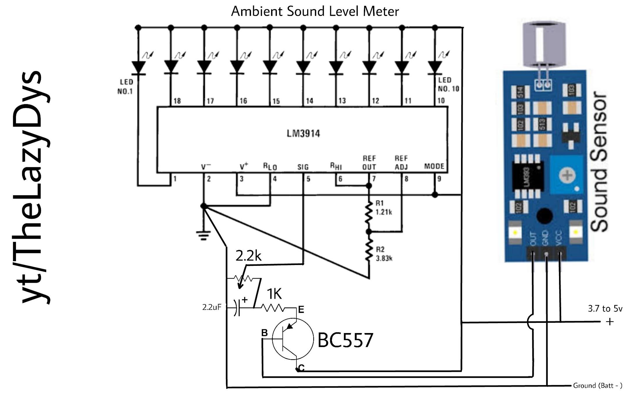

I was planning on making this schematic. Then adding the one shot circuit at the output of the last led on the string. I will send a full schematic when I get the chance. Let me know what you think.
You need to check what your sound sensor does - as has been discussed here recently it's NOT a preamp, and won't do what you were hoping. I also seem to recall that the LM3914 is wrong, it should be an LM3915 for audio.
Also your transistor is completely wrong, wrong type (PNP) and connected wrongly - no bias and 'weird' components in the emitter.

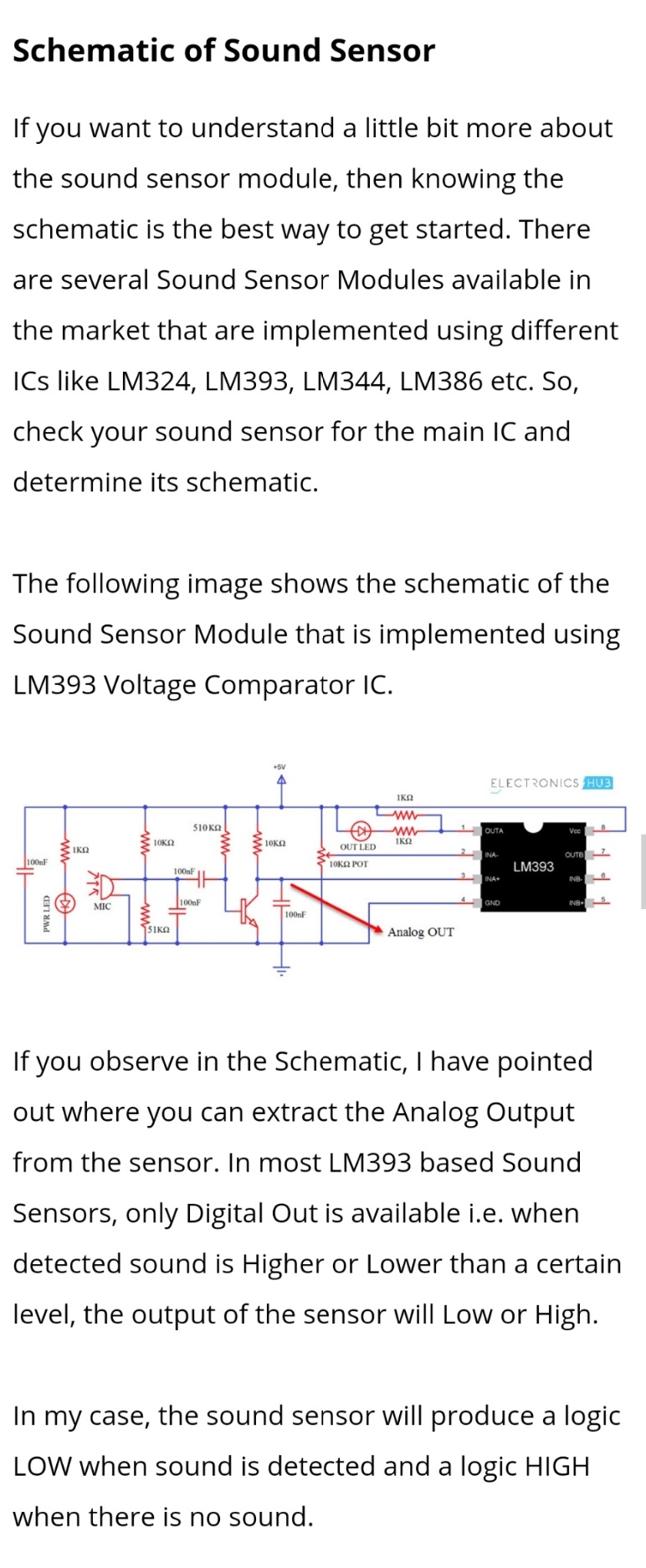

Ah yes, the infamous MrDEB sound sensor module! These come in a number of variations, but the important point is that the pot isn't a volume control – it sets the threshold level on a comparator, and the output is a digital output when the sound exceeds the set level.
This is exactly what you want here, as you don't need the LM3914 unless you want an LED indication too. The sound sensor already handles the comparison. There's a description below.

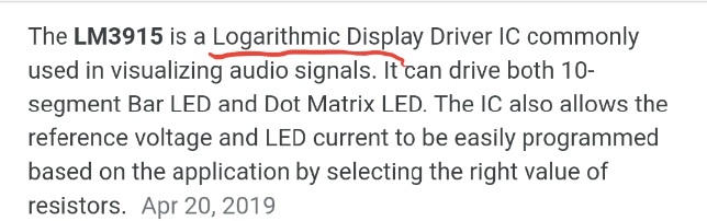

Nigel is right about the LM3914 vs LM3915 Chips. LM3914 has a linear output (i.e., the steps are equal intervals) while the LM3915 has a logarithmic output which more closely resembles how the ear reacts.

Although the LM3914 is an analog ic I have found many different schematics on audio level meters with it so I may have already purchased a few (a little to hastily.) I see the weird factor in that schematic I posted and am looking for another. I never thought that the mic module was a small preamp of sorts, but I was a little confused on the digital aspects of it. I had a few already and thought they might contribute a little to the circuit than a regular mic. I will check the board on it as the article you posted suggested and find the analog out.
I may look into a op amp from the mic to the signal of the ic for better results. I can’t remember if the lm386 was an op amp but I know I have a few of those.
There are a ton of mic preamp modules on ebay that are actual preamps. The one you show is a comparator. By itself, it will deliver 1/2 of your requirements, the part about triggering a beeper when the ambient sound is above a certain level. To get the lower-level LED indications, you have two basic options.

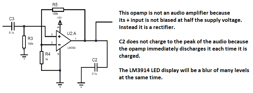

Perhaps a simple op-amp or preamplifier circuit feeding into the 3914.
The more I look at the mic module the more useless it seems.

The ebay Sound Sensor Module has a +5V or 0V digital output, to show sounds or no sounds. It shows a transistor that "might" be a preamp as shown in post #7 but the transistor has no output connection and if used as a preamp it will need a DC-blocking coupling capacitor and the display driver IC will need a resistor to 0V on its input.
The PNP transistor shown in this thread has no function and should be NPN then it is absolutely useless.
The logarithmic LM3915 is obsolete and not made anymore. Fake or defective ones are available on ebay.
The LM3914 is still made and used as a linear voltmeter that cannot show 10 audio levels, just loud or quiet.

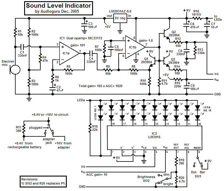

I did not find my schematic, instead I designed the circuit to do what I want. It is here:
China and India only comprise 36% of the world population. Audioguru still has nearly ⅔ of the world's population to disparage.
The note on the schematic is inaccurate. This is a half-wave rectifier with a gain of 100. If the intent is to envelope-detect the audio waveform, it needs a diode.
