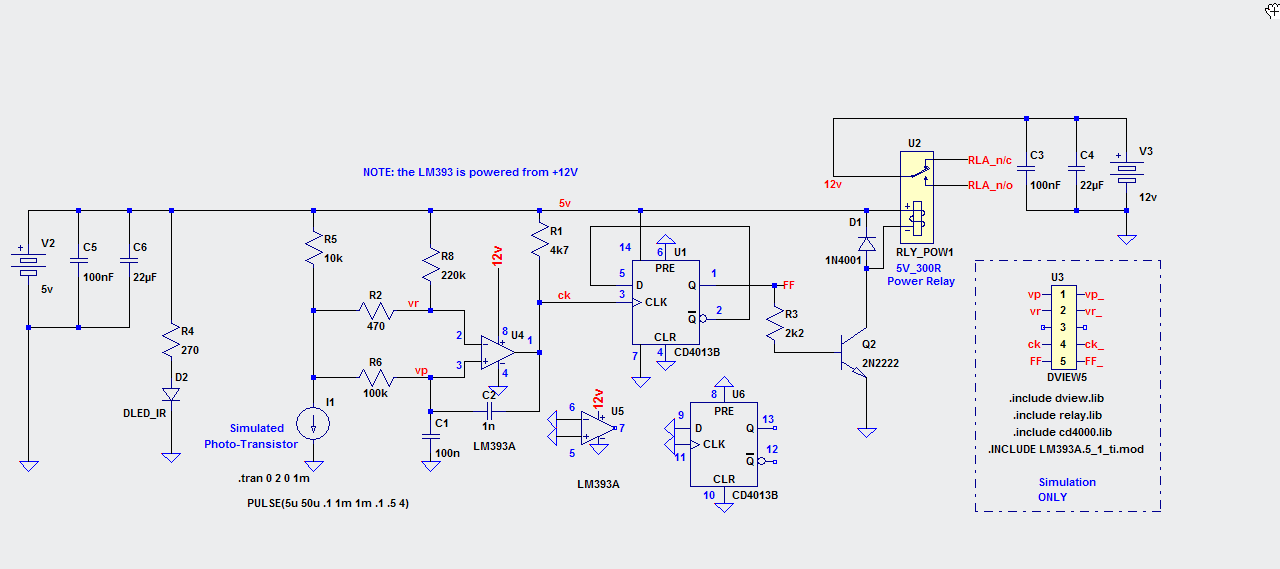

help with a toggled IR proximity sensor
thank you so much and with the cap's u just wire them in parallel as a peck detector?
I will add the decoupling caps to the circuit and repost.
I have added the caps and pin numbers.
I could not replace the circuit in that earlier post, as I cannot 'Go Advanced' from an Editing reply.:confused:
Look thru this circuit.
No changes should be required, I will recheck the circuit with these new values.
Have you made any changes to the Emitter/Detector layout, that has caused 4.5V to 4.85v difference.?
Have you checked the output of the LM393 & CD4013.???

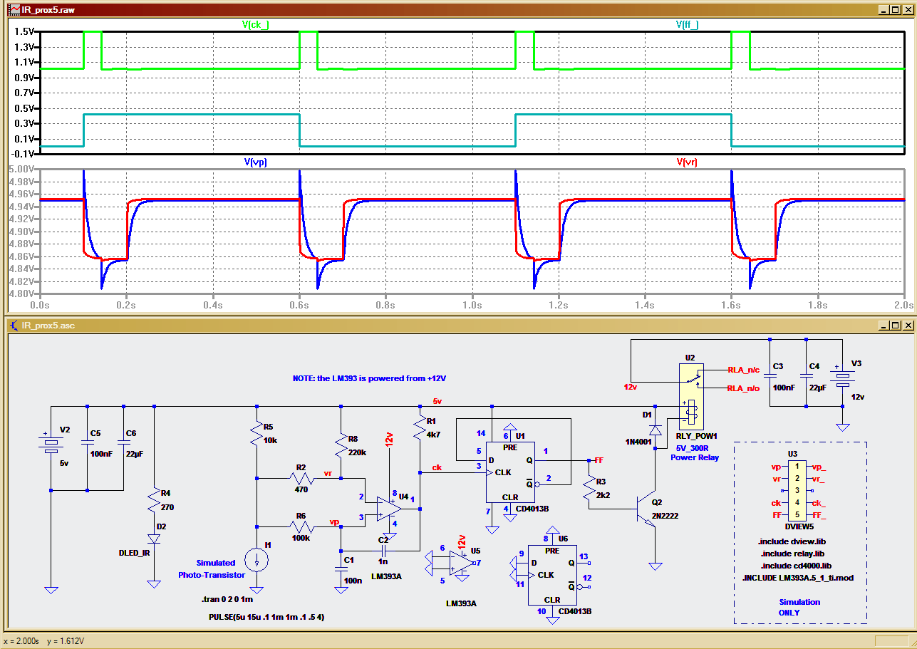

EDIT:
This is the Sim with 5V and 4.85V
nah theres no change i was just trying to get it as far away with my hand as possible with out it being to sensitive i did add a 5v reg coz i know how touchy op amps are :p
Its not a op amp configuration,:D
Its a set up as comparator.
The way the circuit is configured, it will compensate for moderate changes in ambient [back ground] lighting.
If you add a filter as someone suggested, dont use it over the emitter.
Lets know how it goes.

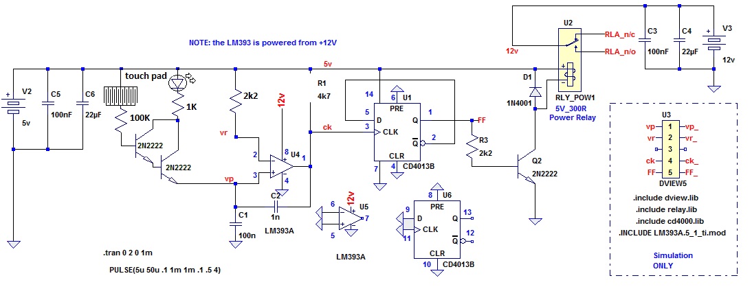

hey man all wired up and its not toggling, i got like 1.7volts at the base of the transistor and even when u make it drop below 4.5v it still doesnt toggle on and off, idk what to do for fault finding. triple checked my wiring. the "comparator :p" has 12volts at pin 1 and yeah idk what to do :s
[QUOTEhey man all wired up and its not toggling, i got like 1.7volts at the base of the transistor and even when u make it drop below 4.5v it still doesnt toggle on and off, idk what to do for fault finding. triple checked my wiring. the "comparator :p" has 12volts at pin 1 and yeah idk what to do :s ][/QUOTE]
If you have 1.7V at the Base of the transistor, it suggests that you have the transistor wired incorrectly, or the transistor is faulty.

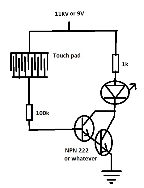

hey , i wana use your toggle circuit for something less problemy :p im not quite sure how to re arrange the comperetor but i want to keep the toggle part and replace the ir led and sensor with this.
To increase the sensitivity increase R5 [10k] try a 22K or 47K.
Not sure what this means.??
would this work?
1st e tempt :s
Note that there is a resister at R1 i didnt see i didnt put 1 back there...
