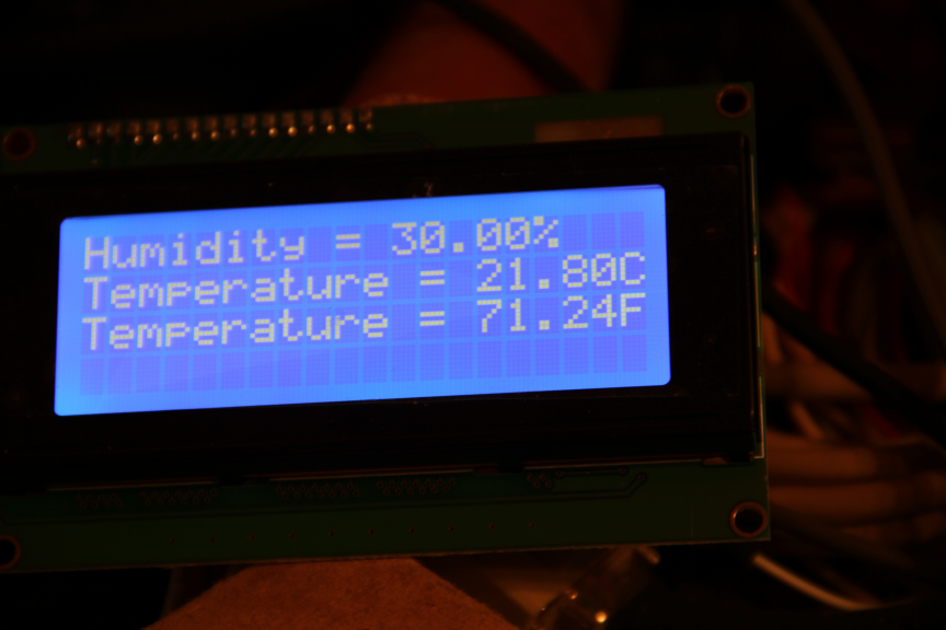

The code is the same They use serial data so very simple to simply connect and use. I used the library from <Adafruit_Sensor.h> which can be found here. I used one with a 4 X 20 LCD so it would the data The sensor also sends out dew point not that it is needed. Using a display like this you could also display if heat was On or Off and if your humidifier was On or Off. Just write your code to do whatever you want to do.
Ron
