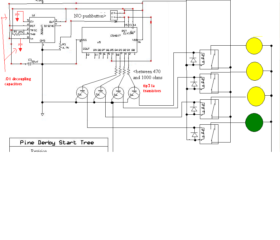

Umm im having trouble picking a transistor here, I have some TIP31A transistors here, do you think those would work?
Also those decoupling capacitors you metioned before, are those needed and if so how do they fit into the picture?
Are the resistors still going to be 750Ohm with these transistors?
The protection diodes on the relays, will 1N4001 diodes work or would you suggest others?
Thank you very much.
Yes the tip31a should work
suggest breadboarding at least one then measure current to be sure instead of making smoke with the 4017
the capacitors are nothing special.
Haha no, i'm building this because the lake that my friends and I race snowmobiles at has no power, and the arm-drop technique seems to cause too many problems. Thanks alot for your help.
My question now is where do i measure the current you were talking about in your last post?
Also will the 1N4001 diodes work by the relay coils?
Help much appriciated, thanks alot
bread board the transistor, base resistor, the relays, and the 1n4001 (I like 1n4148) all connected together.
then use an amp meter between the base resistor to 12v +
should be, according to ohms law 12volts / 750 ohms = 16ma.
need to double check the output of the 4017 on the data sheet.
the relay should close and transistor shouldn't get hot.
you can breadboard the base resistor, transistor, relay and diode now without the 4017.
If you have the 555 then wire it up and temp connect to base resistor (if the transistor/relay circuit works as planed and right amount of current.
building in blocks makes debugging much easier.
