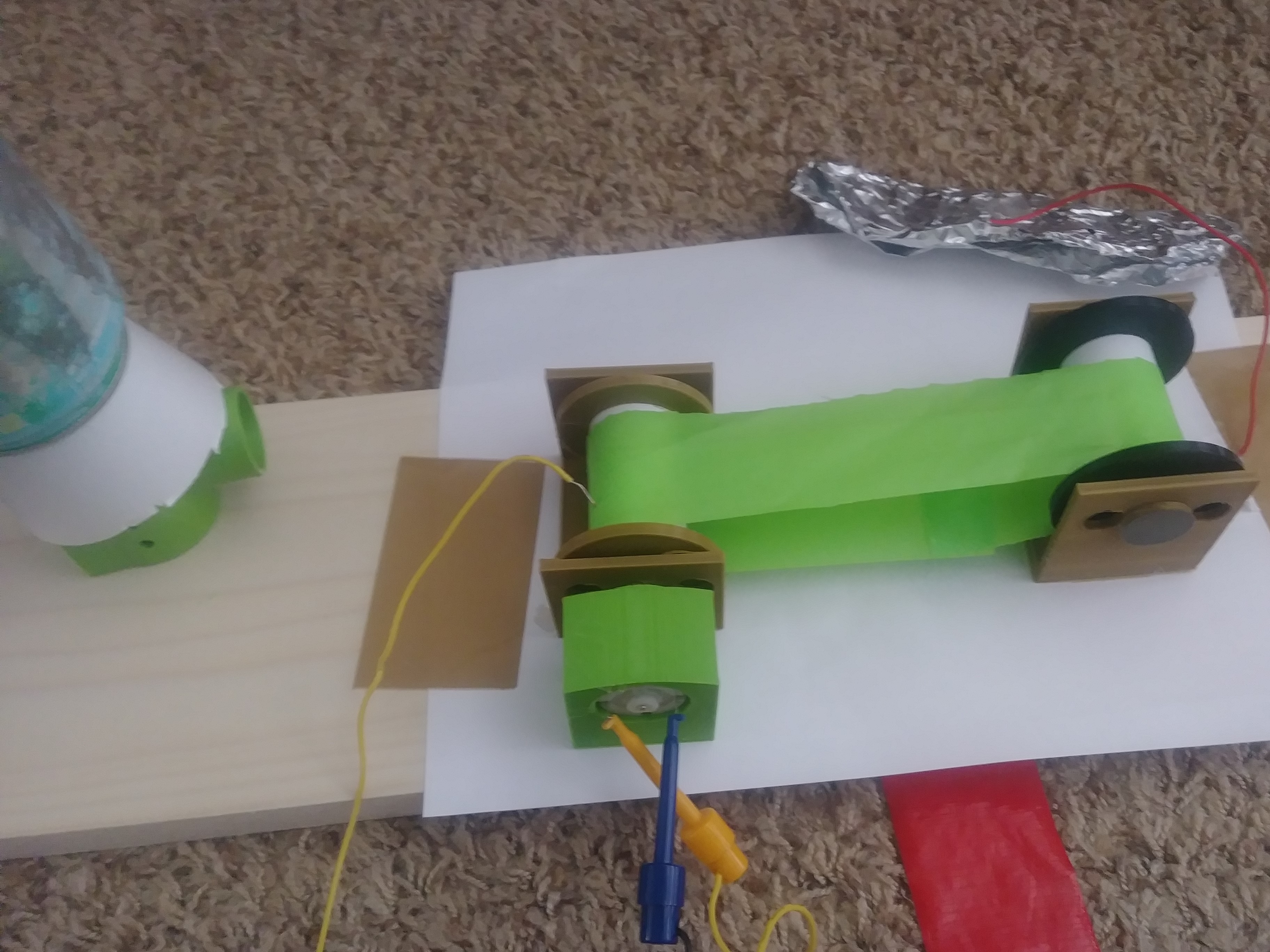

I'm trying to work on a project for a science exhibition at school. I want to make a van de graaff generator using 3D printed parts for the base. I'm just trying to get a working version, but I'm having some troubles.
Build:
There are a bunch of different ways to make it, but I'm basing it loosely on this
He uses an elastic band and PVC pipes, which is what I'm doing. I made rollers and cut the band into shape. I attached a small motor to one roller, and have ground and charging wires. I'm using an empty soda can for the collector of charges, and I was told the ground could be something simple like an aluminum foil or metal bar.
Problem:
In all the videos, it only takes a few cranks before there is enough charge to get strips of paper to move away from each other, and large sparks can fly out if you hold your finger close to the metal ball. In my device, I'm lucky to get even a small spark, and not consistently.
Clarifications:
-There is good connection between the wires and their endpoints (ground or the soda can)
-We live in a desert, so humidity isn't an issue
-When the ground and charging wire were hooked to a capacitor with a voltmeter, the voltmeter showed that there was a slight charge being built up, but it took ~10 seconds of running to motor to get to 3 volts. It also bled out fairly quickly.
I've attached an image (final will be 100% 3D printed but this is a placeholder). Please let me know what could be wrong.

It is difficult to be specific with just a small picture to look at, but consider the following:
1 Some of your materials may not be very good insulators.
2 What are the rollers made from in your model?
3 do you have a "comb" of charge collectors at each end of the belt or just a single wire?
4 When you use the voltmeter and capacitor, the voltmeter has resistance which will leak away the charge.
The average digital voltmeter will have a resistance of 10meg ohm. This is OK for most purposes, but for a Van de Graff generator it is a very low resistance.
5 You seem to be keen on 3D printing parts of your final product. Do check the suitability of the 3D print material for use at high voltage, it may be "leaky".

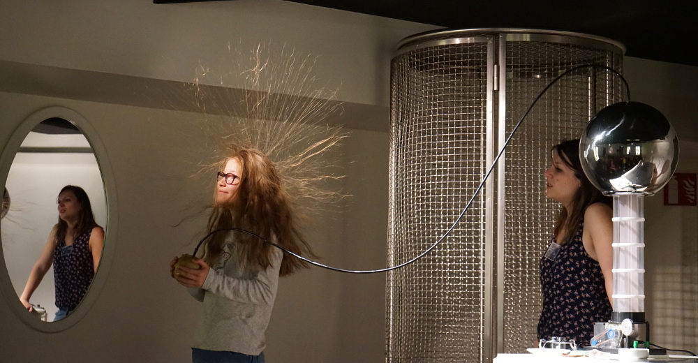

Finally, a real Van de Graff generator demonstration, at the Electrical Museum in Mulhouse, France.

1/2. I'm using PLA from my dad's collection. Google says it is a strong insulator at room temp. Other materials are wood (for base), pvc rollers, elastic from a theraband, and styrofoam (which is a placeholder).
3. I didn't have a dedicated comb but one iteration of the device had wire bundles that I spread out to make a comb like structure. I changed it to regular wires so I could do testing with capacitors.
4. The capacitor experiment was there to make sure that something was working. While a voltage is being built up, it's pretty low and slow.
5. The materials are thermoplastics, so they should be super high resistance. Google says PLA is an insulator up to 70C.
I could take more pictures if you wanted, just let me know what you would like to see.

What kind of capacitors are you using. They may be (probably are) leaking.
What do you have for the upper terminal?
The top collector dome or sphere is absolutely critical in a Van de Graaff machine.
It should not have any sharp edges anywhere and it should ideally be curved or rolled inward at the underside opening for the best possible results.

Is your top roller and bottom roller the same material? They need to be made of different materials. Van De Graff's work by something called the "triboelectric effect" https://en.wikipedia.org/wiki/Triboelectric_effect The most effective generators have the rollers for the band made from materials that are as far apart in the triboelectric series as possible.

I'm using a soda can that I sanded down. The surface is conductive, and there are no major sharp edges that I can see. I used it because it's simple and other projects recommend it. I would like to use something better, but is there a good option for $20?
The machine arrangement must be vertical for it to work properly, with the upper sphere supported from the inside, so nothing allows charge to leak from the outside - and the upper roller & collector comb must both be inside the upper terminal.
Could it absolutely not work if it was horizontal? I thought the main issue was that the belt carries the charge.
I based the current version off of the video I linked in my OP, which seems to use PVC for both rollers. I tried to have one roller 3D printed, but that wasn't working as well (probably since I'm not too good with CAD yet :p)

Anyway, thanks for the feedback folks. Some of the issues seem to be the top roller isn't inside the collector, the collector is a coke can (but it seems to work for others), and I need to switch up at least one roller.
Another design uses a glass fuse and a rubber band. Do you guys think that might be more fruitful?

The further away your materials are for the "bottom roller" and the belt on the triboelectric series the greater the charge you can develop. The top roller can be metal.
I have used two nylon bed rollers for the top and bottom roller with decent success... The bottom roller was coated with Teflon tape (Not plumbers tape, actual Teflon adhesive tape). The top roller was aluminum adhesive tape. For the belt I used a roll of transparency film (Acetate) I got at Hobby Lobby and had to cut it down to 2 inches wide. Since the transparency film is rigid and does not flex like a rubber belt, the top roller was essentially a spring loaded idler pulley. I chose the transparency film as a belt material for something that would be more durable than a rubber belt. The van de graaff generator was powered with a sewing machine motor on a speed controller.
For combs, you need one at the top connected to the sphere and one at the bottom connected to ground... it is important that the comb does not touch the belt or roller. (an 8th to 16th of an inch gap is sufficient )

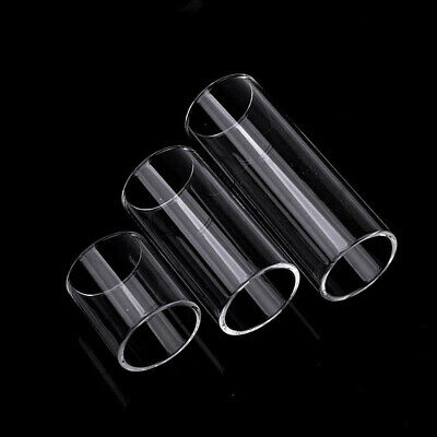

For readily-available materials, can you try glass (eg. the fuse tube) for the top and keeping PVC for the bottom?
If you want a larger glass tube, look at guitar bottleneck slides on ebay - they are cheap and a good size for a roller, if you add something inside for bearing supports.

Going back to the hair picture in post #2, we did similar in physics at school - the teacher stood a (long haired) pupil on a wooden stool (must have been a girl?, as there were very strict hair requirements at my Grammar school) and ran a wire to the Van De Graff generator.
Just as in the picture her hair obviously ballooned out nicely, and the teacher (a really nice guy called Mr. Gregory) was walking about talking and gesticulating, waving his arms about.
Unfortunately he got a little 'too close', and as he waved his arm up a huge spark jumped from the girls nose across to his finger, knocking him to the floor and sending the girl flying off the chair - pretty dangerous for her, but she wasn't injured. No idea now what the girls name was, but I remember the incident as if it was yesterday - needless to say, we all found it extremely amusing :D
