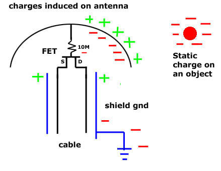

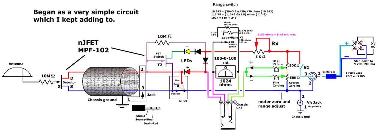

Please post a schematic and a photograph if you can - it's difficult to tell form a verbal description.
A schematic has been posted and here are more explanations.

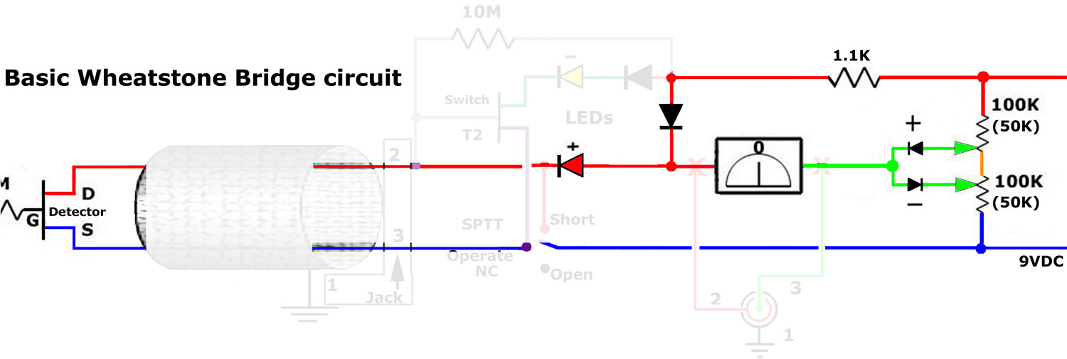

I don't know if there is any filtering on the power supply, but it does not matter. The heart of the unit is a Wheatstone Bridge. As long as there is enough voltage and current, it matters little if the voltage varies. Also, the bridge automatically filters out any common mode interference such as ripple. The bridge consists of the two 50K pots, the 5K pot set for 1100 ohms, and the detector JFET. The bridge has a "positive" voltage drop across the meter terminals when the detector FET has a positive charge on the gate and is conducting. The bridge has a "negative" voltage drop when the FET gate has a negative charge and is turned off. That's when the other FET and LED conduct.
One jack is a chassis ground. Another (Vfc) has a neon tube connected between the circuit (which floats) and the chassis. If lightning is extremely close, the detector FET will be burned out and the high voltage on the antenna can come in through the drain and source wires in the cable and could charge the circuit. At 70 volts, the neon tube will conduct and short the circuit to ground. If I see it light up, it means get out of there fast. Other jacks are for the antenna cable and to plug in a DVM.
I put in a switch that would connect, open or short the detector FET because I didn't know if I would need to zero the unit with the FET in the circuit or not. I also tried to connect a dummy load to try and equalize the zero points with and without the FET in the circuit, but that just made things worse for some reason. As it is, I just zero it with the FET in the circuit. These are not a problem.
The problem is that I'm getting an output on the meter that is the opposite of what I expected. I bring a negatively charged piece of plastic near the antenna and I get a voltage drop indicating a positive gate voltage when the same circuit had turned the red LED off and the yellow LED on when in the breadboard stage which indicates a negative gate voltage. The gate is good to 25 volts. Gate current is 10 mA, reverse current is 2 uA. Drain-source current is about 6.6mA now. The most voltage I've measured on the gate (with this circuit) has been 0.1 volts during fair weather. I have not had any thunderstorms here yet to test it with.

I added a schematic with the Wheatstone bridge sections highlighted.

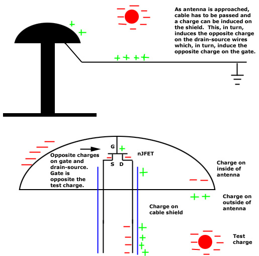

This series of events can account for the meter responses I've seen and it seems possible, though I don't know how probable it is...
As the antenna is approached with the test charged object, the cable betwen antenna and house is passed. At times I'm closer to the cable than the antenna.
A positive charge can be induced on a section of cable shield.
The charged shield would, in turn, induce negative charges on the drain-source wires within.
If the drain and source are negative, they can induce a positive charge on the gate.
Parts of the antenna are positively and negatively charged and these charges do not conflict with the charges coming from the shield.
The result is that when the negative test charge is brought close, the gate ends up positive relative to the drain-source.
When detecting atmospheric charges, this does not happen because the cable and antenna are at equal distances and the antenna is much larger so its charge dominates any charges from the cable.
See attached diagram.

With electrostatic induction, the approaching charge attracts the opposite charges to it and repels like charges. If the like charges have a path to leave the bowl (or whatever), they will, leaving the opposite charges on the bowl. If the approaching charge touches the bowl, then it transfers charge directly, not through induction and the charges will be the same. I know articles say the charge on the bowl is the same polarity as the electric field it is exposed to, but this is opposite how induction really works so I think they are just simplifying things. I have broken it down to show where al the charges go.
