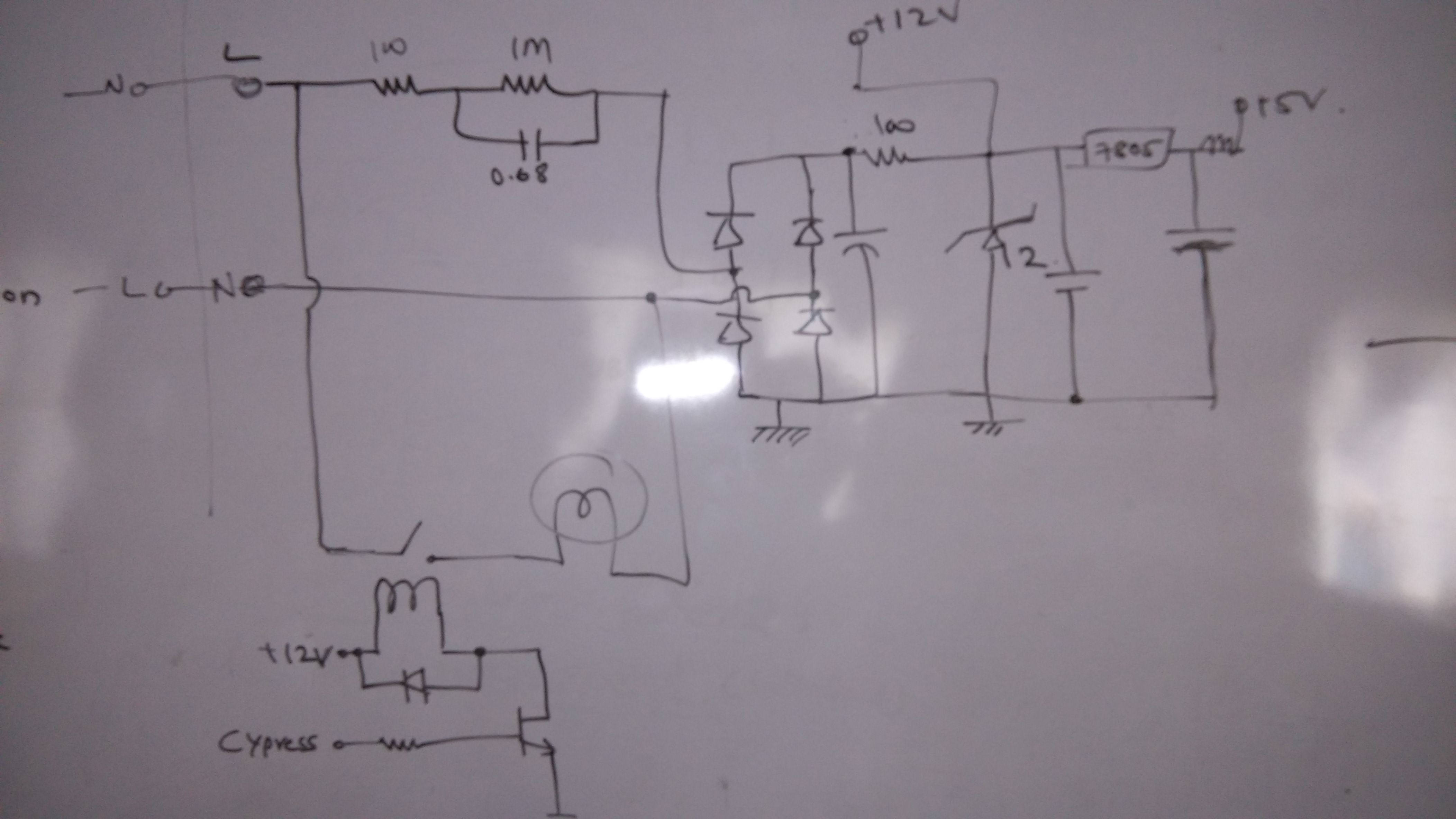

In my current project , i am building a proxy sensor using a CY8CMBR3102
The power for this circuit is a capacitive un-isolated standard circuit.There's a +12v for a relay and there's a +5v for the CY8CMBR3102 and a small Microcontroller.
The proxy sensor is a single layer square sized board creating a capacitance of 12pf.
The general principle of the cypress device is of measuring the capacitance of the sensor, which increases when a finger or a hand or metal is brought near it. It triggers a relay through a transistor and toggles it on the next proxy event.
The problem arises when the Line and Neutral are reversed at the board.
The CY8CMBR3102 thinks there's dynamic capacitance variation at the sensor , and starts auto toggling the relay.
I am unable to draw any sane conclusion from the phenomenon.
Can someone throw some light?

I definitely know how to ask a favor, and have been doing that for many years. Wherever necessary I have provided my schematics, codes and whatever information required to explain my case.
This time though I felt that most will understand when I say "Capacitive" un-isolated power supply.
Here's one attached which I have used.Although it's a photograph of the one I drew on a white board , so please forgive me for not providing a Cad sch.
Secondly , the un-isolated board is going to be fixed in a wall,then there's an overlay ,which is isolated. After which there will be another granite tile over all this assembly. In no way is it electrically available to any user. The proxy sensing will happen at a distance of 10 cm. Even if the tile is touched, it is fully isolated.
Thirdly, the electronic switch used is an electromagnetic relay. So the lamps or any mains operated device is switched through this relay contact.

As you are asking for help we have to assume that your level of knowledge on the subject is fairly low. You could have used a half wave rectification system which would have changed the explanation slightly. You could also have made errors in the design of the circuit.
Here is my explanation of the problem.
Neutral will be connected to earth at some point. (Probably in the sub station.)
We will assume the mains voltage is 240 volts RMS ( 340 volts peak or 680 volts peak to peak.)
Situation 1 Neutral connected directly to the bridge rectifier.
When live is on the positive half cycle with respect to neutral the DC - output will be at about + 0.7 volts with respect
to neutral.
When live is on the negative half cycle with respect to neutral the DC - output will be at about - 12 volts plus the volts drop across the 100 ohm resistor. If we assume this voltage drop is 5 volts then it will be at - 17 volts with respect to neutral.
So the negative DC output line is an AC waveform with an peak to peak amplitude of about 17.7 volts. (It will not be a sine wave.) The sensor will see this via the capacitance between the finger and the sensor. I believe this to be the situation were the unit works.
Situation 2 Live connected directly to the bridge rectifier.
When live is on the positive half cycle with respect to neutral the DC - output will be at about + 340 - about 17 volts (+ 323 volts) with respect to neutral.
When live is on the negative half cycle with respect to neutral the DC - output will be at about - 340 - 0.7 volts (- 339.3) volts) with respect to neutral.
So the negative DC output line is an AC waveform with an peak to peak amplitude of about 662.3 volts. (It will be a distorted sine wave.) The sensor will see this via the capacitance between the finger and the sensor. I believe this to be the situation were the unit does not work.

Your schematic shows a 'ground'. Is that a true earth ground, or merely a common point not actually galvanically connected to true earth ground?
So, as Les has stated: The sensor needs to sit on (or close to ) ground. It can not function when sitting on a AC power line. The bridge needs to connect to the power line wire with the least noise on it. I don't see a low cost way around that.
1) use a DPDT relay to reverse the power line wires. It requires more current if that relay needs to be on. I have seen latching relays used in transformerless projects like this.
2) There might be a way to use a simple relay and two high voltage caps to do the same thing. Don't have time to think now.
I would use a LM78L05.
The schematic appears to indicate Chassis ground not Earth ground.?
