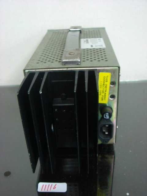

Hi thanks for replying these are the photos

It looks like there is nothing on the rear panel of use. Not sure what the two holes are labeled.

You will need an IEC plug in line cord for the power in in the back.
