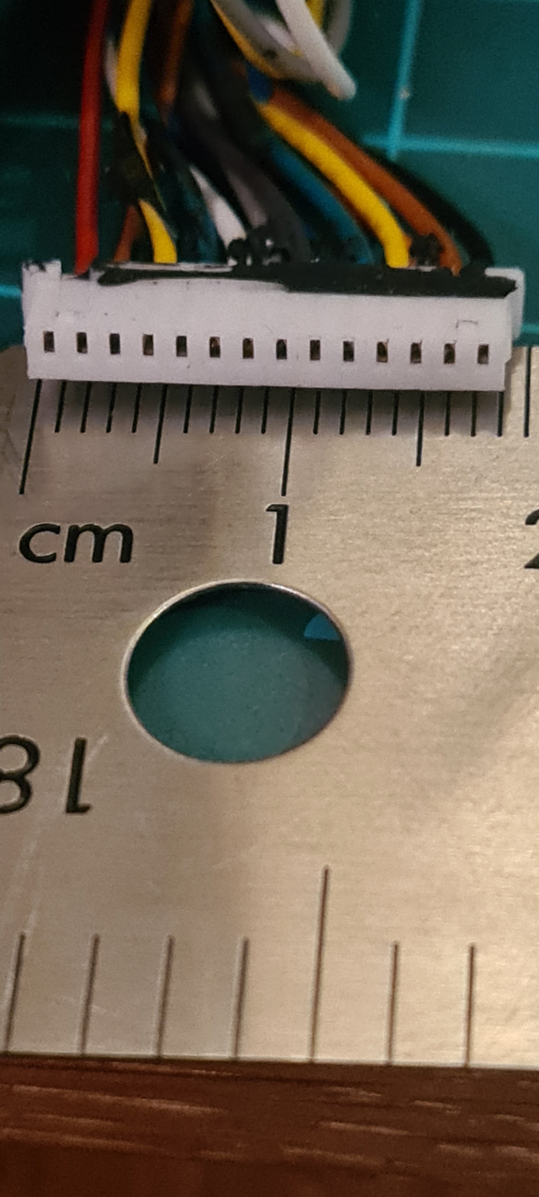

Hi Guys.
Can anyone help to identify this connector and advise of places to purchase along with the board connector to match
I've been looking around and I think its a JST connector but I'm getting confused with the different pitch sizes.
Thanks in advance
Simon

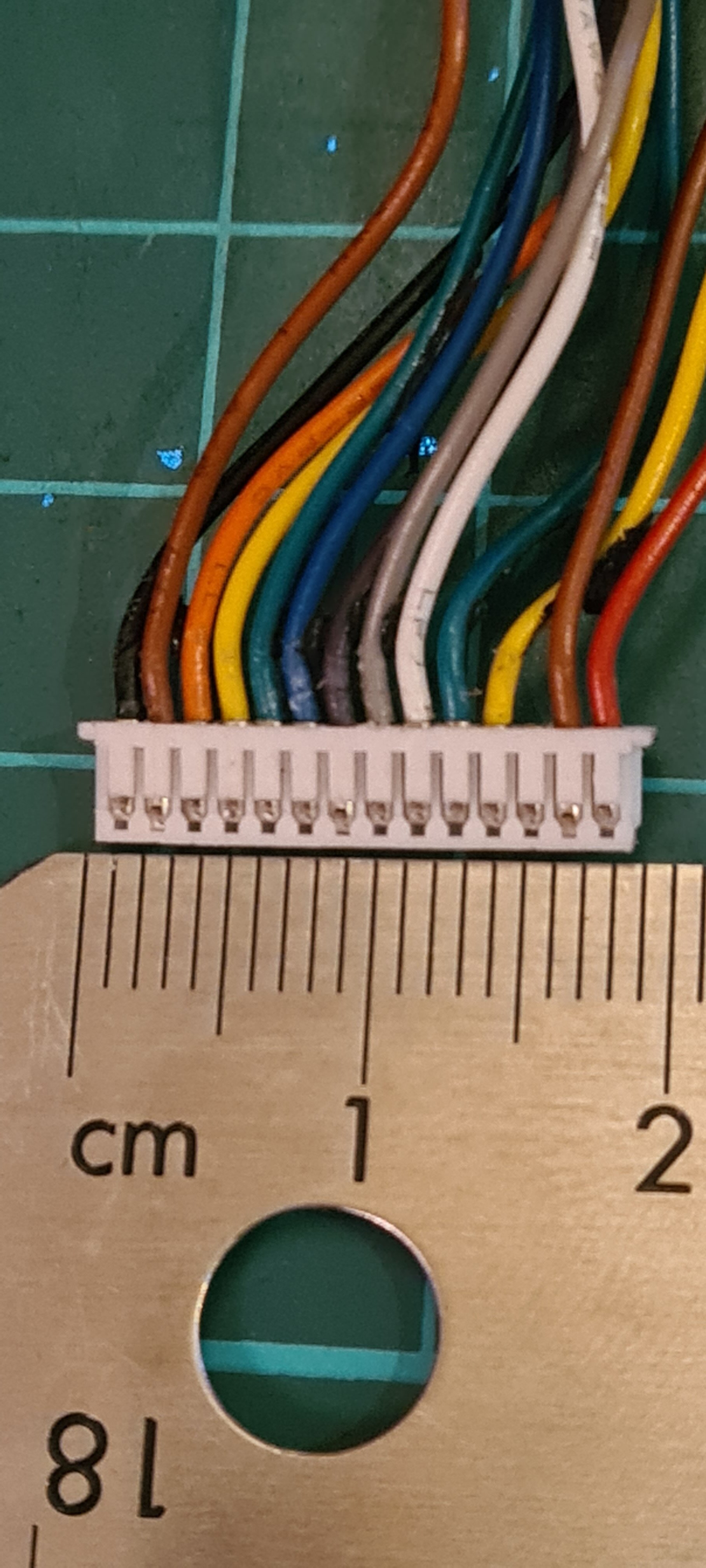

What does the bottom side of the connector look like?
It looks to me like a .05" spacing.
from the left side of the first pin, count 11 pins over to find a mm marker in the exact same position under the pin. That's 14mm away.
14mm/11 pins = 1.27mm = 0.05"
if spacing is 1.25mm, 14mm would be 11.2 pin positions and easily noticeable.

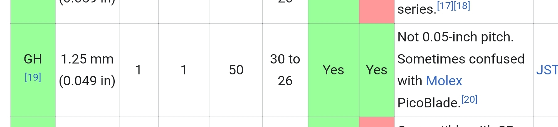

It looks like I have now found it and it matches perfectly to the molex picoblade connector.
I got hung up on jst connectors for hours of searching but the note saying the GH is often confused with the picoblade was the key.
Many thanks
Simon
That's exactly why I posted the screenshot. Matching up pictures of the likely choices would narrow it down pretty quickly. Good job Wikipedia!
