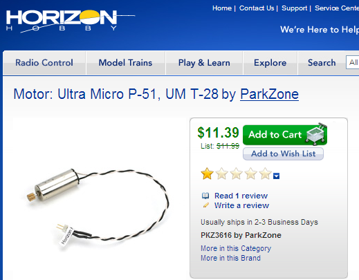

This motor has 1.5 times the power of the smaller motor I talked about. It is 8mm in diameter and is 19mm long.

The small motor in my helicopter blows the papers off a nearby table. A vacuum cleaner using it with a good blower will be able to suck dust and crumbs, not gravel.
